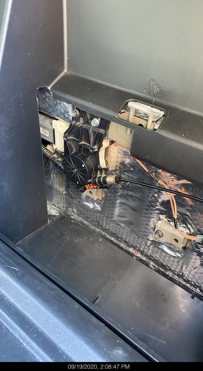

    I don't have any more detail shots of that area, sorry. Those plugs I believe are open directly through to the top of the rear cab mounts.
    You should be able to run wiring through without taking the cross member off, there's plenty of room to snake through on the inside - you would just have to see if there's room underneath. You'd need to find a way to waterproof whatever opening you made, of course.
    Additionally, there are two small sections on either end of the cross member (unpainted bright steel) right over those plugs that are easily removable with one hex head.

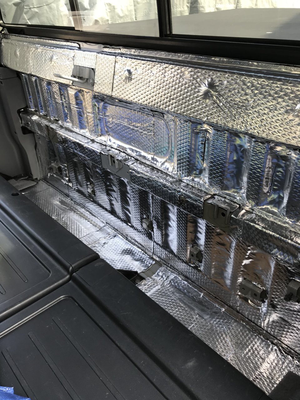

    I did my back wall and doors and parts of the floors with that same stuff but never seen the mlv stuff. It definitely helps with noise and it makes my rear windows mod quieter and you gotta love the thud sound when you close the doors it sounds like well build like cars from the 60’s-70’s67FAAE53-B55B-4448-A6DB-DEEB22A59C85.jpg151EC682-656B-4024-911B-29B48ABD3254.jpg
