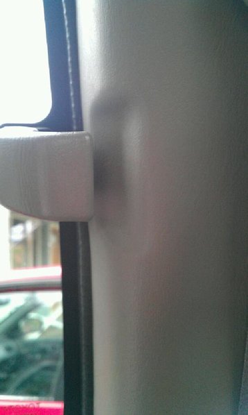

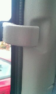

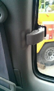

    I can't get my passenger side quarter window to shut tight, the latch won't go past the point where you can just push it out. On my driver side it will actually make a reassuring noise when clamping it and will fit snug against the frame. I took some pictures, the plastic piece isn't broken. Nothing is loose. Any ideas? Could the plastic wishbone piece be the issue even though its not broken? :confused:
    Pictures 1, 2, & 4 are the passenger latch
    Picture 3 is the driver latch that is closing properly.
    After constructing a aluminum wishbone and destroying 2 pins and finding out the parts & service department is always closed at toyota. I put the plastic wishbone back in and it worked... two uses after to show someone it worked now.. it exploded.. problem solved. -_-
