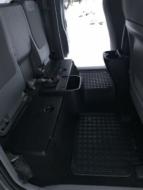

    Pic 1: Showing the rear seat area of my 2015 access cab before the mod.

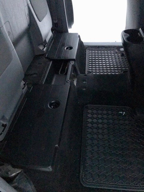

    Pic 2: Showing rear seats removed.
    Pic 3: Showing the rear console and seat belt buckles removed.

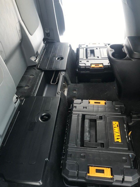

    Pic 4: Showing the two Dewalt TSTAK II storage cases; model # DWST17807. (Note: These are the same height as the factory underseat storage consoles)

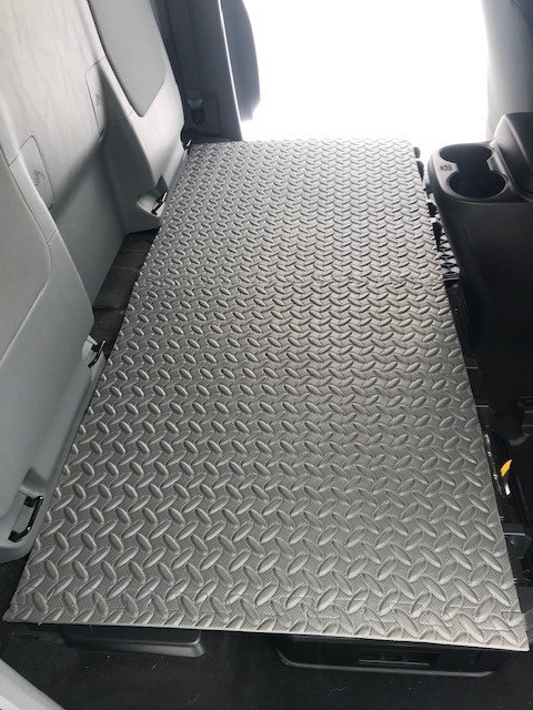

    Pic 5: Placing ordinary workout-mat foam, about 1/4" thick, cut to 22" x 51" on top of the factory consoles and Dewalt storage cases to prevent the plywood from rattling against the plastic. Note: This is NOT diamond plated aluminum (I've been asked this several times). It's just the textured, bottom side of the foam.

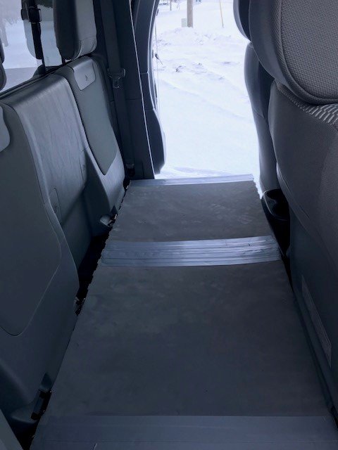

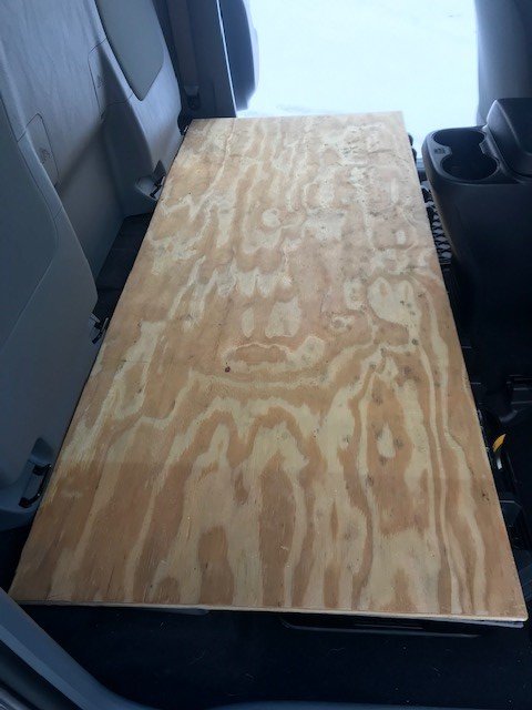

    Pic 6: Laying a piece of 3/8" plywood cut to 22" x 51". To prevent any chance of slivers, the edges were sanded. After measuring and remeasuring I found that these dimensions allow the plywood to fit snugly between the rear wall of the truck, the back of the front center console and the doors (without rubbing on the door plastic).
    Pic 7: Laying a second piece of foam cut to the same dimensions as the first on top of the plywood. I did this to provide extra cushion AND to extend the life of the dog bed I had made.

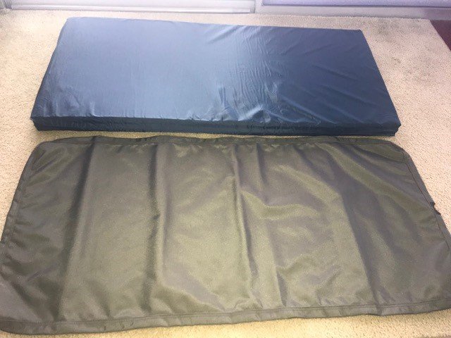

    Pic 8: Showing the inside foam bedding and the Cordura outer cover of the dog bed I had made by Gorilla Dog Beds (gorilladogbeds.com). This bed is made of high quality, 2.5" memory foam enclosed in a removable waterproof barrier (the blue material), that is ultimately covered by a thick, bombproof, removable, washable outer Cordura cover.

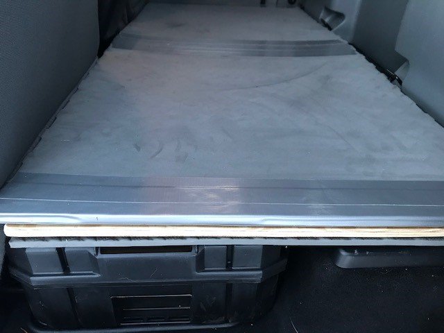

    Pic 9: Side view showing the Dewalt cases, and the foam/plywood/foam "sandwich".

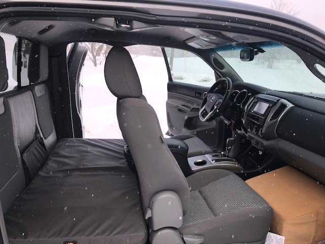

    Pic 10:The end result.
    A few things I like about this set up: It can be completely removed and reinstalled in about a minute making it less tedious to do a thorough vacuum job. It's quiet, no rattling. The Dewalt storage cases and the factory storage consoles are easy to access because all of the materials used in the build are lightweight. The dog mattress itself is removable and could be used in the bed of the truck or a tent as a waterproof sleeping pad. The outer Cordura shell is washable when (not if) it gets dirty. This set up allows the front seats to still be 80 percent reclined to fully reclined depending on where you position the front seats.

    Leveling with the tool boxes is a great idea, instead of loosing storage space you gain it. The flat base looks really useful even when you don't have Ranger with you. If I didn't already have my labs set up in the canopy, I'd do this.

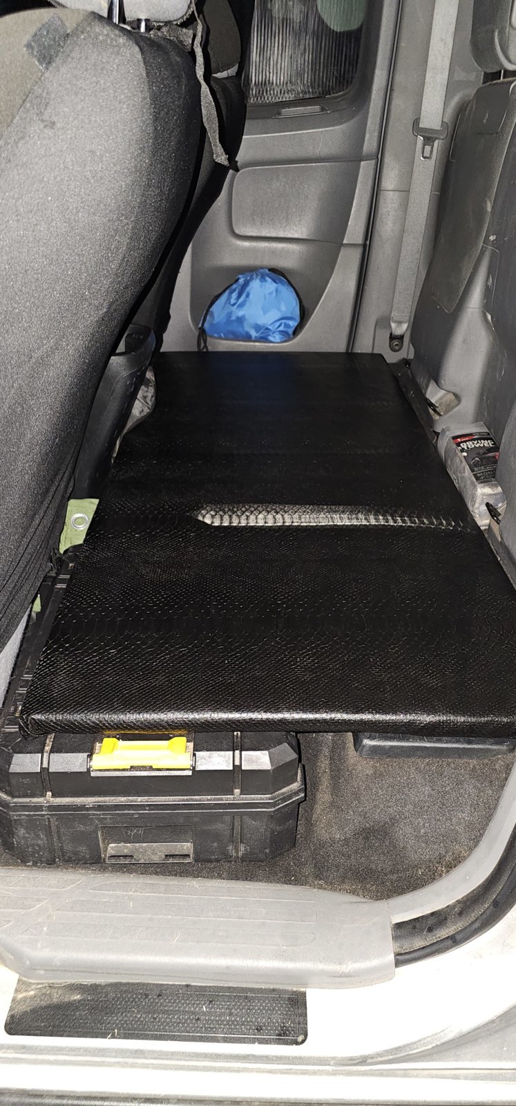

    I was looking for tips & inspiration and y'all did not disappoint!
    1. The DeWalt boxes fit perfect! Great to have that extra storage space.
    2. Stapled foam into the plywood then wrapped it in canvas.
    3. Covered the the back seats and platform with a standard seat cover for some additional water/mud protection.
    Pooch is stoked!

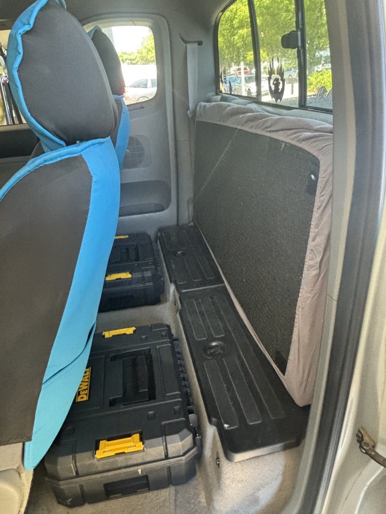

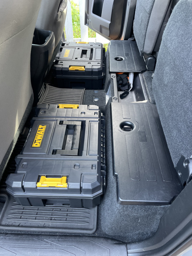

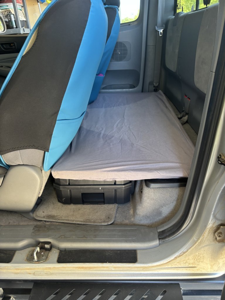

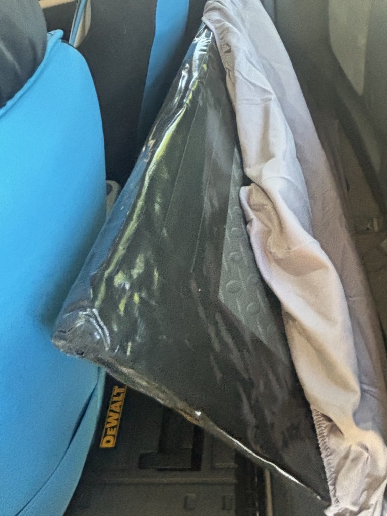

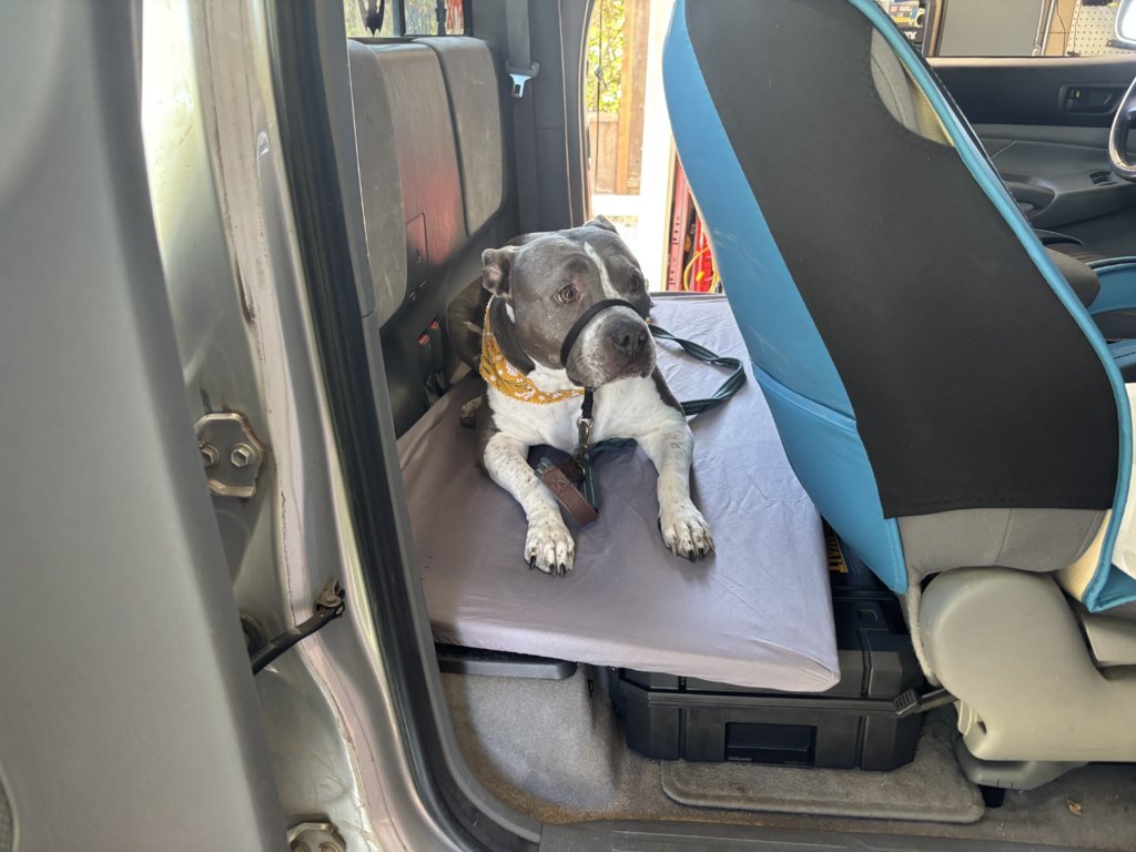

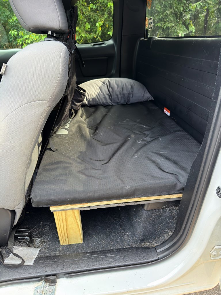

    Here was my solution. Didn't have any scrap plywood so I bought a 2'x4' piece of 3/8 birch and trimmed it 3" on the long side to get more seat clearance. It doesn't quite span door to door in the back but it's close enough. Only about 3" shorter than the op's measurements and I could buy it off the shelf.
    I did buy the same DeWalt cases from Amazon. Can't beat them as they're the perfect height, strong enough to sorry a dog or two, and cheap at $20 a pop. IMG_4159.jpg IMG_4168.jpg IMG_4169.jpg IMG_4167.jpg
    I used a cheap floor mat on the bottom, wrapped over the dudes and stapled like upholstery. Glued some foam floor mats to the top and trimmed them to fit, then wrapped all the edges in gorilla tape.
    Lastly, I got a fitted sheet for a child's nap mat for a washable top.
