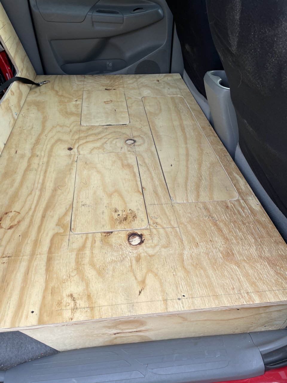

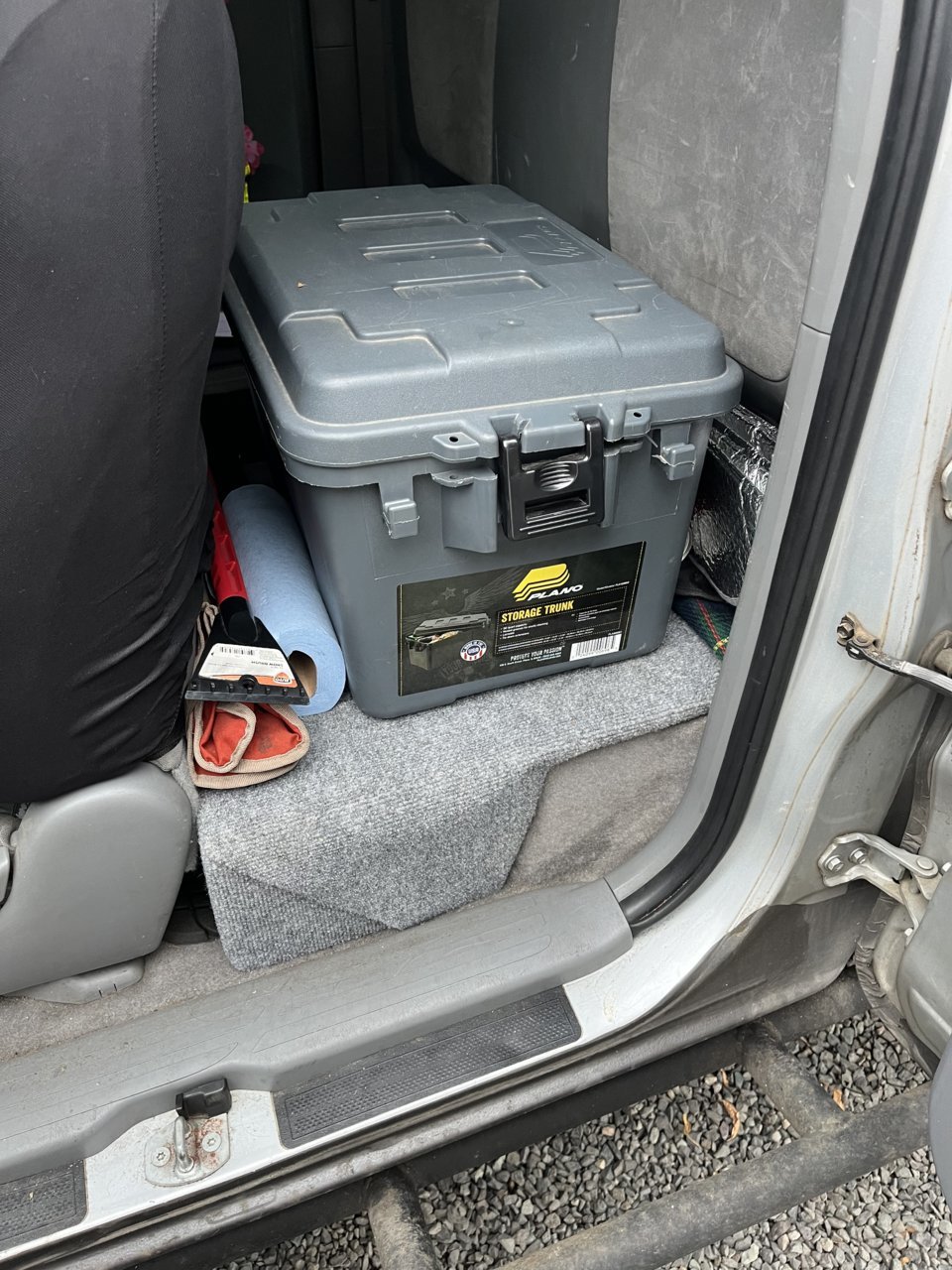

    I built this out of leftover like shelf wood material lol kind of rushed it but it was just going to be a mock up to get measurements and stuff but I ended up just keeping it in there. I really like the Goose Gear storage but couldn’t justify the price. Anyways, I dedicated to behind my seat as storage and left the passenger side open in case I had to put someone back there.

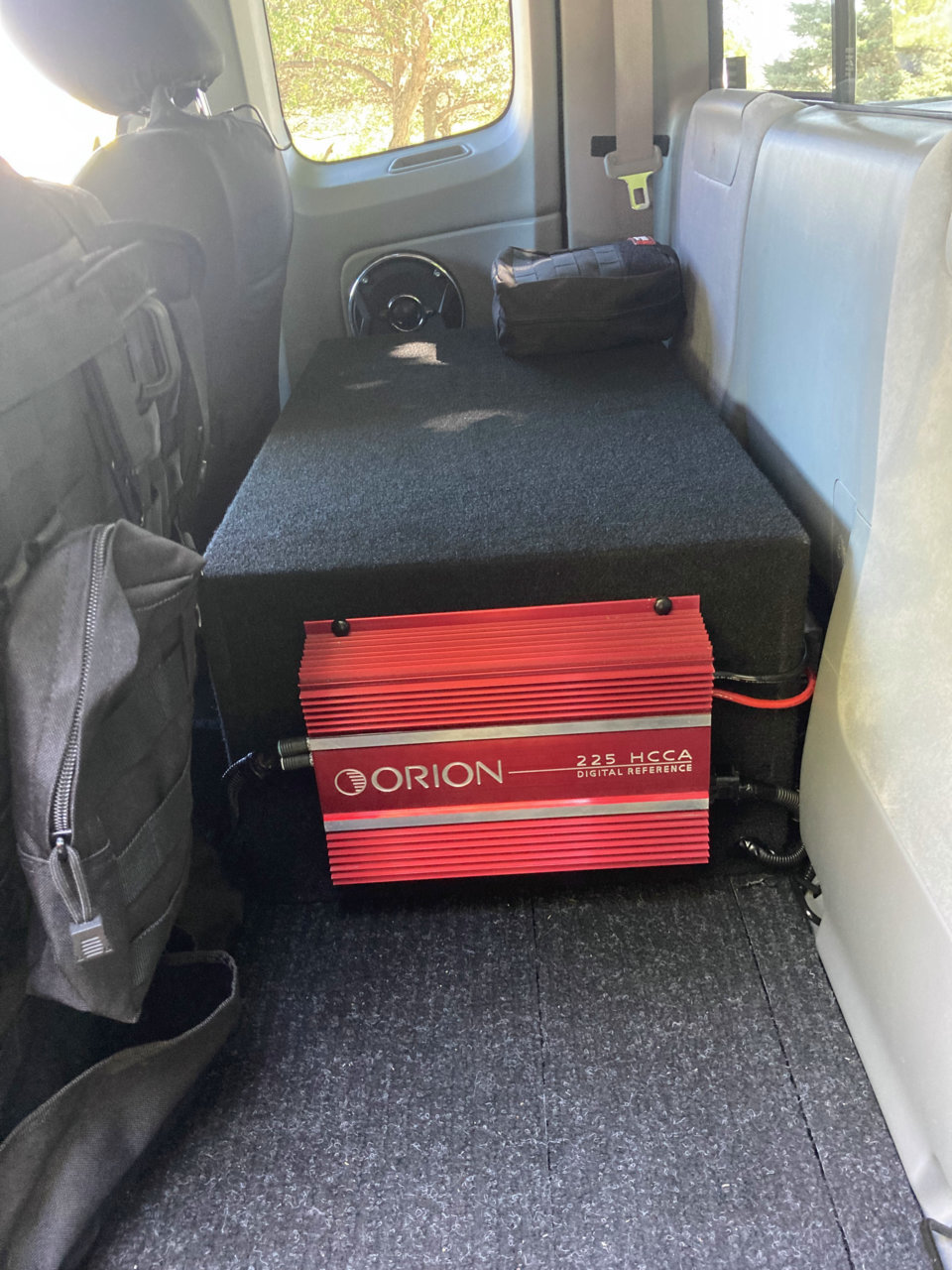

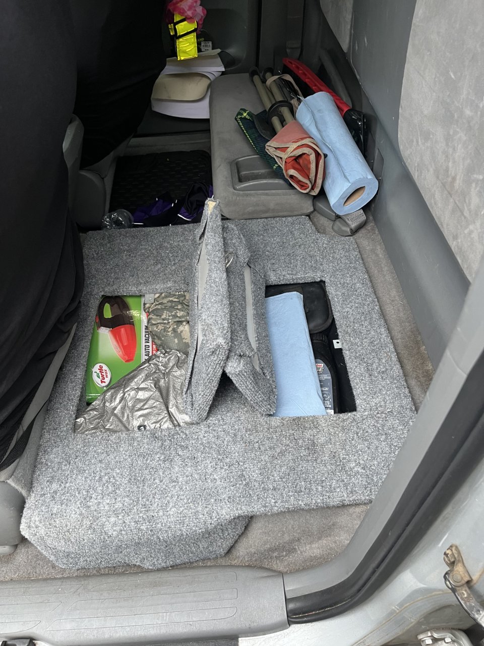

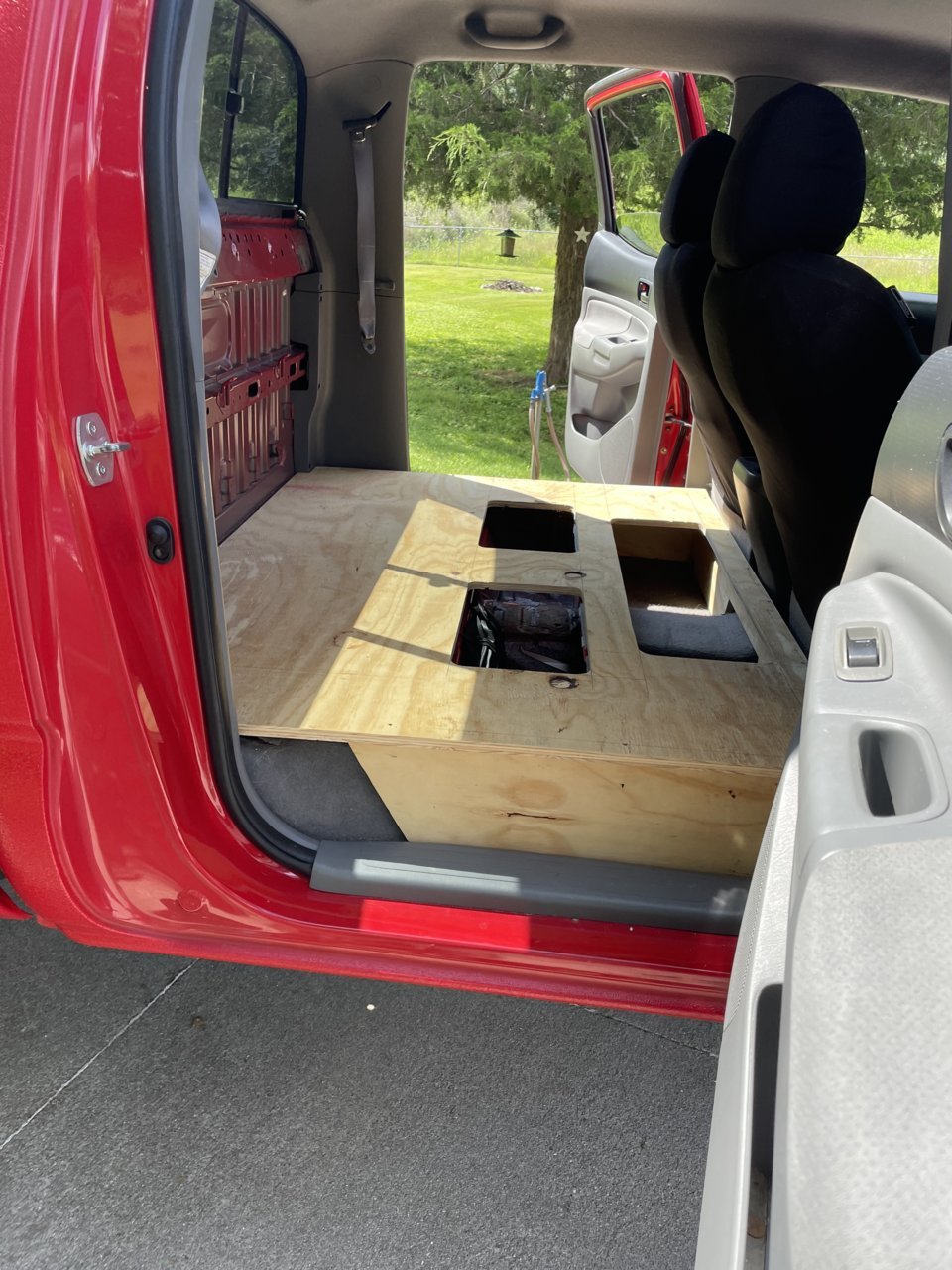

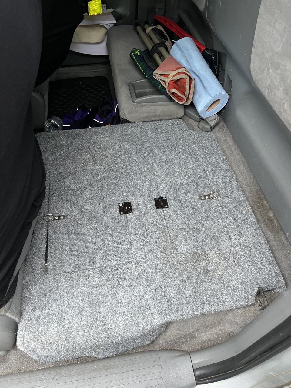

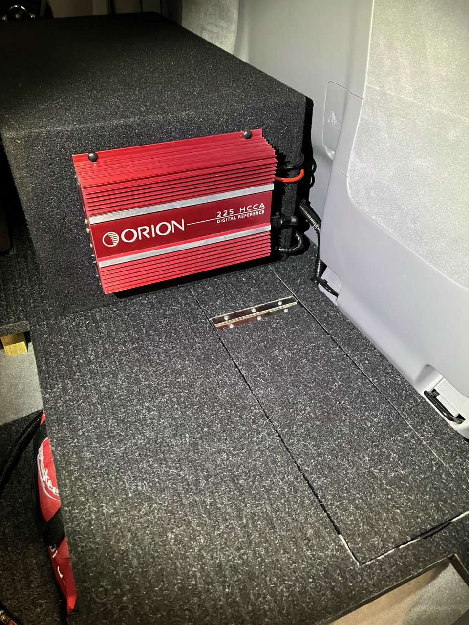

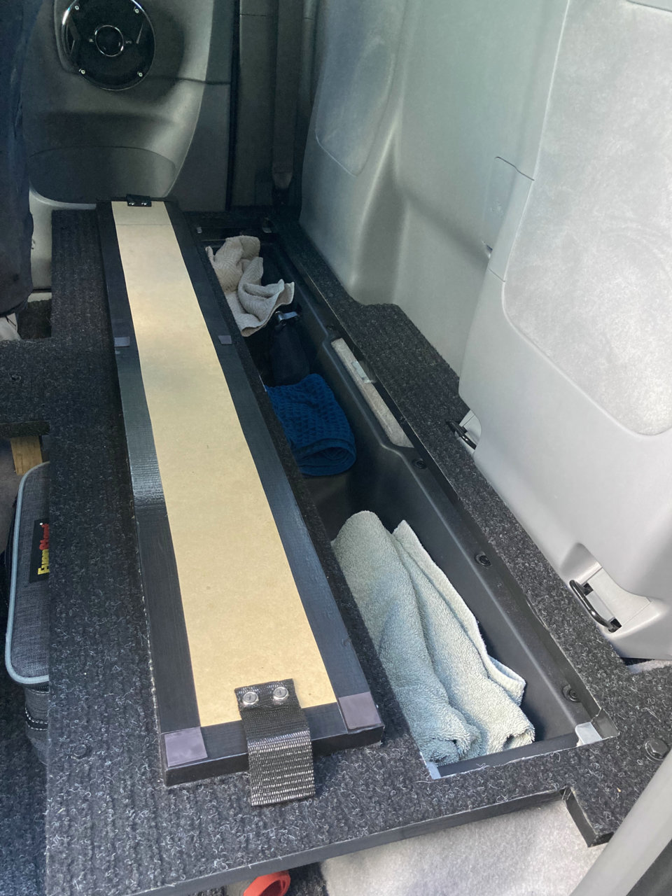

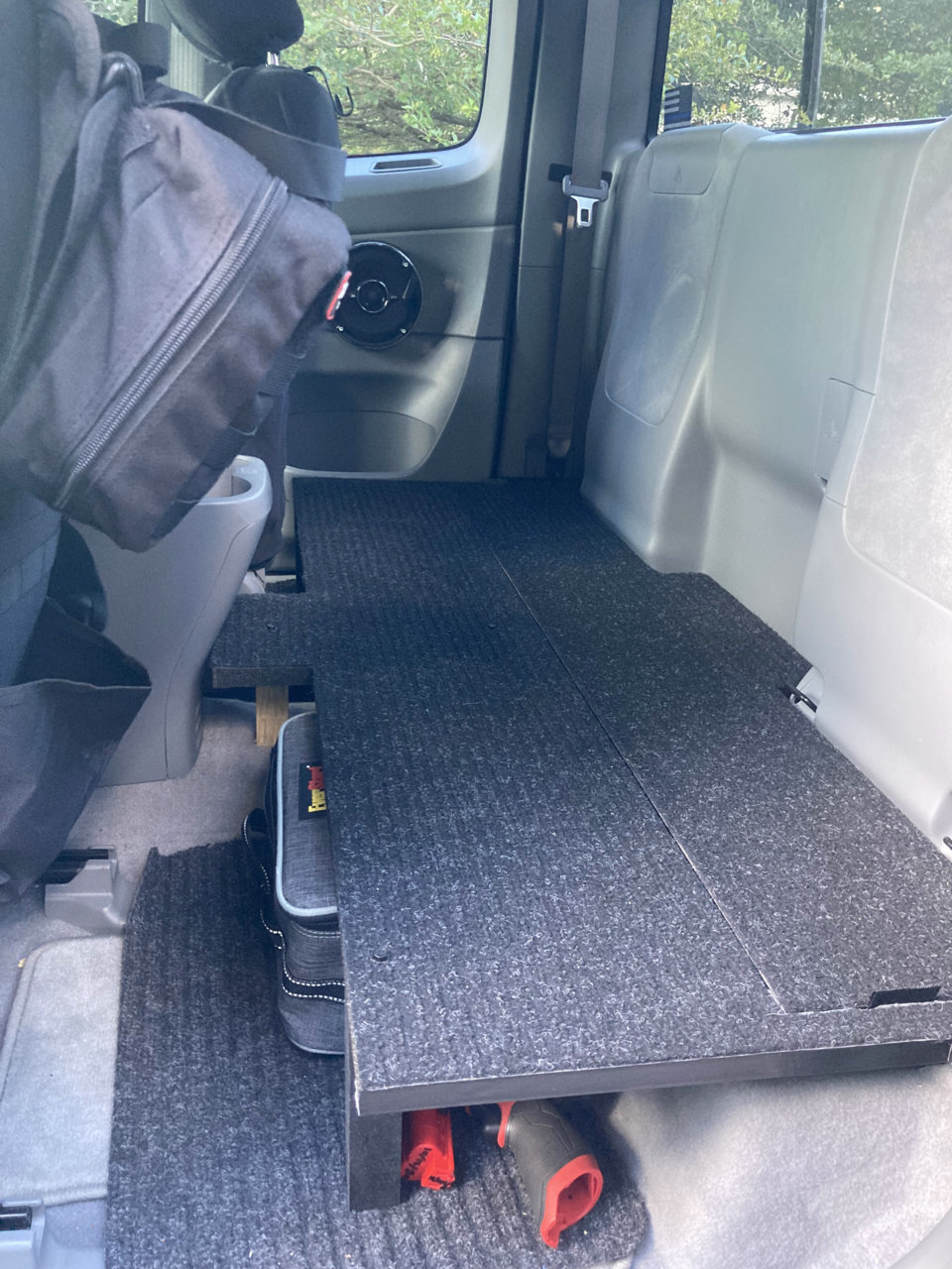

    After removing seats and center console I built a platform out of 3/4 plywood. The center leg was not painted because the seats are always all the way back. Made a door to access the under seat storage. It was always the plan to make a place for the subwoofer box. The wiring was done so the box could be easily removed if needed. Added a hinge to the trapdoor so I could get to the jack and tools.

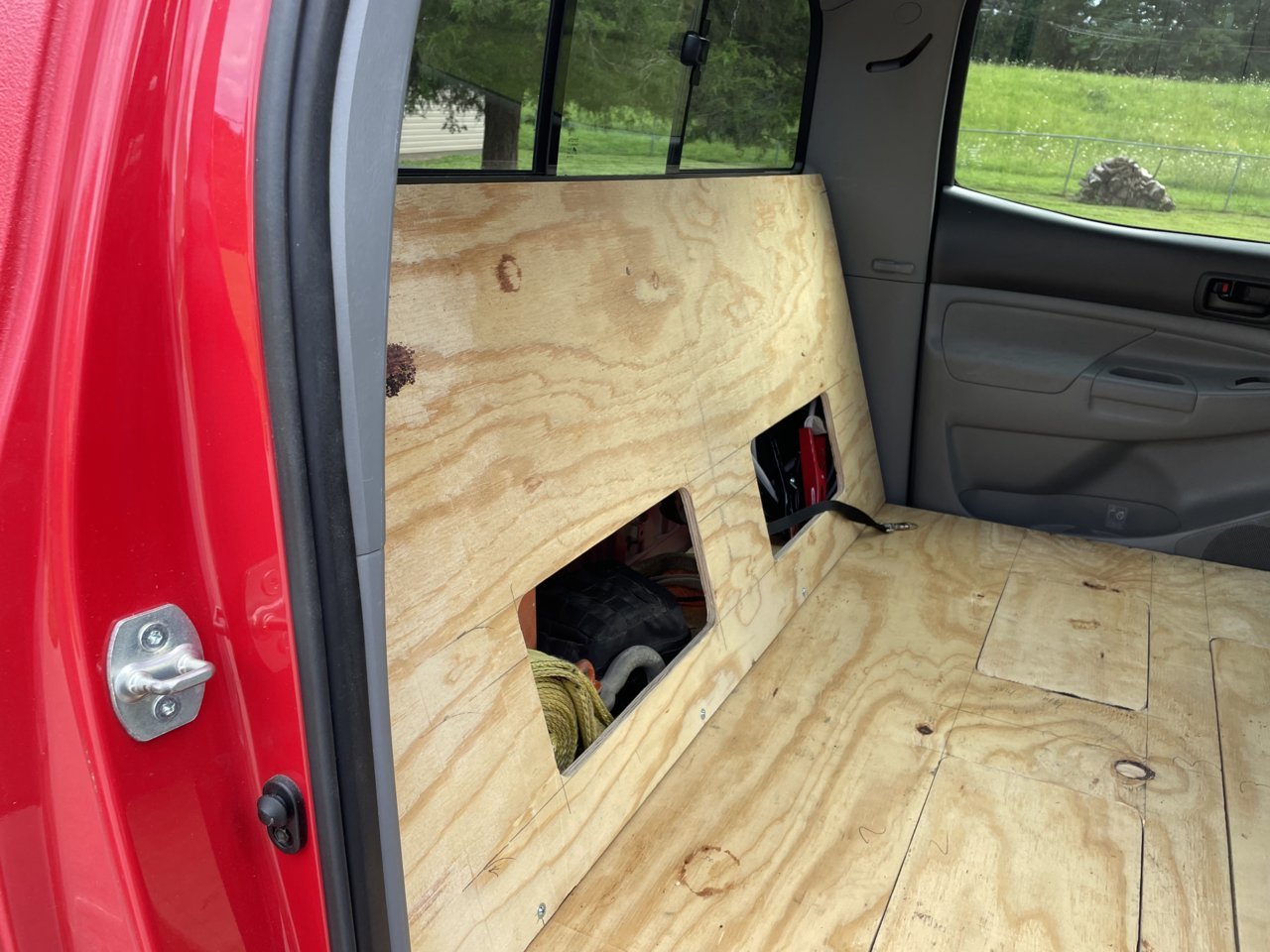

    Not a acc cab but same principle. I used 5/8 plywood and raptor lined it.
