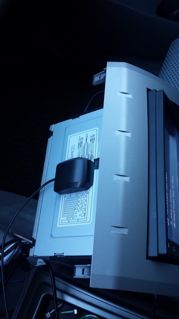

    Staten Island NY
    2013 TRD Sport MGM
    TRD Cat Back Exhaust, Bed mat, Weather Techs wet okole seat covers
    Went with this. Would have done the bed rail thing but I had a shell put on. I put the GPS antenna non the hu. Thanks for the helpimage.jpg
