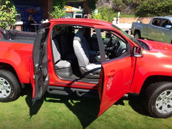

    You can unbolt the OEM door catch and see how much farther the door can swing before it hits something. My guess is not much. You'll need either longer hinge brackets or articulated hinge brackets like the GM ones:
    tinker_troy and Malvolio[QUOTED] like this.
  12. Oct 2, 2022 at 6:48 PM
    Malvolio
    Malvolio free zip ties for Stun
    Jul 23, 2018
    #260236
    3,255
    SoCal Dumbgeon
    2017 DCSB SR5 2WD
    Ew, is it the hinge limiting the swing out too? That’s more involved.

    Looks like the crossbar limits travel of the "first stage", while the little articulated link on the left limits travel of the "second stage", and prevents the second stage from opening until the first stage is open.
