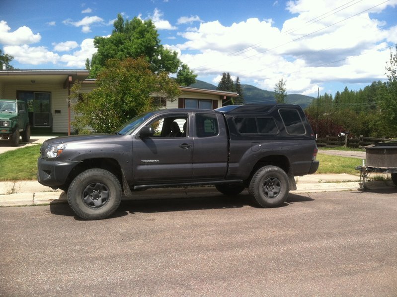

    I've gone back and forth on what I want to do so much that I am really tired of it. My Dakars are on the truck, some of you may have read that debacle... (I'm starting to feel like Krazie Sj )
    Now a new crisis (of first world proportions) - I'm ready to do the front end. I have to do the front end. The rear sits so high, I can hardly see at night and I'm going on a road trip to the Olympic peninsula at the end of the month.
    Oh, and I crashed my mountain bike and sprained both wrists. I can't do the work, but it has to get done. I just made an appointment with my mechanic.
    I'm putting in "new" LCAs with good bushings and new bolts/ cams. I'm doing LR UCAs. I said "fuck it" and got new 5100s and top hats to go with my new 885 coils (will be selling the take offs). I also bought new 1/4" spacers.
    There are so many people running 885s with the "driver side lean" spacer and I don't hear of CV failures from it - I'm thinking about putting both in. Taco lean isn't an issue - I've replaced my body mount bushings.
    The question for those of you with Access Cabs and 885s... How much lift did you get? More specifically, what are your center of hub to fender measurements?

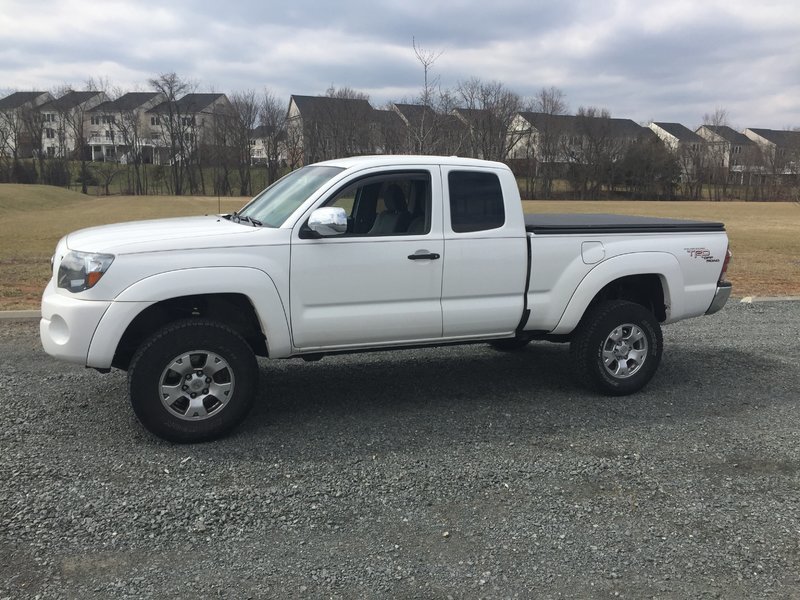

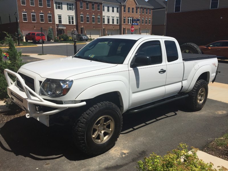

    Heres mine. No top plate spacer, but the drivers 5mm spacer to accommodate for the taco lean. Unfortunately i didnt measure.
    This pic is current. I measured from the top of the rim to the bottom of the fender. I am at 13.5" but I also have 33s

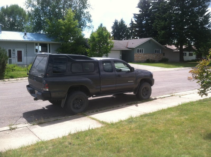

    Here's mine. I'm on 33s too. 5100s @ 1.75" IFS and mid skids, bolt on sliders (all Pelfrey)
    @fatfurious2 is 13.5 now or before the bumper. I'm about that high on the low side (1/2" body lift), driver side is higher than that now.

    13.5" after the bumper. I think the bumper is about 110lbs. I also have a front skid plate at 50lbs, and LCA skids at 50 total.
