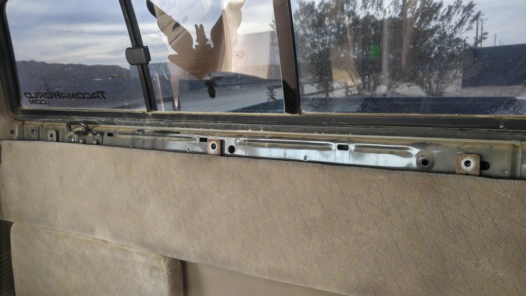

    Okay guys, quick and easy question for you, I'm planning on looking when I get home, but I'm at work right now and didn't drive my truck today.
    So my question is, how does one remove the seat back rest in the rear of a 1st gen access cab? I glanced at it before and didn't see any screws or clips holding it in.
    Just curious before I try it. Thanks.
    Edit: Meant access cab for the title, auto correct got me, and I don't know how to edit the thread title.

    Not sure on 2000's, but it'll Probly be the same. There is a plastic trim piece on top that you gotta remove. Bolts will be behind that. Trim piece will need to be popped out. Iirc, pull out from the top. 'if' it's the same as mine.

    Yep, looks exactly the same, thanks!
