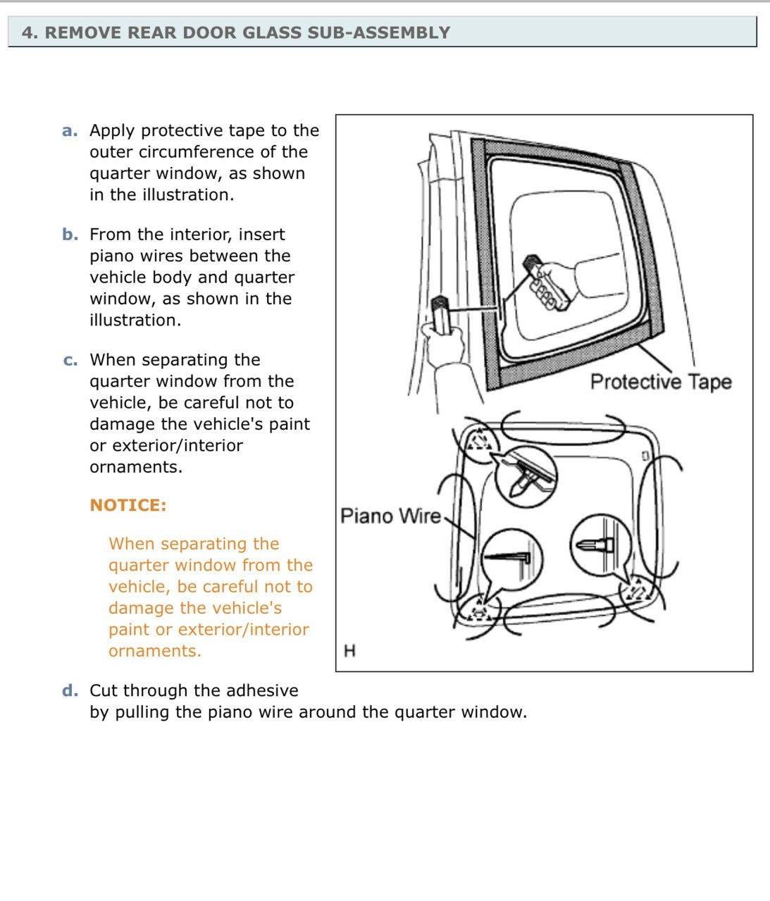

    Hi new member here just bought a 06 access cab that has the passenger access door with damage found a replacement at the salvage yard but it’s the wrong color red Toyota had two red colors that year so I am going to paint at least the outside of the new door. Has anyone taken the glass out of one of those without breaking it as it is glued in or should I just take it to an auto glass shop and see what they say.Thanks for any help

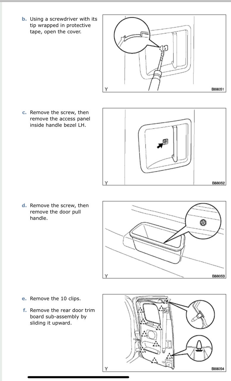

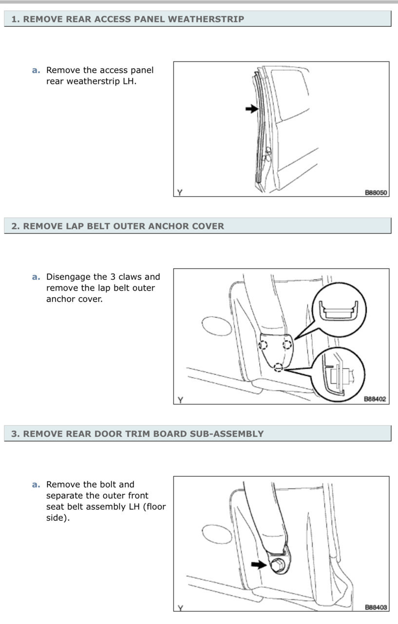

    It’s glued in, but it is removable.
    FF8F2B85-4850-4EC3-A0A6-A0E6849CA536.jpg D217D28D-F5C5-48F8-93F8-427128FBDC25.jpg 1A038A50-5EAC-4855-B9E2-F8F85091C606.jpg
