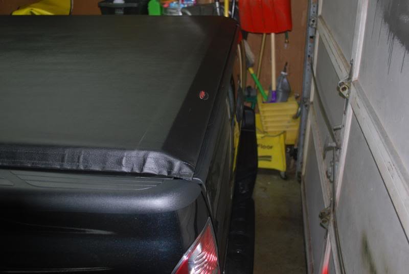

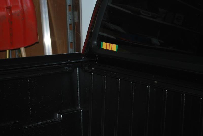

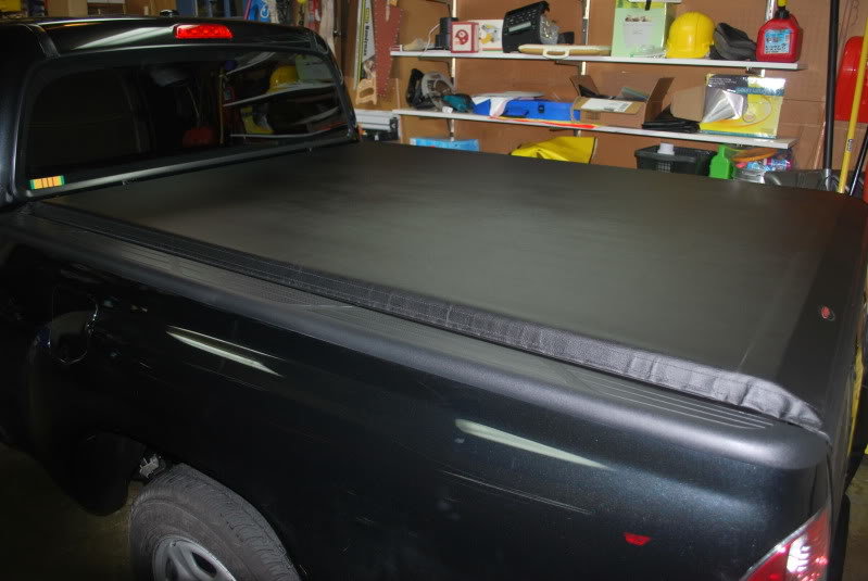

    I did a lot of searching and never found a thread about the Access LE install on a Tacoma so I thought a thread would be in order.

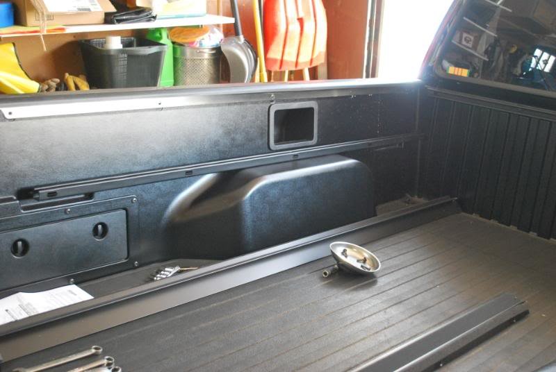

    I will start by saying that one person can do the install but two would be ideal. I am satisfied with the product as it fits my requirements. For some you might want to consider another one of the Access products. With the LE you get a top of the line unlocking system and a tailgate seal that does not work too well with the Tacoma. The Access site, http://www.agricover.com/index.php , also has a clamp with cargo hooks listed but these are not needed or included with the LE for a 2005+ Tacoma. I had to call Customer Service twice and both times Randy was very helpful.

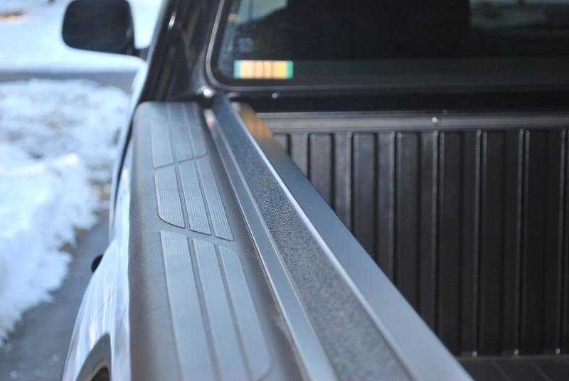

    You really need to read the instructions and pay attention to the instruction insert for the Tacoma. Unpack the tonneau cover and take inventory of all the parts.

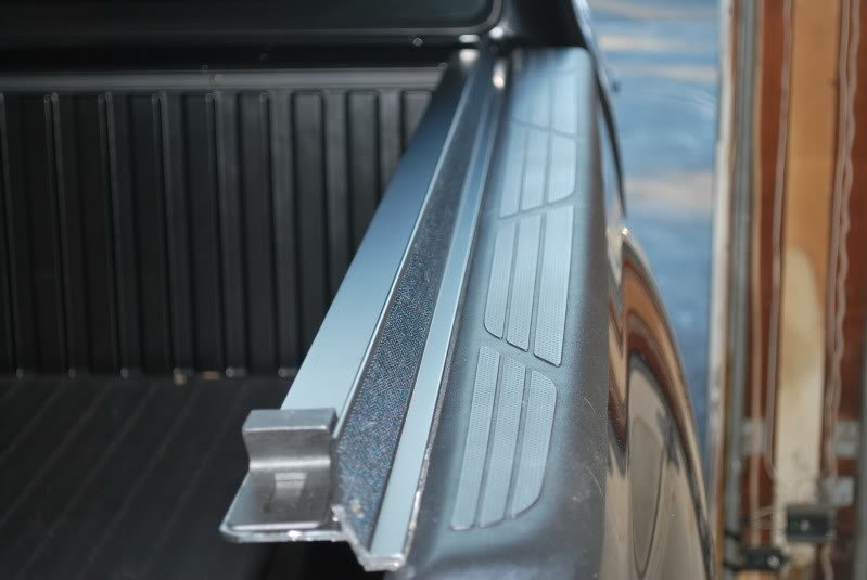

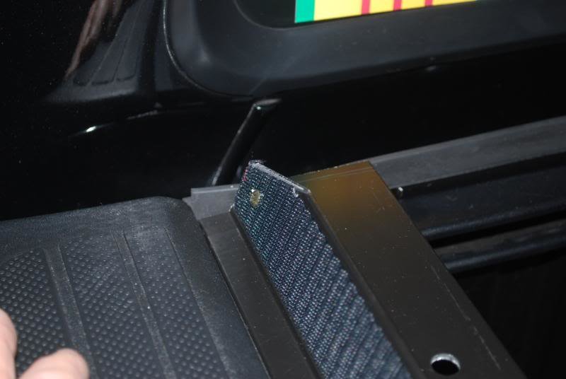

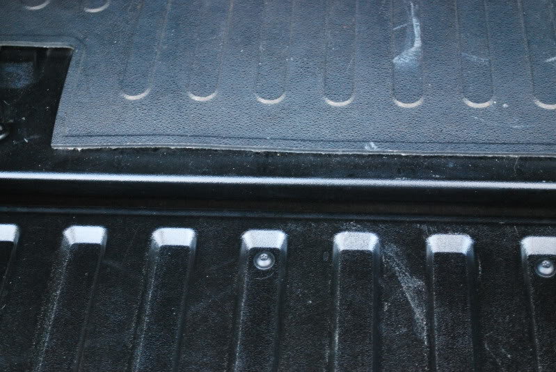

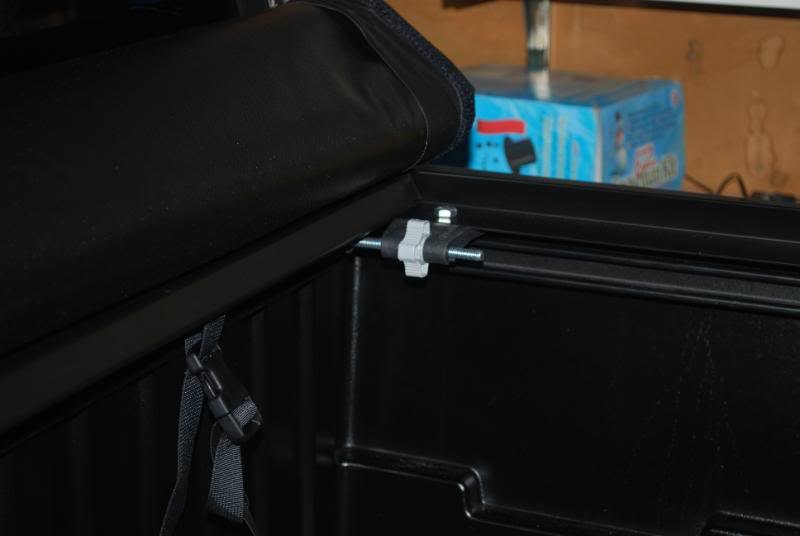

    Remove one of the bed side rails to start the install. One tip is that the longer bolts, supplied with the cover, use a smaller thorax drive so be careful and do not strip the bolt head. Once you begin the actual install of the side rail I found it easier to start with the middle bolt and work towards the end bolts. This is where having a friend to help would be ideal.

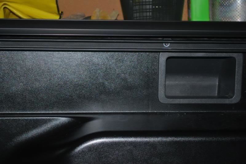

    Next up is the install of the front weather seal to the top of the bed.

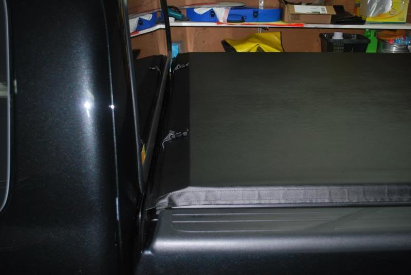

    Then we add the front tension dials to the cover and then bolt to the side rails.
    Unroll the tonneau cover and it snaps right into the rear of the side rails with a nice tight fit.

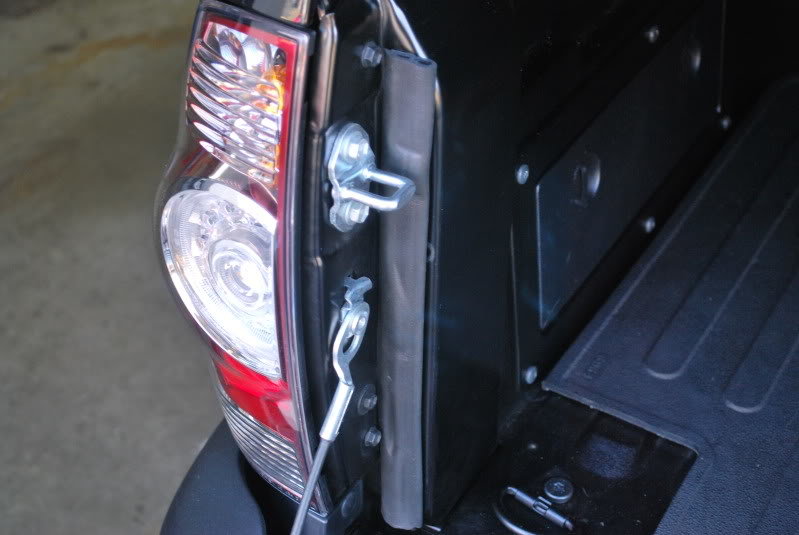

    The last item to install is the rear tailgate gasket that comes with the Access LE. I decided to install the gasket to the vertical surface of the tailgate and not the lower horizontal surface. When I tried to install the gasket as one piece the bend at the bottom was constantly being hit by the lower edge of the tailgate. If I tried to install the horizontal seal then the gasket was above the surface plane of the truck bed. I use the truck as a garden center hauler so I felt that one good load of top soil, sand, rock or mulch then the seal would be trashed.
    If any member has the tailgate gasket installed and hauls garden center items I would like you input for the longevity of the gasket.
    If you have a question concerning the install go ahead and ask and I will answer and take additional pictures if needed.

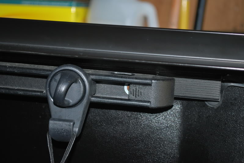

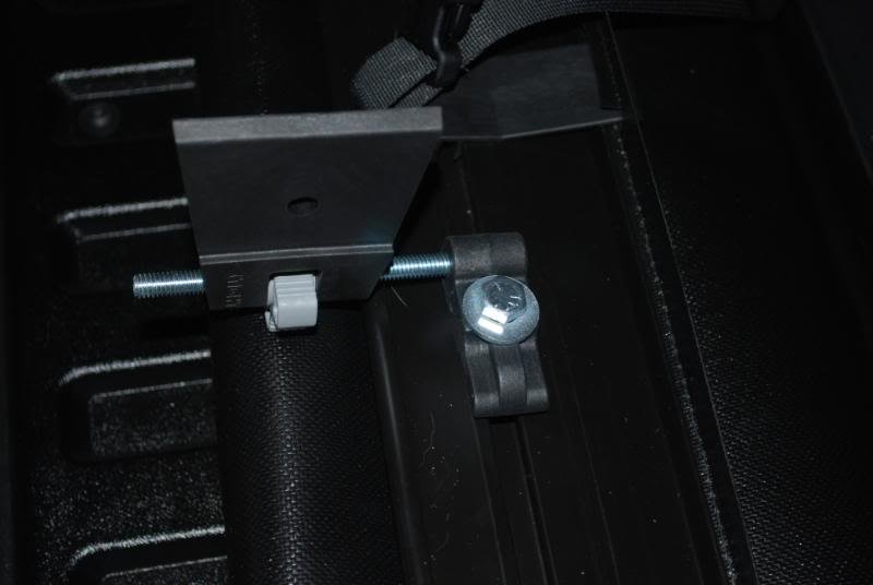

    The only con is the side rail tie downs will not fit but I did not use them anyway.

    why don't the tie downs fit after the cover was installed it looks like the cover leaves the rail system wide open? Is it the brackets for the cover are to low to fit the tie downs in?

    The way the the metal brackets, that have the velcro strips, are bent do not allow the larger base of the stock tie down rings to fit into the stock rail. I believe the smaller optional tie down rings will fit.
    I am still like the cover after a year of use. I have not had any issues even when hauling rock and mulch.

    I installed this same cover last year. My tie downs still work. the cover does everything I need it to.
    I did not put the tailgate gasket in and it still keeps the snow/water out for the most part.
    One thing i did was replace the bolts that come with the cover for the bed channels. The ones that came with the cover started to rust and was worried I wouldn't be able to get them out very easy later on.

    The stock tie downs will not work. However the smaller tie downs work to perfection. ;)

    Hey, nice write up, but I have to disagree with you about the stock cleats not working with the Access LE. I have the same cover and they work fine. I originally took off the end caps of the tonneau rail and slid them on, but have later discovered that you don't even have to do that. Look for the slotted tabs in the cleat track and you can put the cleat in the track there. The height of the tonneu cover rails clears the cleats just fine.
    http://www.cardomain.com/ride/2241706/2006-toyota-tacoma-xtra-cab/page-2

    I did not try that approach. I will try it after I get back from the gym this morning.
    Well i am back from the gym and tried it. It worked great. Thank you for telling me how to install the regular size bed cleat. PER for you.

    Already added the 4 original cleats into the rails. An increased versitility for securing loads in the truck.

    I have this cover also and like it.Been on since 09 and it still looks like new.Use the full size cleats with mine as well with no problems.

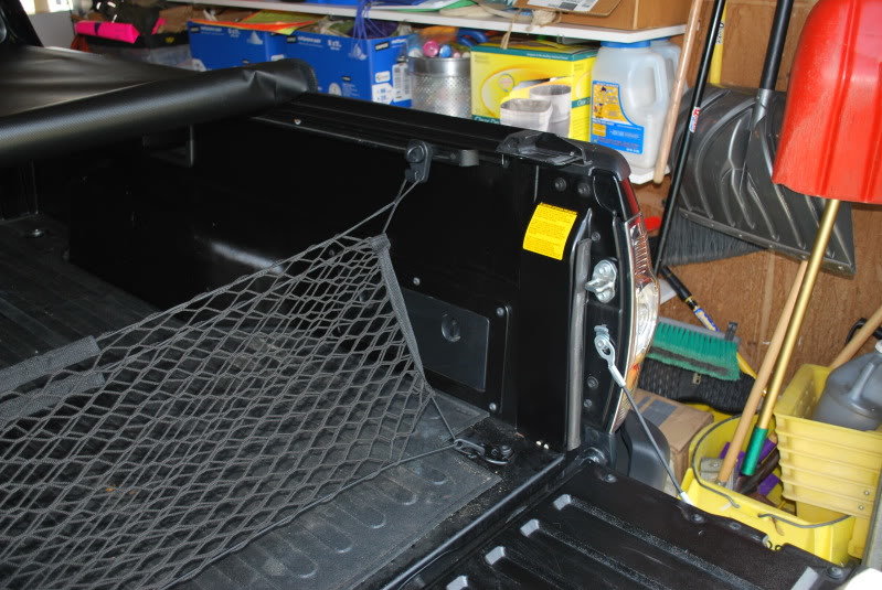

    Since i posted that photo I have found out that the stock tie down clamps in the bed rail will work so that is an error on my part.
    The cargo net is there to hold the groceries in place against the tailgate. My Tacoma does do duty as a grocery getter on Sunday mornings after church. :cool:
