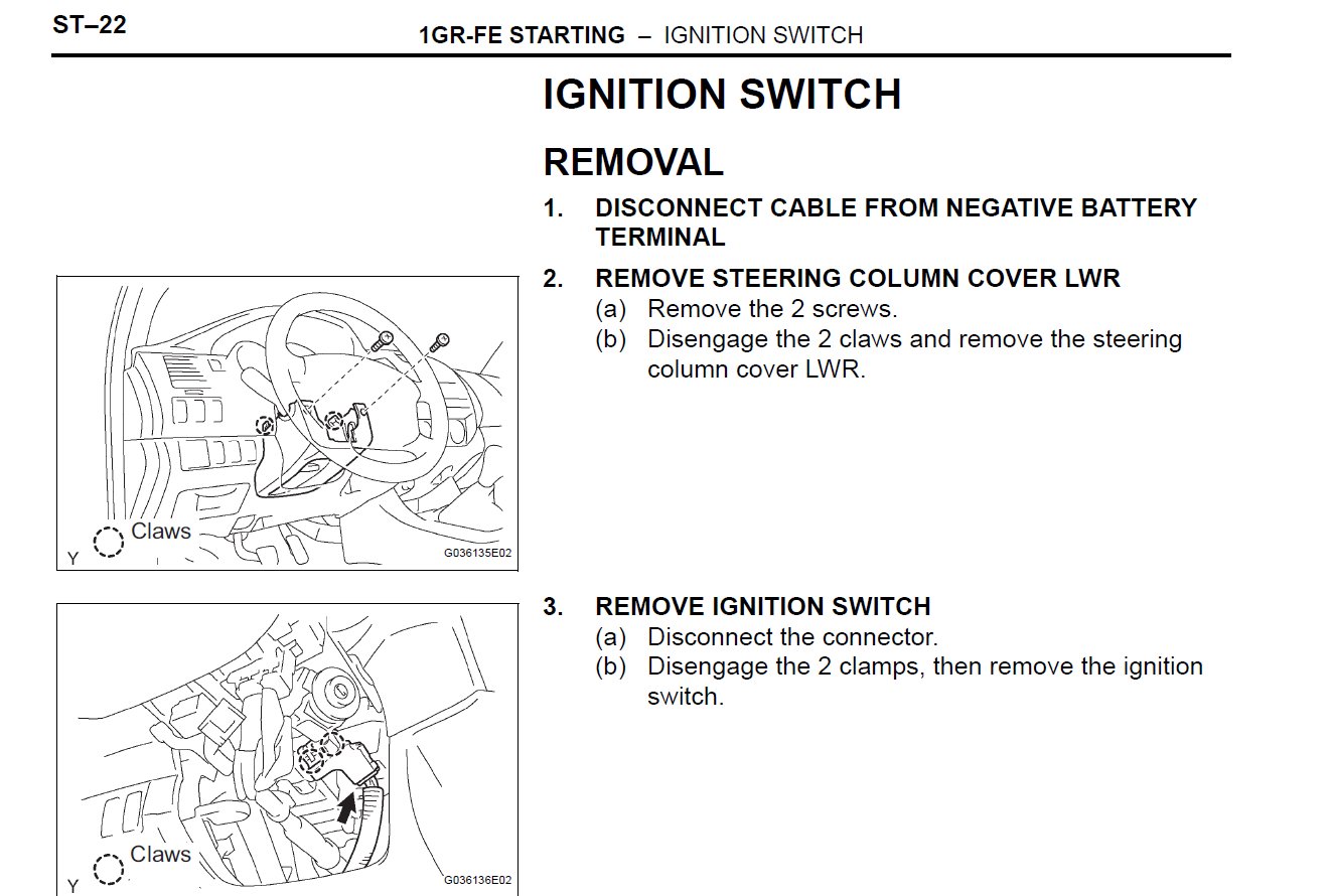

    I am in the need for a link to the youtube video for the details on how to pull the trim and access my ignition switch!

    Are you wanting to remove the ignition switch?

    Yep!! I need to replace it.

    Got it handled!! Thanks!
