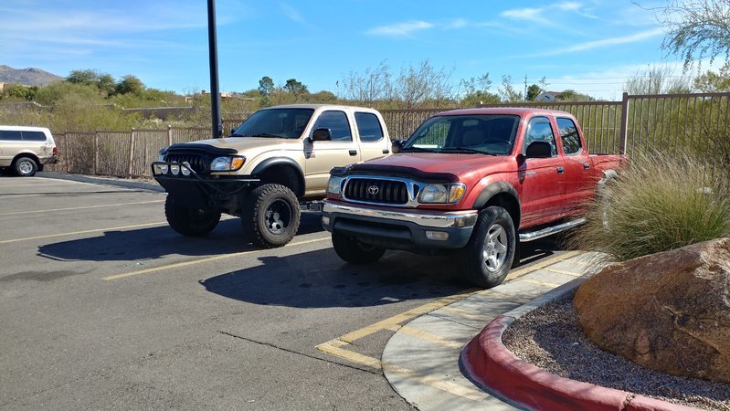

    I had a spacer lift on my truck for 1 yr. Hated it. Front shocks were brand new when we installed the lift and squishy sounding (wore out) after about 8 months. No wheeling offroad either. Another thing to note is you will get axle wrap sooner or later with blocks in the back. -I did
    Yes body lifts are frowned upon here but I do have a 1" body lift on mine. No issues whatsoever so far. But I would never go higher than 1".
    Heres a comparison pic of my truck with spacers/blocks vs OME lift/AAL/ shackles/BL. Yes the OME lift setup is a lot more than spacers but well worth it IMO.
    Here's a pic parked next to a stock one from awhile back.
