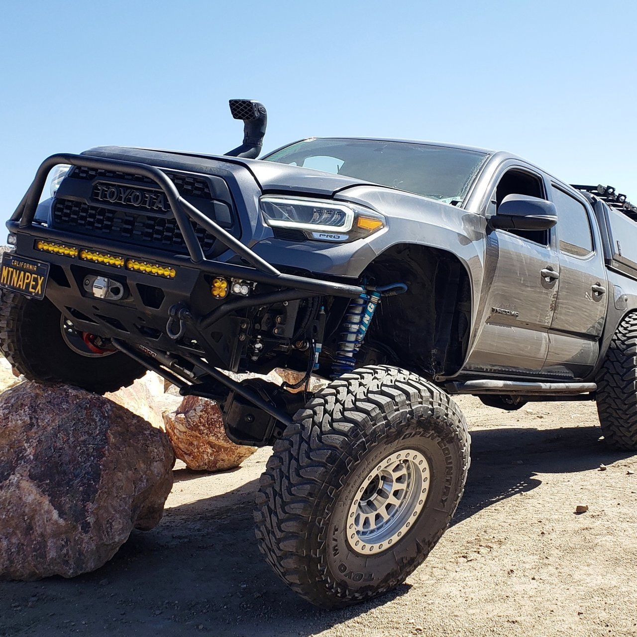

    Hey I got a 2023 Tacoma, I’m thinking about built it and add some accessories but I’m new in this so I don’t really know . I’m thinking about bigger tires and wheels and 3 inch lift . I would love to get any suggestions or if you guys can help me and tell me what tires and wheels and offset do I need to make it look similar to this that I saw! Thank y’all

    Depends on how much you willing to spend and what you’re gonna be doing with the truck. That truck looks like it’s running 35s as they look bigger than the 33s on mine. If you want the least hassle run 285/70r17 tires and wheels with -12 offset. That’s what I’m running on mine without any rubbing issues with 3 inch lift . As for the lift it all boils down to what you’re gonna do. You offroad heavy or just want the look? If you want the look and don’t care to offroad contrary to what a lot of people say you can go with a spacer lift ( people will say not to as it’s garbage and what not) in reality I tan spacer on my old 19 trd or taco and had zero issues yeah the ride isn’t the greatest but it looked good. If you plan on doing a bit of off-roading and want the peace of mind that your suspension won’t crap out on you then bilstein 5100 is the cheapest way to go. Anything else is for suspension will be decided on how much off-roading you do man.

    I won’t be doing off road or anything like that. I just want it for the look so it’s looks good yk? Just saw your truck in your picture it looks sick!! What are you running?
