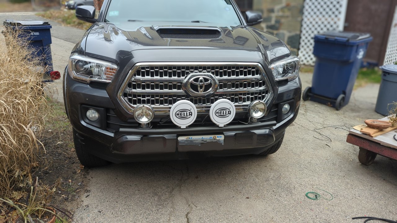

    The calculator I used gave the following info..
    The landing lights are 250 w each 500 w total
    They are spec'd as 13 V
    500 watts by 13 V gives me 39 amps.
    I ran the entire circuit on 10 gauge wire. Heat shrink waterproof crimp connections, 50amp maxi fuse, 60 amp relay in a waterproof housing.
    I hadn't done a calculation on the Fogs and they kept blowing the fuse. I thought maybe I had a wiring problem but it turns out it needed a higher amperage fuse.
    As for the heat, yes, you can warm your hands 5' away from them. It's hilarious how much energy they put out. It takes 5 seconds for the filament to go dark when you shut them off.
