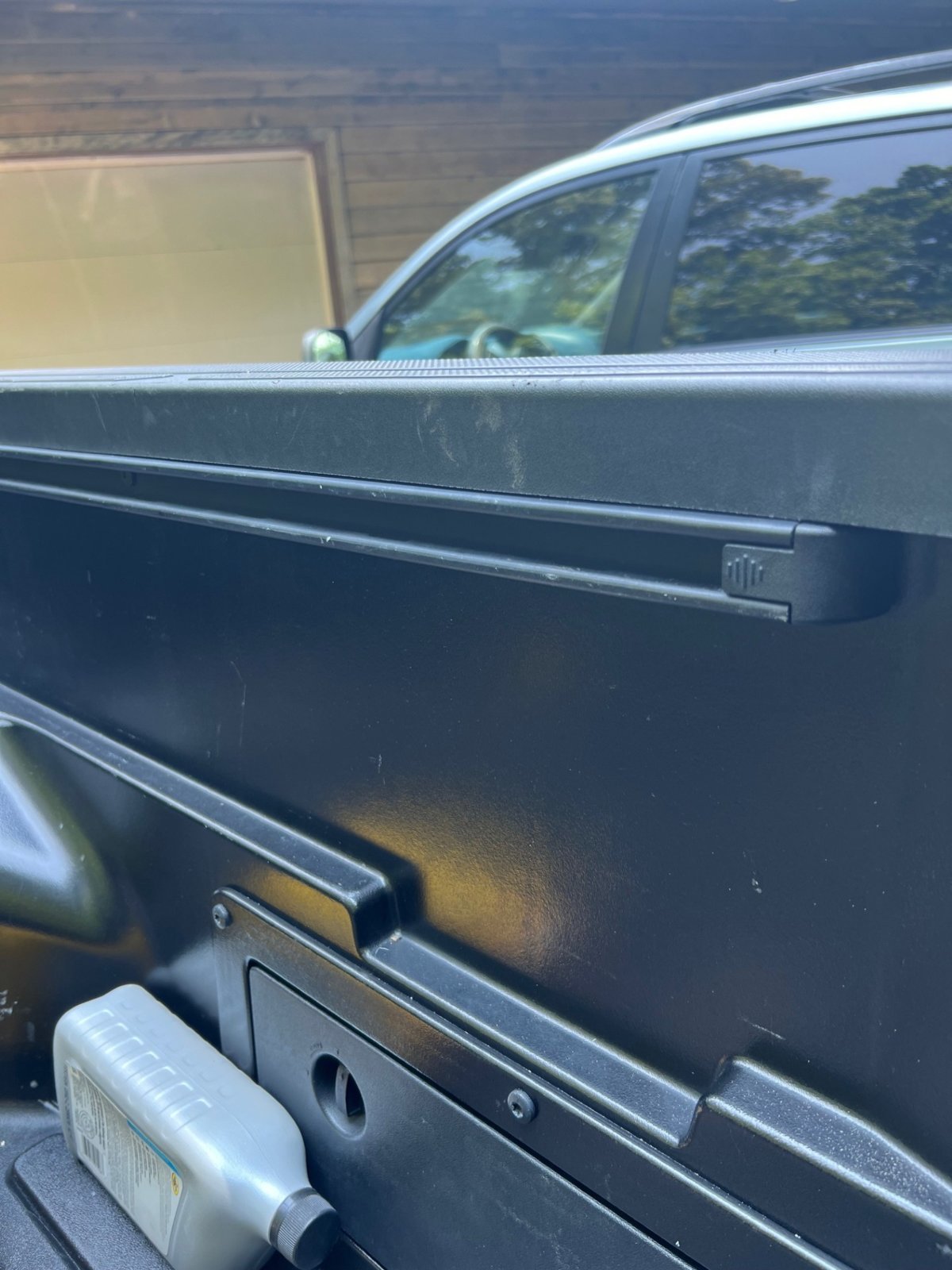

    I want to install a tonneau cover on my 2022 Taco with 6' bed. There is some kind of channel screwed to the truck immediately below the bed rails. They have notches inside the channels at regular intervals. The dealer told me it was some sort of accessory rail. It blocks access to the bottom of the bed rails, so the clamp-on tonneau covers won't fit it. Can anyone help me with this?

    can you post a picture of what you've got? most of the tonneau covers just go directly to the accessory rail in 2 spots per side, and i'm not aware of any add-on that would block the minimal access needed.

    Previous post is a picture of the rail immediately below the bed rail caps. I was hoping to install a Truxedo Pro X15 tonneau cover, but it uses 3 clamps on each side to clamp the cover rails to the bed rails. I don't see a way to do that with the whatever it is rail installed below the bed rail cap.

    That picture is linked directly from your email so no one can see it but you. Can you use the Upload a File button to upload the pic?

    Are you sure you bought the right tonneau cover? Most (all?) Tacoma setups mount the clamps to those factory installed accessory rails.

    Check the hardware that came with the cover. It should have all the stuff for mounting it to those rails. That's where it goes! If you don't have the hardware, call whoever you got the cover from and see if they can sell you the kit for tacomas.

    Thanks. The PDF of the installation instructions didn't show the extra metal pieces that fit into the accessory rails. I guess that I will get special instructions for the Tacoma install when I buy the cover.

    If you buy the prox15 I promise it will fit fine with those accessory mounts. As stated above, just watch YouTube videos for install and it’ll go fine… fits perfect with 100% factory everything; no adjustments needed.
