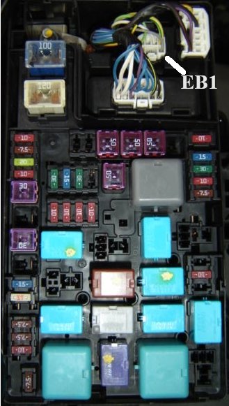

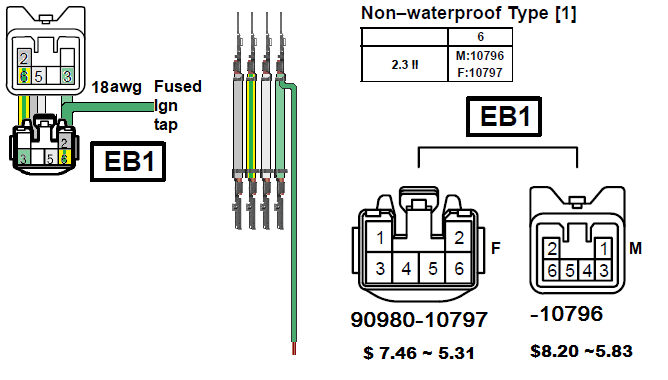

    Looking 4 a good 14-12 gauge wire 2 work with the key on only, so I could splice into & hook up an aux. fuse box. Found several that might work, but not sure what else they control

    I would not reccomend tapping anything into a factory circuit that draws more than about 3 amps, there isn't much overhead built into factory systems
    If you need more than that use a relay triggered off and ignition source.
