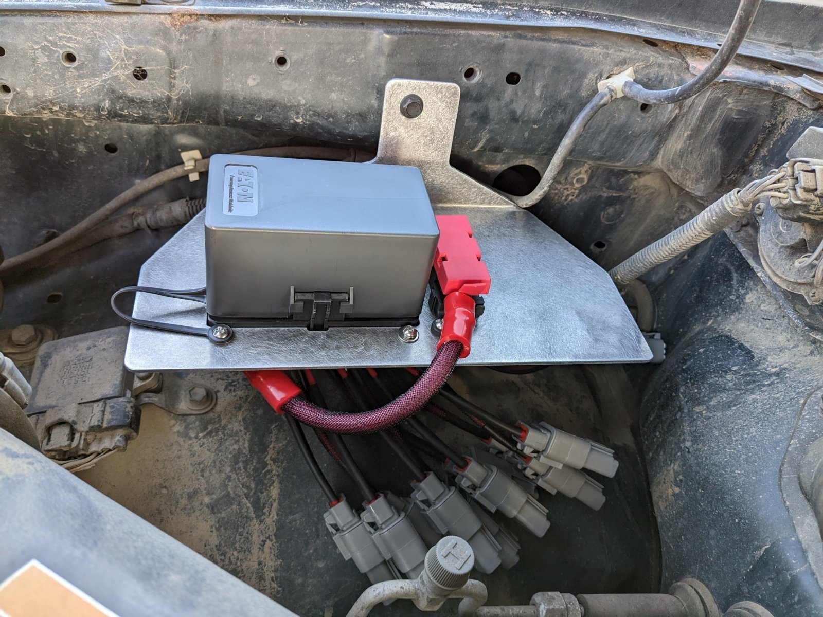

    I'd say your best option is a relay box (or several relay boxes) like the Bussmann boxes that have been mentioned. Each one will have a power bus, a ground bus, relay triggers (that go to your existing switches) and power and ground leads to go to your lights or other accessories. I do build and sell them if building one yourself is more than you want to bite off.
    How many circuits do you have in total?

    You can definitely get panels with space for relay boxes and fuse panels, this is the setup in my truck, you could definitely fit a fuse-only panel on it as well.

    It's not perfect but thought I would post a pic of it in almost cleaned up state...I overdid the fuse panel wiring with 1 guage I would suggest something more flexible
