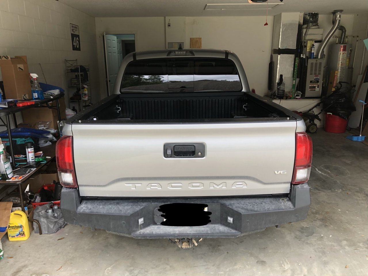

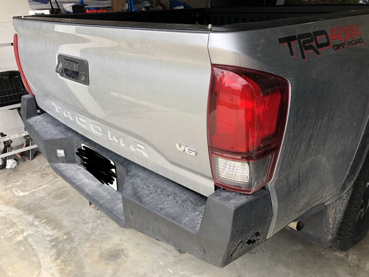

    Another vote for FabFour. Their rear bumpers are pretty nice and have a variant that retains the parking sensors. As mentioned there is only one that retains the BSM and even then the BSM is iffy/may need recalibration after removing and reinstalling. My rear bumper was damaged and I needed a replacement quick, FF was the only one in stock ready to ship (arrived in a couple days). If you’re looking for high clearance or moving the hitch to behind the tag, there are a lot of great options from fabricators on TW but unfortunately I needed the bumper ASAP. Overall I’m quite pleased with it, it’s solid and bolted right up. Gained two recovery points at the bottom of the bumper and it comes powder coated- stack on one of the eBay coupons and you have a decent deal. Trailer harness extension/ adapter for ~$20 is needed for a quick install without needing to loosen the original harness to gain slack.
    CC0CE6E7-665C-4A1E-8758-7A8477D26FBD.jpg A963FD1A-A86C-48B2-A79B-EE004427FE26.jpg

    Fab 4 won’t retain BSM, just the backup. They’re two different sets of sensors, the BSM are two rectangle looking sensors that only work behind a plastic window or bumper, hence the problem with steel bumper compatibility.

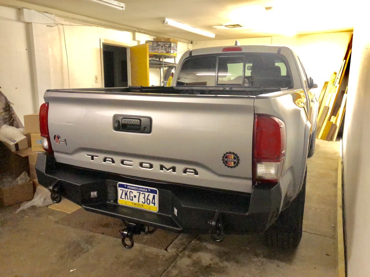

    They’re definitely not high clearance I’m rarely off road and use the factory hitch. It does have a huge step in the middle to get into the bed, which is nice.
