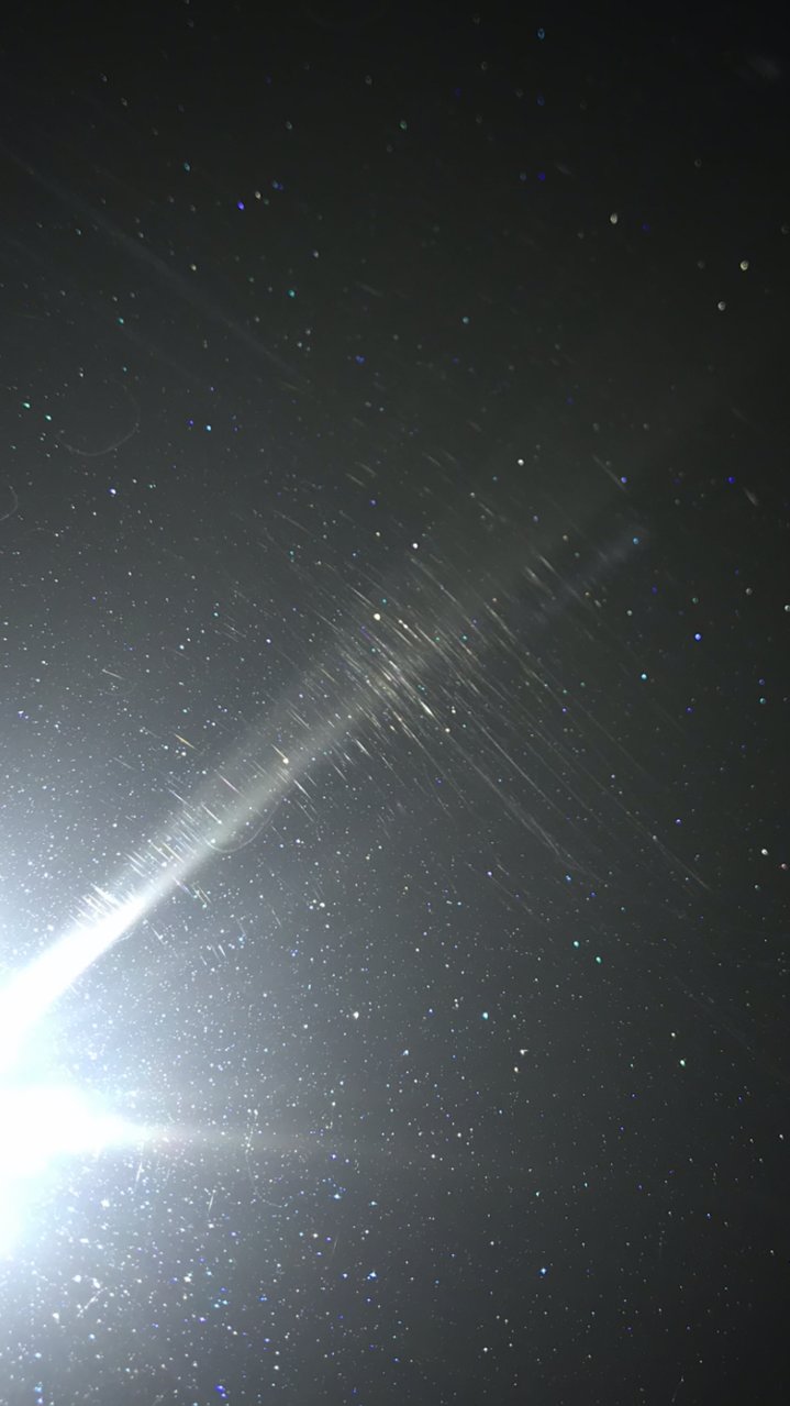

    I managed to scratch up my new rig by attempting to remove bird poop from the hood without realizing the hood wasn’t completely clean to start. Anyways, I managed to remove the doodoo but paid the price by putting a bunch of small scratches into the hood. I didn’t realize my mistake until the hood was dry. Bonehead move.
    What would be the remedy to help lessen the appearance of the scratches? (looking for a more permanent solution than wd40, ect). Thanks in advance for any advice!
    Not sure about rubbing compound because to alter the clear coat this early on doesn’t seem good for the long haul.

    Meguiars ScratchX on a foam applicator pad for starters. That might be all you need. Don't use too much product on the first passes. Use more product on the last passes.
    That should do a lot toward lessening the appearance of the scratches. Might take a few applications. Polish, check your work. Polish some more, check your work.
    ScratchX is a super-micro abrasive (uniformly sized particles) as opposed to diminishing abrasive. So you can stop anywhere in the buffing cycle.

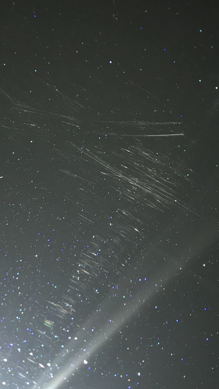

    I realize most products are used to smooth out the scratch area, but is there a product that can fill in the scratches themselves? I’m new to this.

    If your not interested in getting a dual action polisher and all that's involved. Than as was said above Scratch X will get decent results by hand.
    That's how I started out.

    I've never seen a glaze or wax do much in hiding scratches. You need to find a product to level the clear coat around the edge of the scratch.

    You want to smooth out or therefore take the scratch out. Fillers are temporary.

    First go over it with a rotary polisher with a wool pad we with a course compound I use the Rupes Zephir Gloss Coarse Gel Compound . Then go over it with a orbital polisher to remove the swirl mark. I also use the rupes lhr 21es with the yellow pad which is the fine pad with the Rupes Keramik Gloss Fine Gel Polish .
