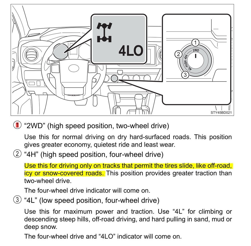

    Because your owners manually literally tells you to not do it

    Trust me... your tires will slide on pavement and rocks too. long before you break something in the transfer case. I agree, driving all day every day on pavement with your part time 4WD engaged is not a good idea, if only because you will wear out your tires in about 10K miles. But there is this black magic taboo voodoo thing about driving on pavement in 4WD. Pavement is truly much easier on the vehicle than going to Moab or climbing some rock ledge. Sometimes common sense and logic need to be used.

    So, you are driving off road on a dirt road in 4HI. You come to a rocky section and a small set of rock ledges that are no problem to go up in 4WD. Do you turn around because you think your transfer case is going to get blowed up if you attempt it? Do you think the coefficient of adhesion of rubber on rock is different than rubber on pavement?

    Calling him crazy is a bit strong. Driving on pavement in 4HI isn't ideal, but over a short period it almost certainly won't hurt anything. Especially something like OP where they went like 20 feet. Even if the front wheels were binding up, most of the time they'll just hop or skid before they start screwing up the t-case.
