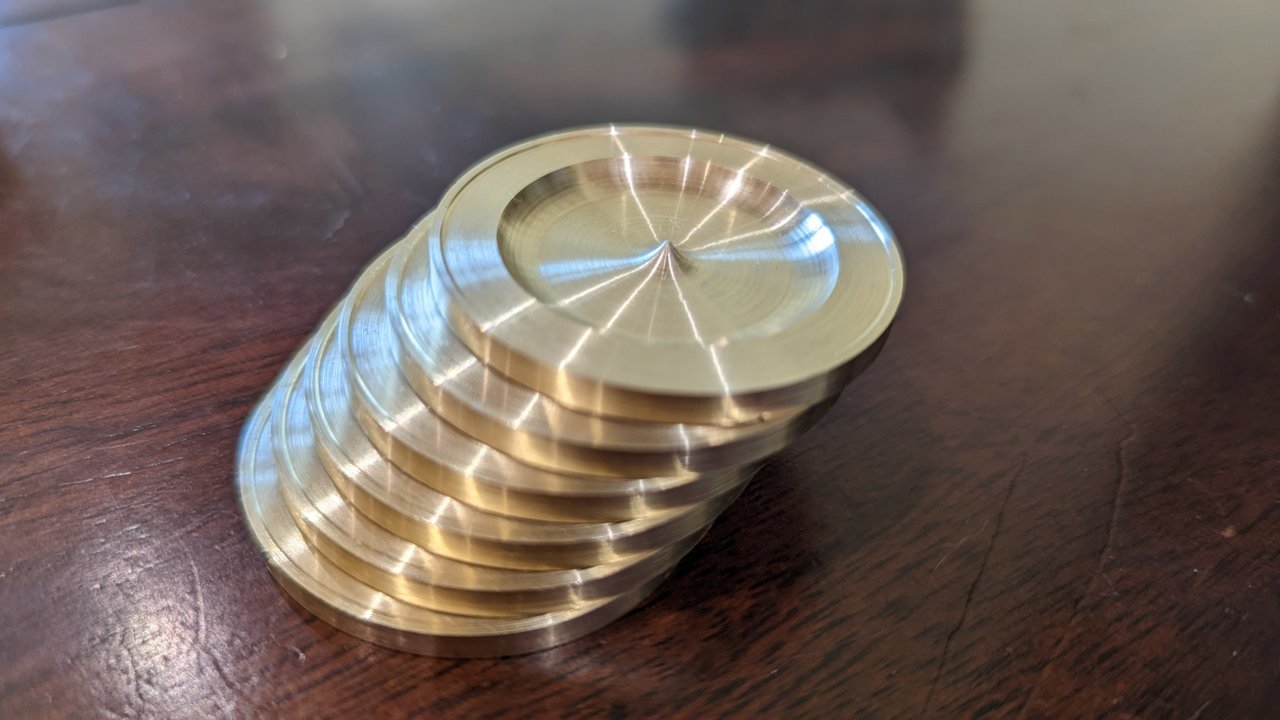

    A sleepy Sunday morning let me make up a few more!

    Still warm, just like Grandma's cookies!

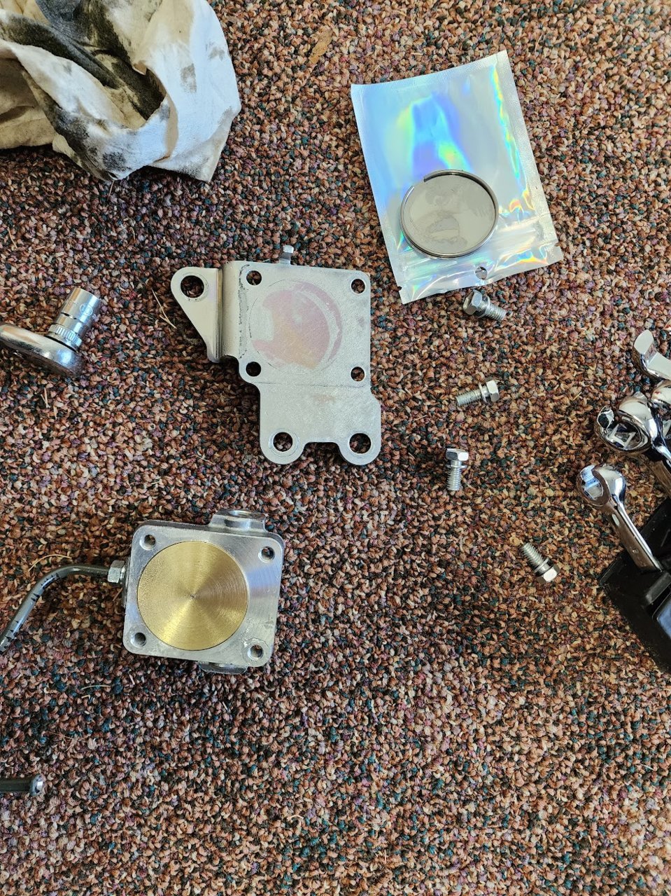

    Got mine in the mail today and installed, PITA to get the accumulator down but clutch feels great now. Thanks again!!

    Do you have greasy parts covered with hydraulic fluid on carpet? :confused:

    Thats my living room carpet nothing a rug doctor cant clean up
