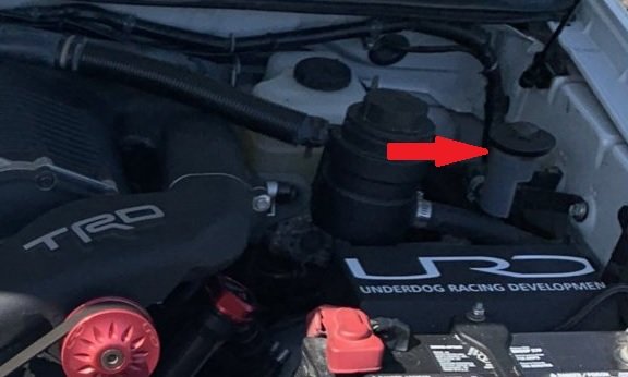

    And on that note, where the hell is the hose I need to clamp.
  11. Sep 22, 2019 at 4:30 PM
    #291
    TeecoTaco
    TeecoTaco Liberty Biberty
    Feb 26, 2017
    #211739
    10,610
    SW Ontario
    16 Taco DCSB TRD Sport 6MT
    Modified the level of gas in the tank
    See that rubber hose coming out of your brake fluid resi....goes down thru or along the firewall...that one

    You want the one coming out of the clutch reservoir. The small cylindrical reservoir hanging off the inner fender

    Cool thanks guys

    Look at you all red arrowy and shit lol. :thumbsup:

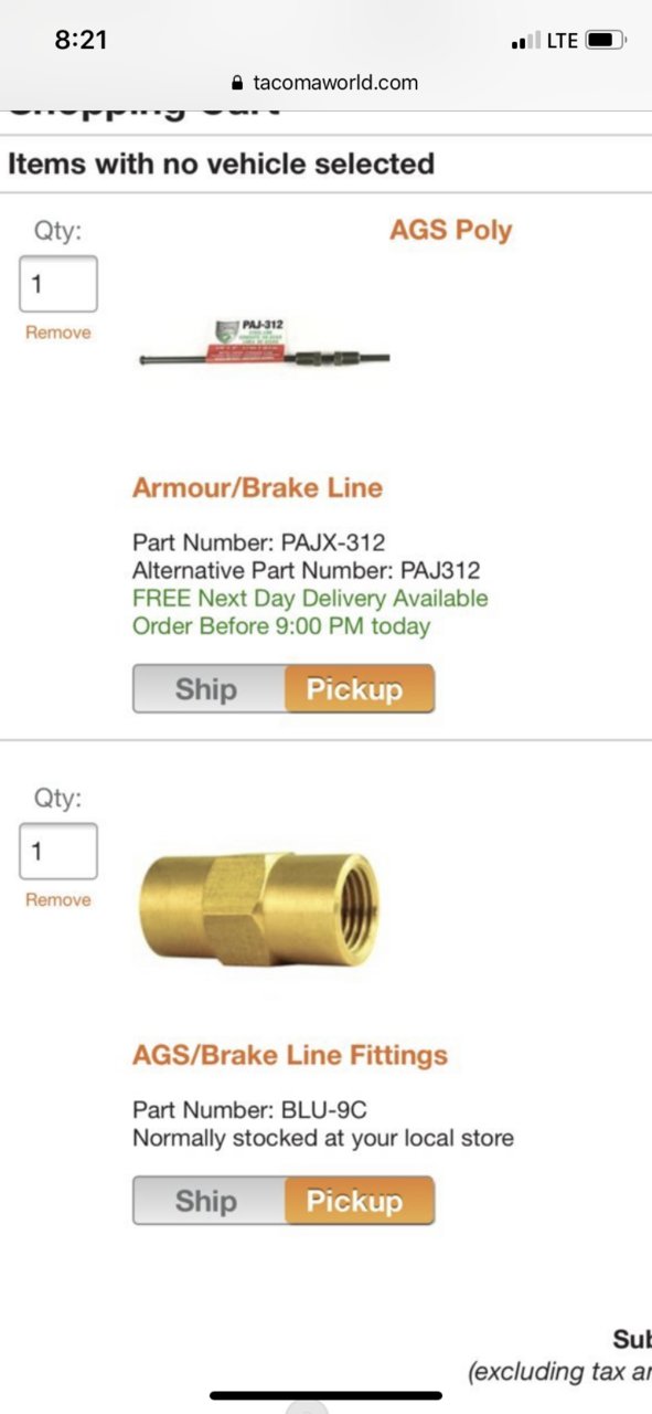

    Parts cost me $10
  17. Sep 22, 2019 at 6:22 PM
    #297
    JuanitoBonito
    JuanitoBonito Que Pasa
    Dec 29, 2013
    #119422
    9,147
    Juan
    CHI-TOWN
    2022 Raptor
    Auto zone.....
  18. Sep 22, 2019 at 7:38 PM
    #298
    Trident904
    Trident904 [OP] Touching Drum Sets
    Jun 13, 2014
    #131875
    5,087
    Brian
    Treasure Coast, Florida
    17 4Runner TRD OR
    Modded it so much it turned into a 4Runner
    FYI, good luck with the fittings on that line. They aren’t sleeves like the stock fittings. I used that exact same part for mine the first time and a week later all the fluid had leaked out. The fitting isn’t quite right for the release cylinder. Some people have used it and gotten it to seat and be fine, but I personally know of 5 or 6 others that had the same issue I had.

    I don’t know man. I just bought what the list said to. I have yet to install mine but your the first person Ive seen to have a bad experience. Do you think you may have cross threaded yours?
  20. Sep 22, 2019 at 7:49 PM
    #300
    Trident904
    Jun 13, 2014
    #131875
    5,087
    Brian
    17 4Runner TRD OR
    It definitely wasn’t cross threaded. I verified when I pulled it off to replace the fittings with sleeved fittings but noticed that the thread on the end of the fitting was flattened. Fortunately I was able to tighten it back up enough to fill the reservoir and get the truck home. The sleeved fittings I use are the same as the OEM fittings and after 190 of them sold and being used, there have been no issues. There is a unthreaded section inside the cylinder that the sleeve fits into to seal the connection.
