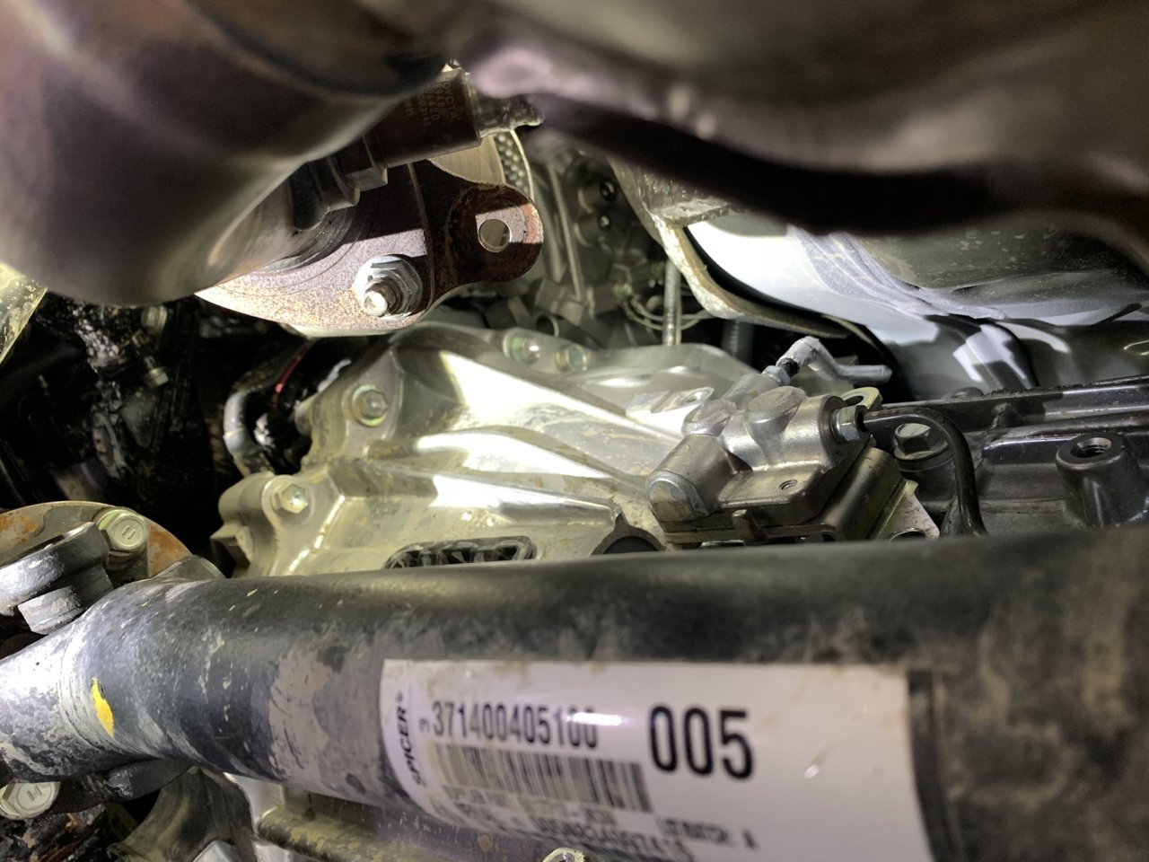

    Yes, the heat shield was put back on after the photo shoot. No issue.

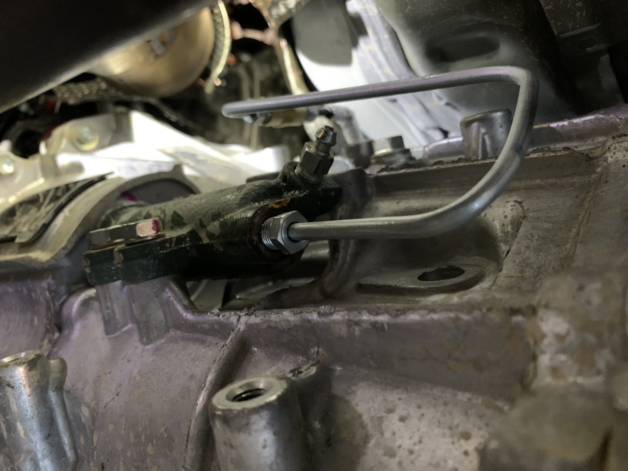

    I was having some difficulty getting mine to sit flush. There is quite a bit of interference between the new line and shield. Wondering if it will rattle too much. How necessary is the shield?

    Not necessary at all, just cosmetics really. You can bend the line to sit closer to the transmission if you need to. It wont hurt it at all.
