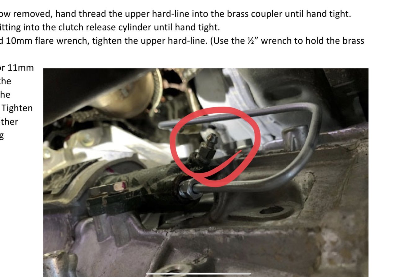

    Question on step 10– “until no more air is coming out of the bleed tube”
    Will we see air pockets among the fluid coming out the tube initially while it still needs to bleed? If so, we’ll know we’re done with this process when ONLY liquid comes out the bleed valve with 5 full presses, correct? In other words it’ll be a very steady stream? Something my 78 year old dad would envy...?

    Steady stream with no bubbles.

    @Trident904 just to confirm, this is the bleeder valve circled in red, right?

    Yes
