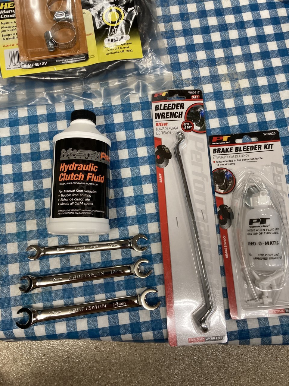

    Anyone know if this fluid is ok or I should go back and get brake fluid?

    Get DOT 3 brake fluid.

    how do you use the bleeder wrench and kit?

    I used the kit as well. Works well with gravity bleeding

    For the record, I’ve never bled a single thing before, not even my hydraulic bike brakes. So a few dollars wasted on little helpers seems ok to me. Not sure I’ll need the wrench but it seemed like a good idea for $6. And the magnet on the bottle plus tubing seems worth the $10, but 20 years ago I’d have never wasted the money on either.
    I’m a complete rookie at any auto mechanic work beyond car stereo. But I’ve spent plenty of time wrenching bikes and I’m reasonably well stocked on tools so this mod seems within reach given the excellent instructions and more specifically the prefab’d part.
    Still, I’m intimidated. And my best buddy from college thought $128 was a fair quote and that I might f it up. I’ve just found, over the years, nobody treats your stuff better than you do.
    I plan to post a solid write up once I attempt it. The biggest challenge for me is time, I have a 2.5 y/o and a 5 y/o and a wife who has trouble understanding why this is necessary or a good use of time. I really don’t want to be rushed on this. And I also, honestly, don’t have a single complaint about my clutch right now except that R takes more muscle than 1st.
    From what I’ve read, clutch and brake fluid are the same thing but I’ll go grab some dot 3 brake fluid just to be safe since I need to go get a longer j hook anyway.

    You’re going to want that 10mm flare wrench lol
