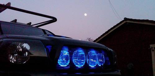

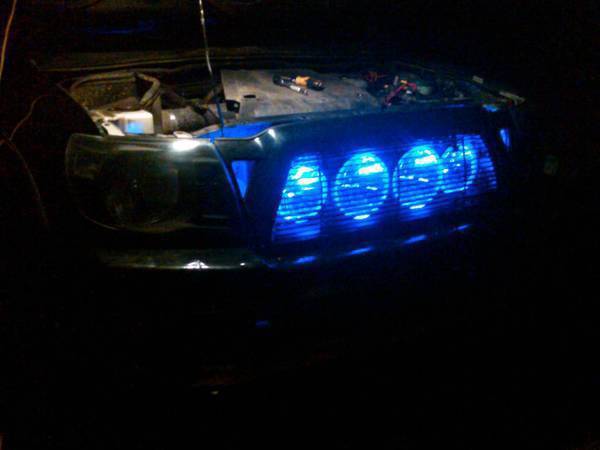

    A lot of folks thought I installed blue LEDs inside the Hellas, that was the clever part of the project, the lights are mounted in such a way that they shine up and into the reflectors of the Hellas and that's what creates the cool blue glow, you can't actually see the lights themselves unless you open the hood. I wanted to light up the Hellas and the radiator area and I actually installed two of them in the hood scoop as well that don't shine outwards but again make a blue glow.

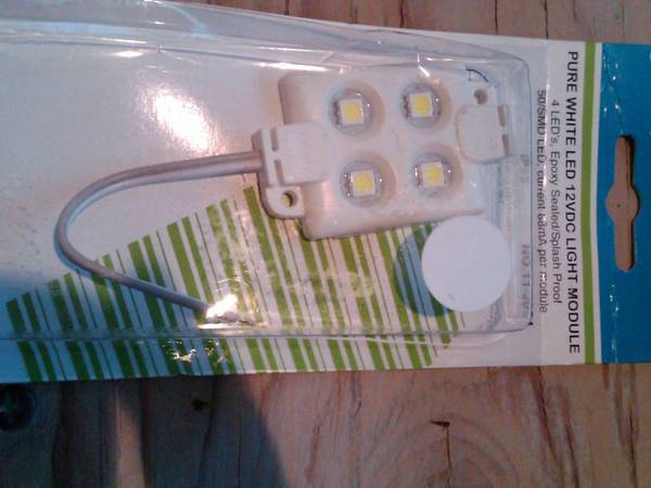

    Here are the type of lights I used, they come in two sizes, the three LED pod (which is the ones shining into the Hellas) and the four LED pod, which you'll see where I mounted those in a sec. Some of the pics are from another project where I installed lighting under the hood in white LEDs, the color is different but the parts are the same.

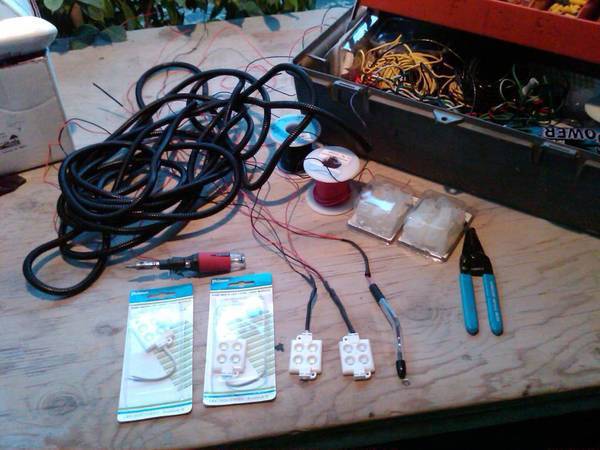

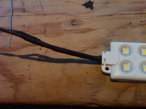

    My electrical kit, I cannot say enough about the little Radio Shack butane soldering iron, absolutely the best 25 bucks I have ever spent. The best part is the blowby from the torch head heats the shrink tubing up really well.

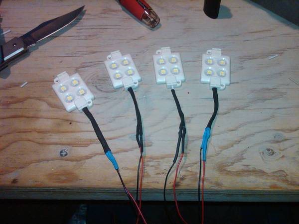

    separated and stripped the wires to be soldered
    after soldering I slid the shrink tubing over each of the wires
    Then I slid a larger shrink tube over both of them to act as a kind of boot

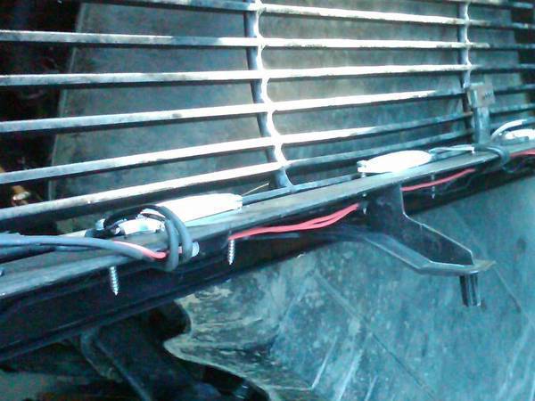

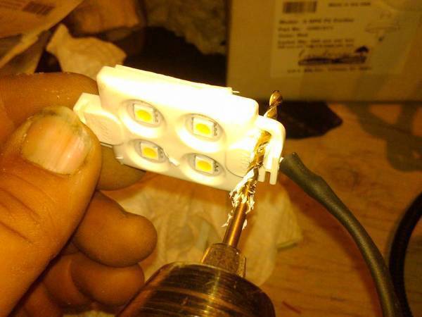

    Then I carefully enlarged the holes to accept a larger sheet metal screw, the screws I ended up using for the under the hood lighting were the ones you buy to hold downspouts together on your house, the ones on the grill are longer ones since I wasn't worried about poking a screw up thru the hood. I predrilled the holes in the grill surround and it worked like a charm.
    Here is where I mounted the three LED pods inside the grill. Now I have a billet grill which is flush mounted forwards. The billets themselves block the light from shining directly outward when you are standing in front of the truck looking downwards at it. If you have a deep dish Satoshi I am not sure how you would mount them for the same effect since the area where I mounted them behind the grill (on mine), would actually be in front of the grill on a deep satoshi. I would experiment with one of the lights by powering it up and holding it in different spots inside the grill area to figure out a mounting option. Me thinks it would be possible to maybe mount them shining inwards as opposed to upwards and that enough of the glow would catch the big light's reflectors? I'm sure this could be solved with at most a trip to the local hardware store for some brackets. I took a lot of time routing the wires and using screw in wire hold downs, zip ties and the plastic corrugate split tubing to make everything as neat and orderly as possible. I started with the ones furthest away from the power source first and soldered the lights together in a daisy chain as I went.

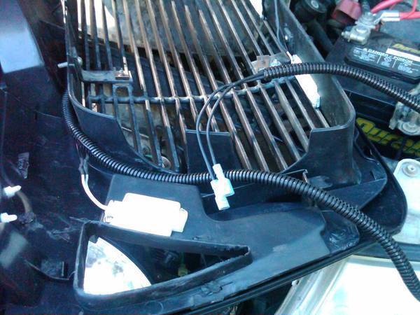

    I mounted two of the four LED pods on either side of the grill shining inwards to provide some additional glow in the radiator area. Again they are mounted in such a way that you cannot see the lights directly from the outside. Note the connectors on the wires, I did this so that the grill could be fully removed after unplugging the wires.

    and the finished product :)
