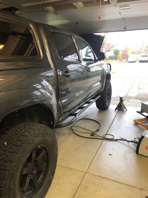

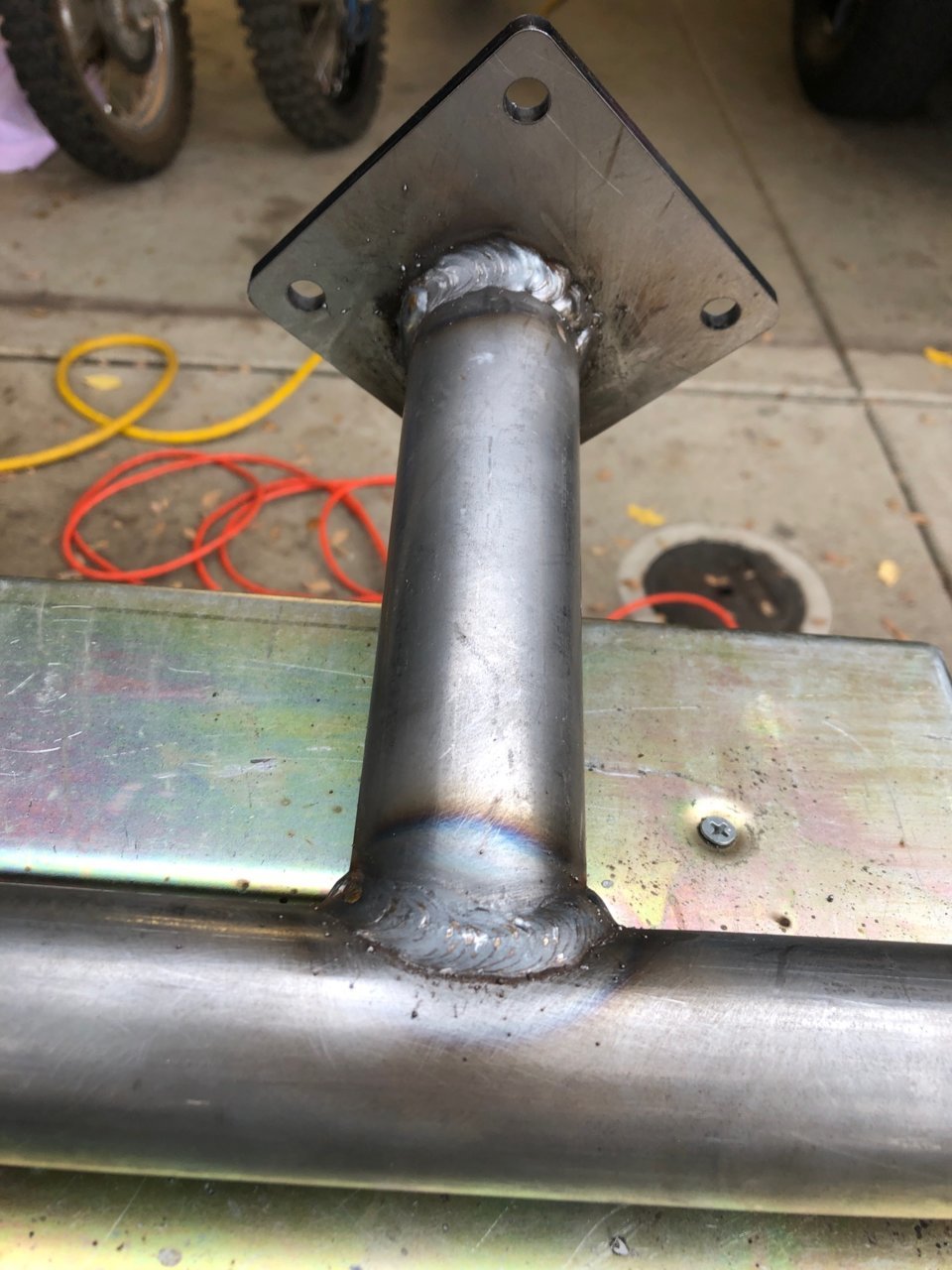

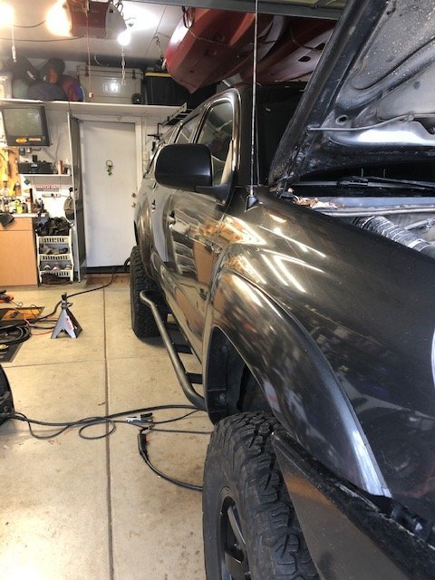

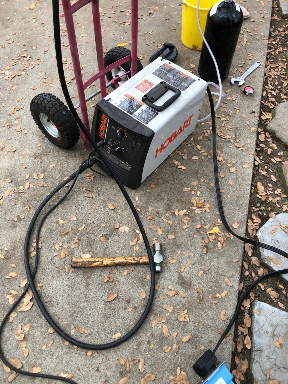

    I was finally able to borrow my neighbors Hobart 190 to start welding the sliders. This whole process has taken longer than I thought but I am learning a ton!
    This was my first time welding round tube and my welds weren't great, although this Hobart covers a lot of mistakes.
    Onto paint and then finally getting them on the truck!

    Finally got the sliders painted and on the truck. I wasn't really happy with a lot of my welds but between the 4 sides and the plug welds they're not coming off and that is the main thing. Its been a great project and I've learned a ton. Time to start on a high clearance rear bumper.

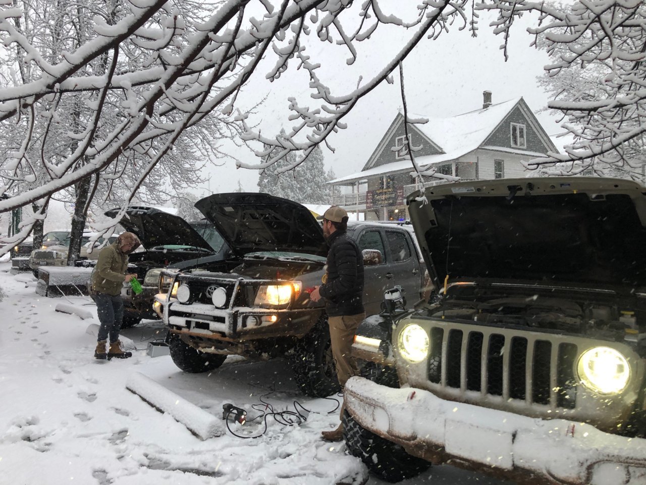

    Ran up to Georgetown for the day with @Big Tree Builds and others. It started snowing shortly after we made it to town and dumped the rest of the day. Lots of cool trucks up there. We had a blast making fresh tracks in powdery snow! It was pretty much our first time off-roading in the snow so we took it easy to begin with until we were comfortable, then we went for it on some of the offshoots. Almost got stuck in a huge mud-hole that was up to my doors. Truck ran good and we were able to help some people who were stuck as we came down the mountain.

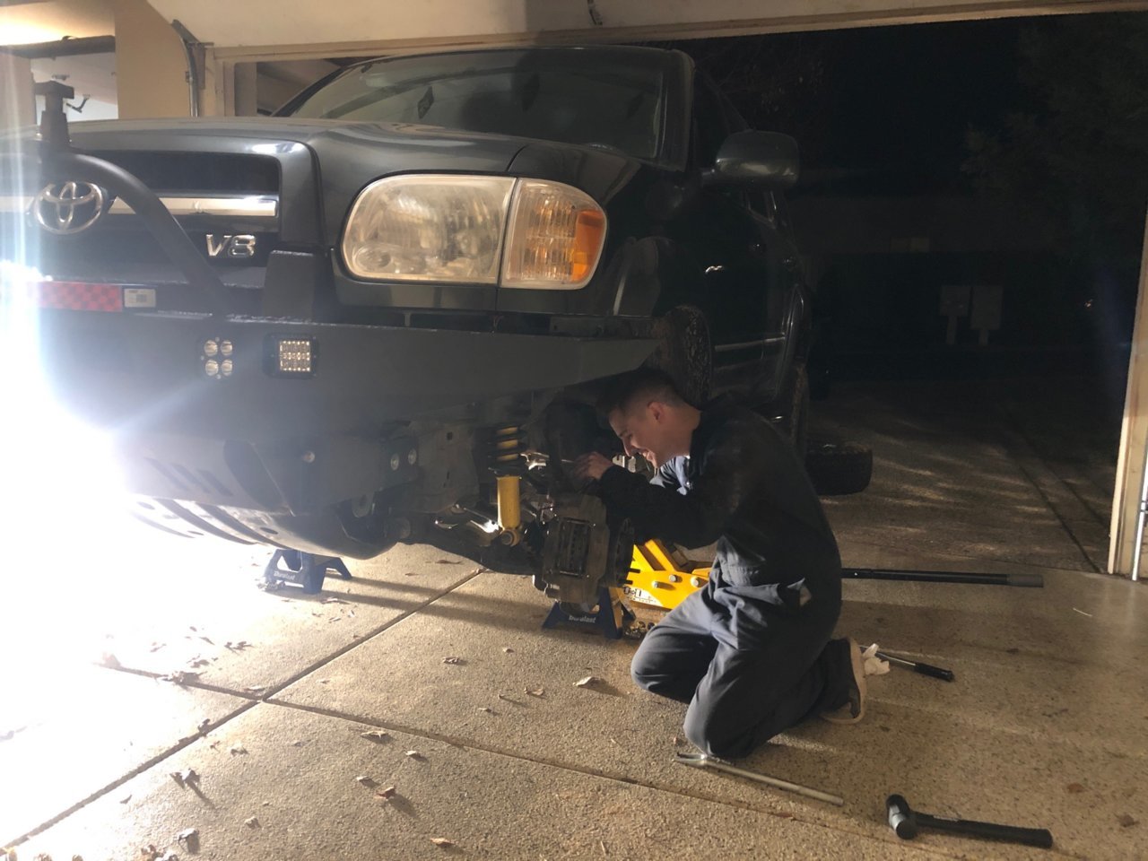

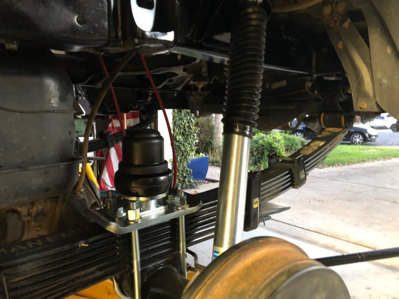

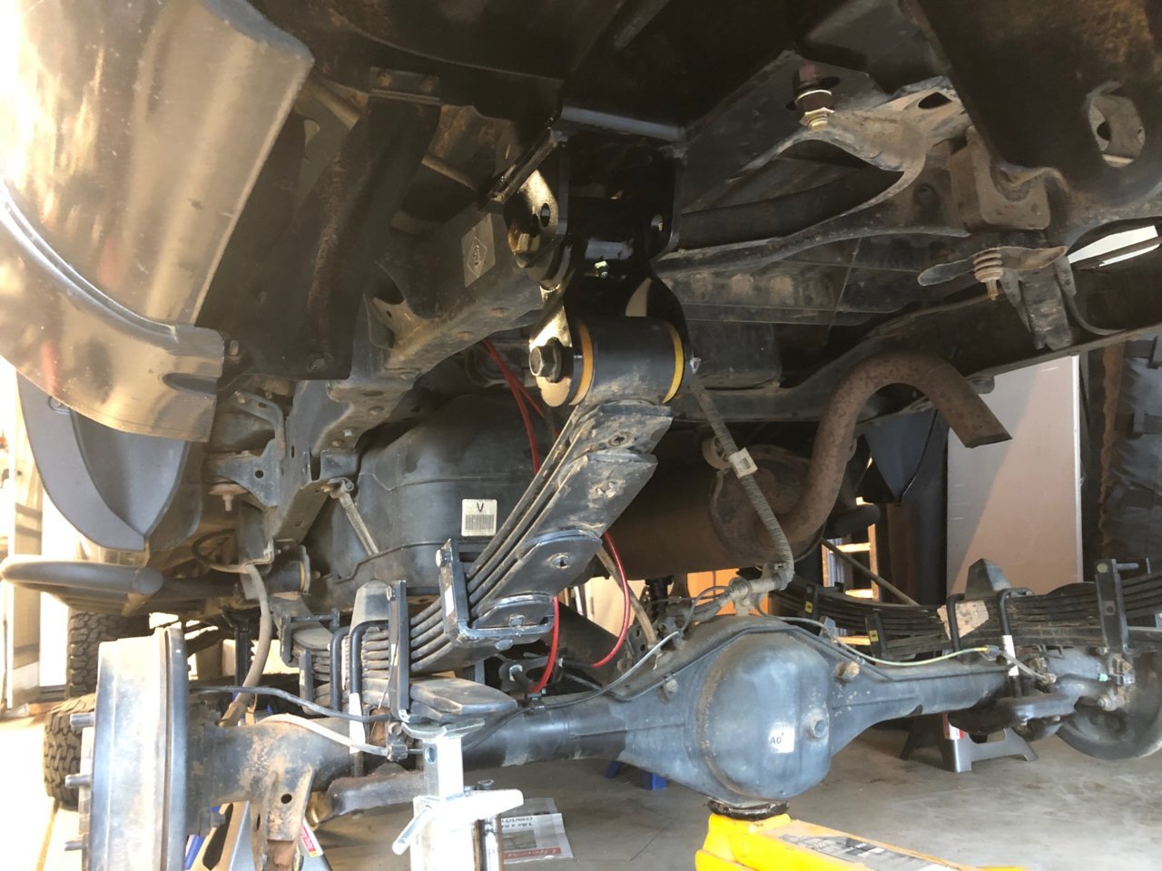

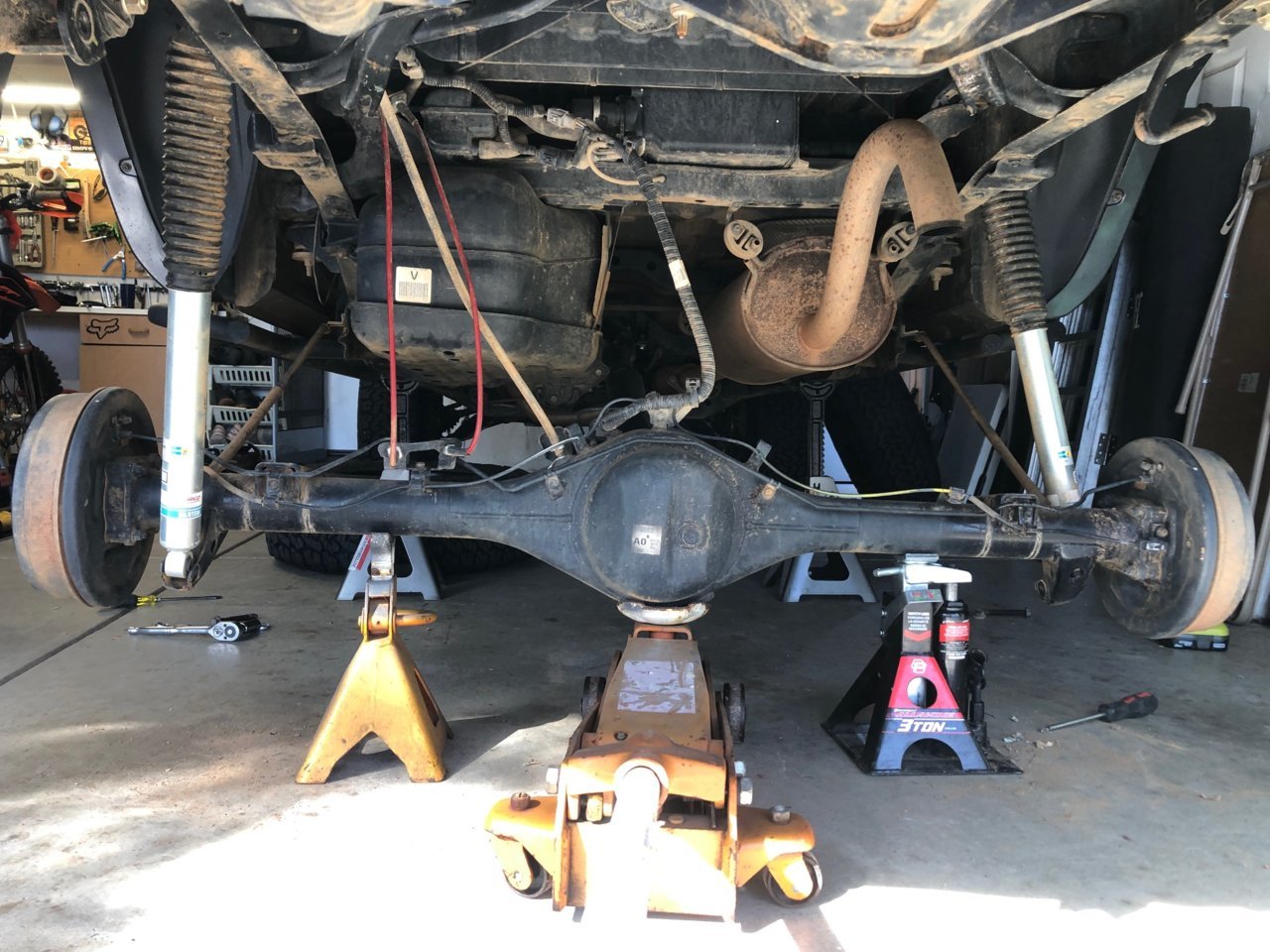

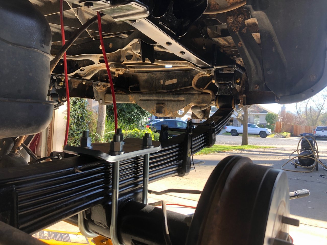

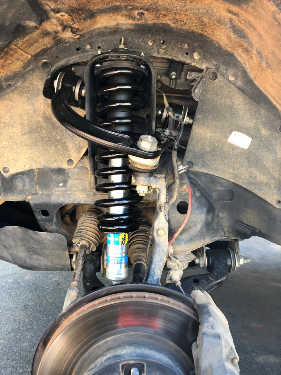

    Got the tacoma up in the garage this weekend. Extended brake lines, 4x Innovations shackle hangers, heavy duty shackles, u-bolt flip, superbumps, and Bilstein B110s are on the truck. The rivets were a pain in the butt with the tools I had but I eventually got them out in about 5 hours. I've been wanting to do this for a while, the rear feels super dialed and planted.

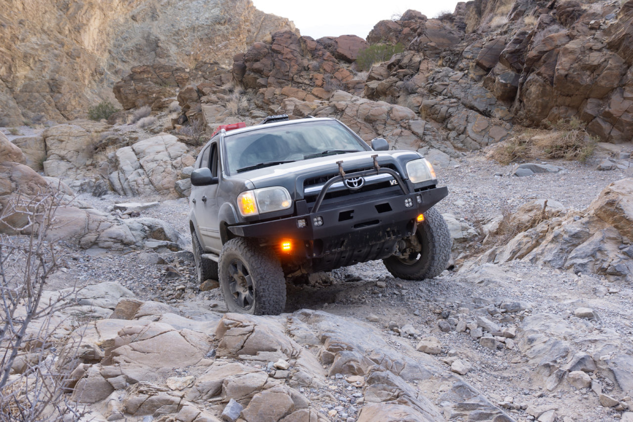

    Planned a trip with some friends to Death Valley, getting things in order I replaced my LBJs. Took my truck in for an alignment and found out my UCAs were toast. Said screw it lets go wheeling.
    Came back and replaced the UCAs. Then my friend realized his tierods were bad the day before we left so we put some Autozone specials in.
    Finally got to Alabama Hills just in time to meet up with our other friends for a full weekend.
    Got into the park and we were ready to hit some trails.
    We did Crankshaft to Eureka Dunes and then up Steel Pass before finding camp in Saline Valley. The Jeep was too low to the ground and bellied out a lot on the rocks, couldn't hang with the Toyotas LOL.
    The next morning we went to Cerro Gordo and got ready to head home.
    No real breaks except the Sequoia ran over its skid plate and he accidentally jumped it and ruined his alignment. DT was still running good which was good for me because I was headed back to Death Valley in less than 2 weeks!

    Got off work early yesterday, said screw it and took out a leaf of the HD Dakar leaf pack, also put a axle shim in. First time in over a year my truck has no vibrations and no axle wrap!
    Took me about 45 mins to get the leafs out since I've done it so many times. Overall it took me a little less than 4 hours to get it all done. Still measuring at about 2.5 inches of rake but I don't mind it. The truck has never driven so smooth, super happy with it overall, everything super budget but very plush and decent travel for essentially stock suspension.

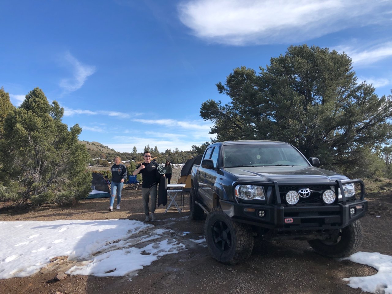

    Did you pull the “traditional” 3rd leaf out of the pack or a different one? Are you currently running the 887 with the arb bumper? Any pics of ride height and hub to fender measurement? Thanks!
  10. Mar 17, 2022 at 8:31 AM
    #50
    acdubstaco
    acdubstaco [OP] Well-Known Member
    Aug 21, 2020
    #338368
    192
    Adam
    NorCal
    2011 TRD OR
    Yea I pulled the third leaf down, I almost pulled one of the overloads too but decided to keep it in for when I am hauling dirtbikes, and I'm glad I did. I do have the 887s with the ARB bumper, no winch. I don't have any pictures at ride height or measurements right now but I can get some today.
    The 887s with the ARB bumper ride really well IMO, especially coming from the 886 which was too stiff for me. The ARB is coming off soon and I am doing the Warfab chop kit with a 10,000 lb winch, I am thinking that setup will around the same weight or a little lighter.

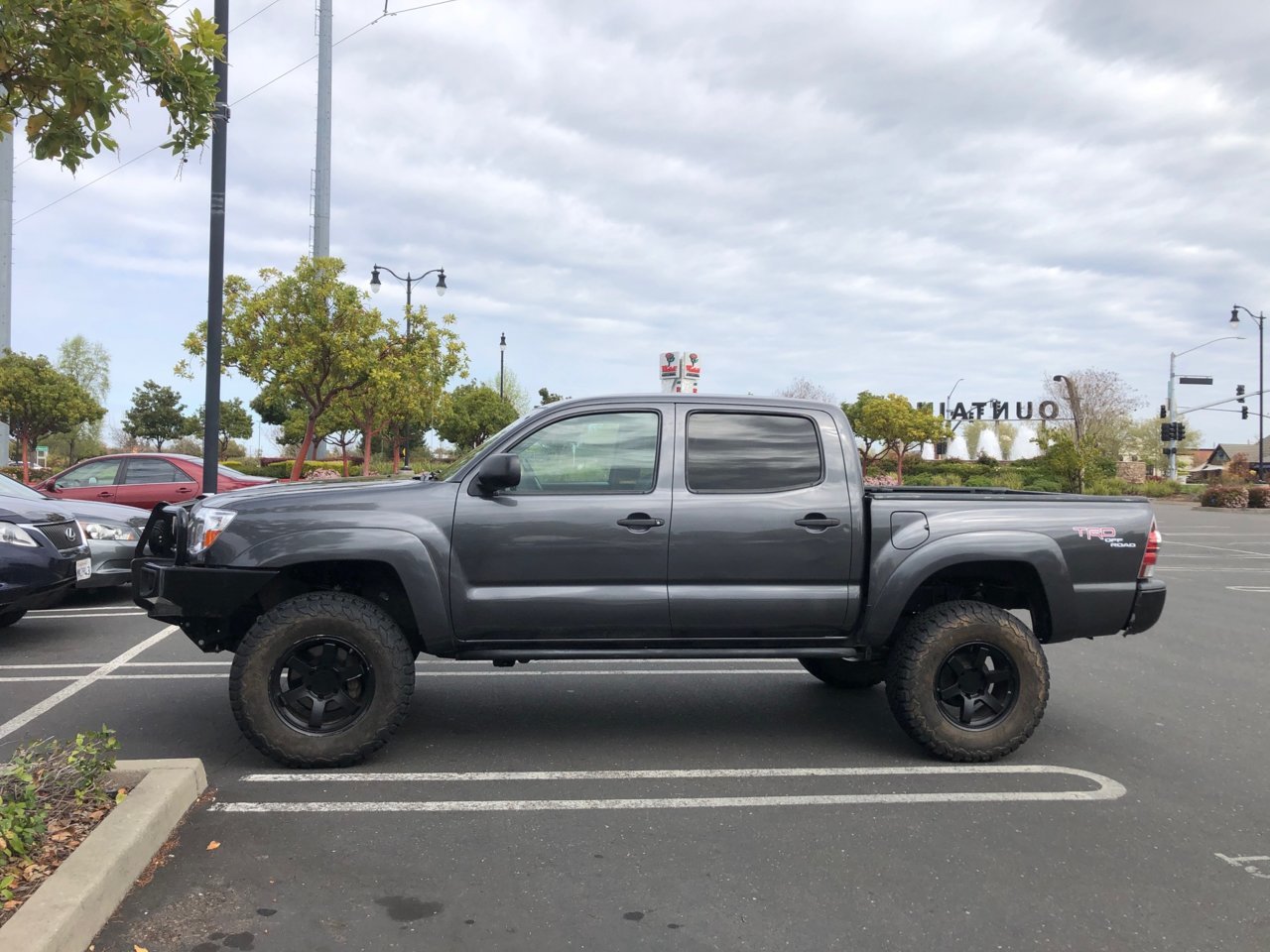

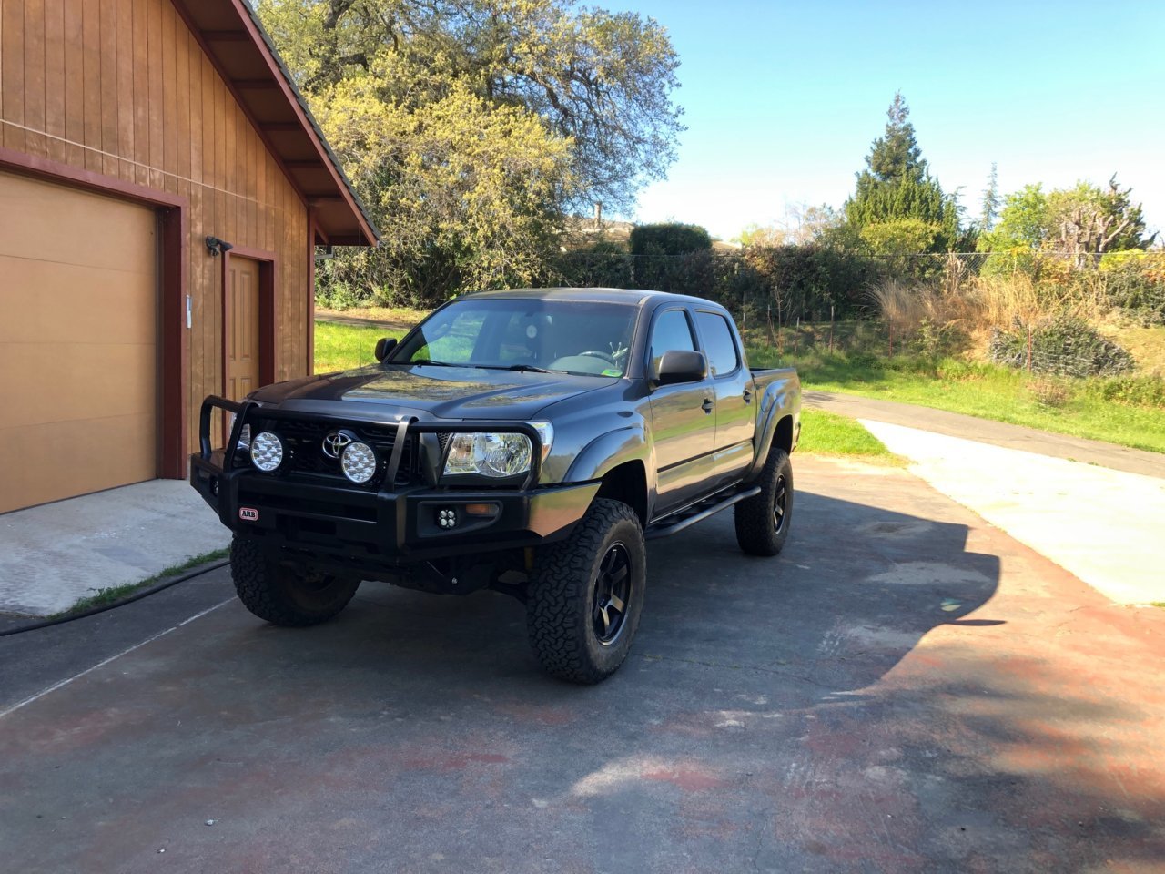

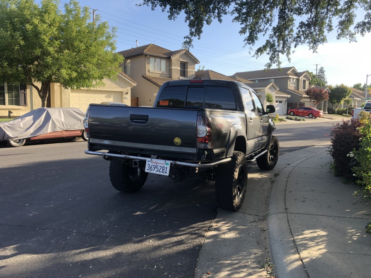

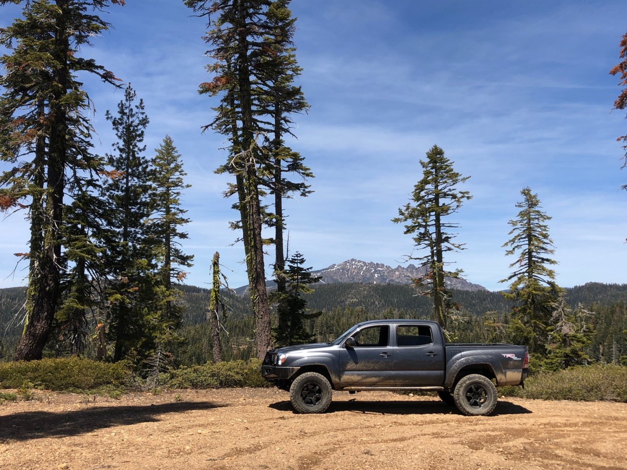

    Heres a pic at ride height. Rear is a little high but like I said I don't mind the rake. I'm also going to be making a rear tube bumper in the next few weeks so that should add some weight and bring it down slightly.
    Hub to fender is 23.5in.

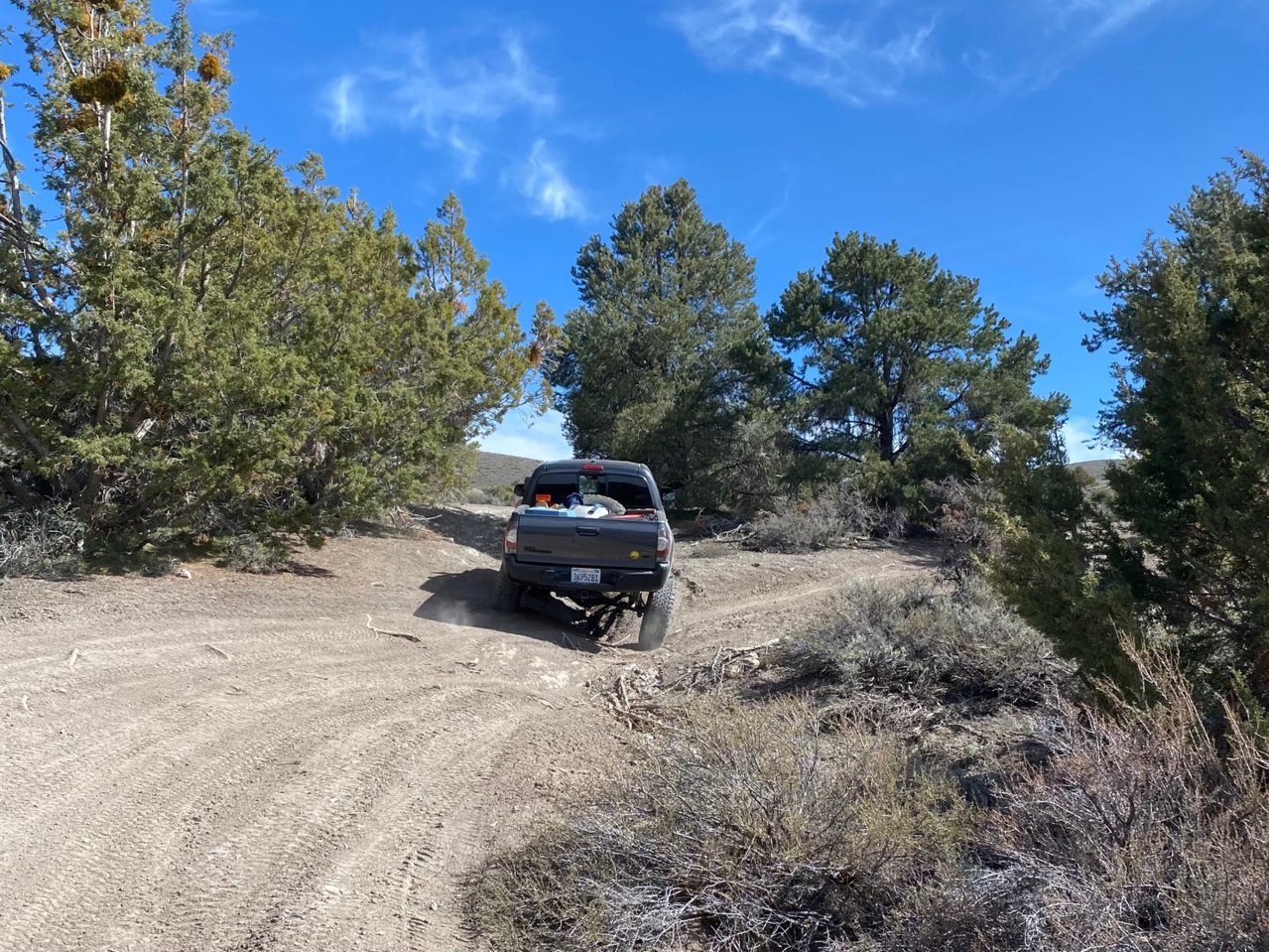

    Went camping in Nevada this weekend with some friends. The new 5100s feel 100x better off-road and loving the open bed with just a ground tent. Keeping it simple with some good people and loving it. KISS mentality.

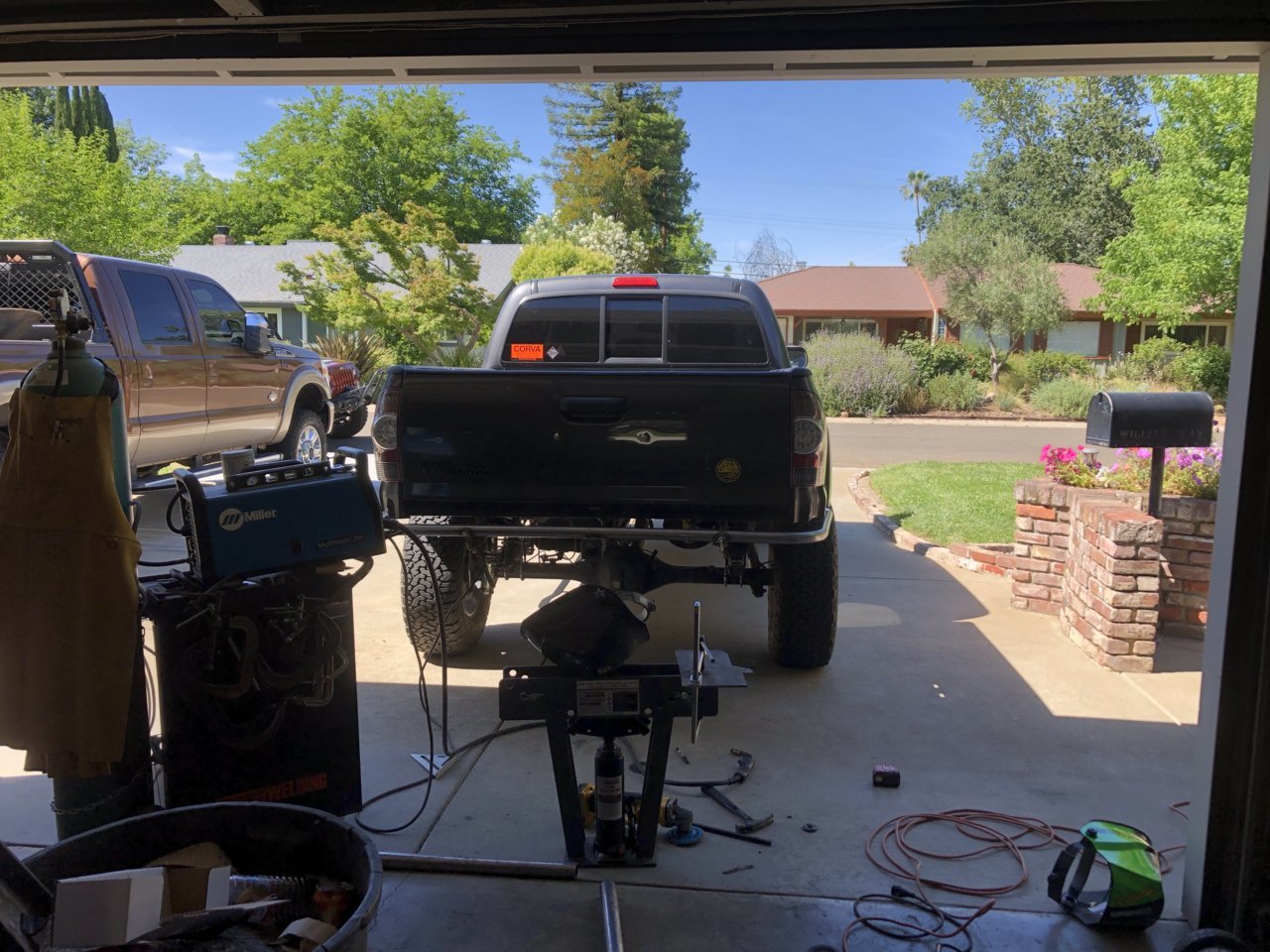

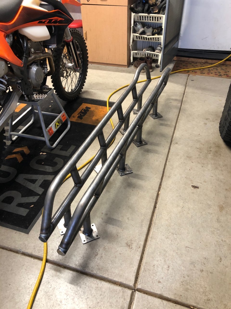

    Things are moving on the truck again after piling up some parts. Went camping this weekend. Came back and threw on some front bumpstops. Started on the rear bumper build, cut the bed and got some numbers, the tube bender we were using was kinking the tube bad so outsourcing the bends this week and will wrap it up this weekend.

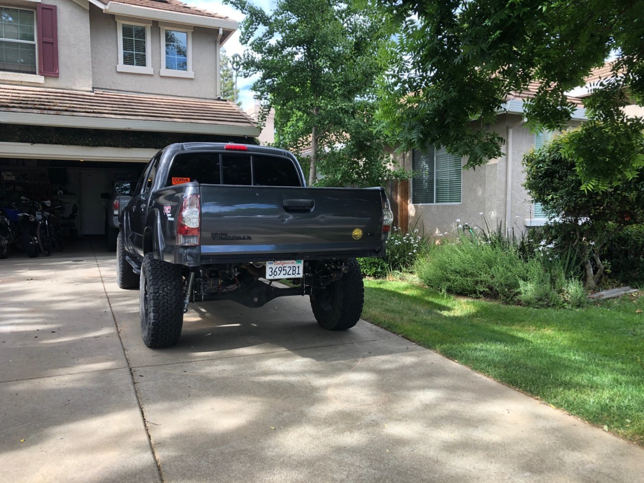

    Picked up a crash bar and cut it up to make a mini bumper while I wait for my chop kit from Warfab. Also wrapped up the bumper build yesterday, just need to paint it.
    Truck is starting to take the form I want: simple, cheap, and effective. Function over form.
