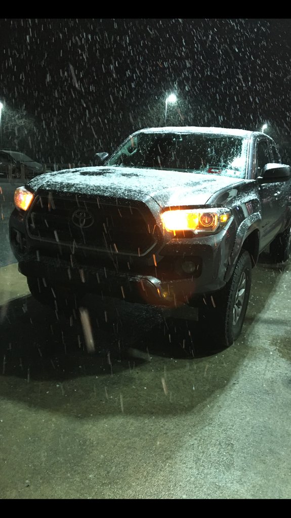

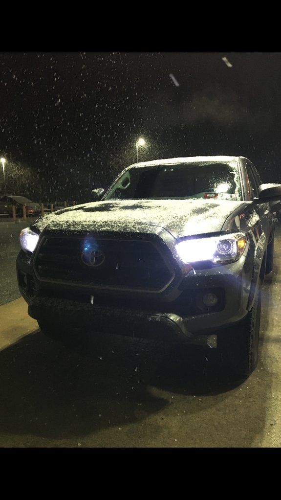

    SR and SR5, if originally equipped with DRLs have a dual Filament bulb that use the high wattage filiment for the DRLs, when replaced with switchbacks will only run Amber until headlights are on. (The amber is the higher wattage of the two circuits)

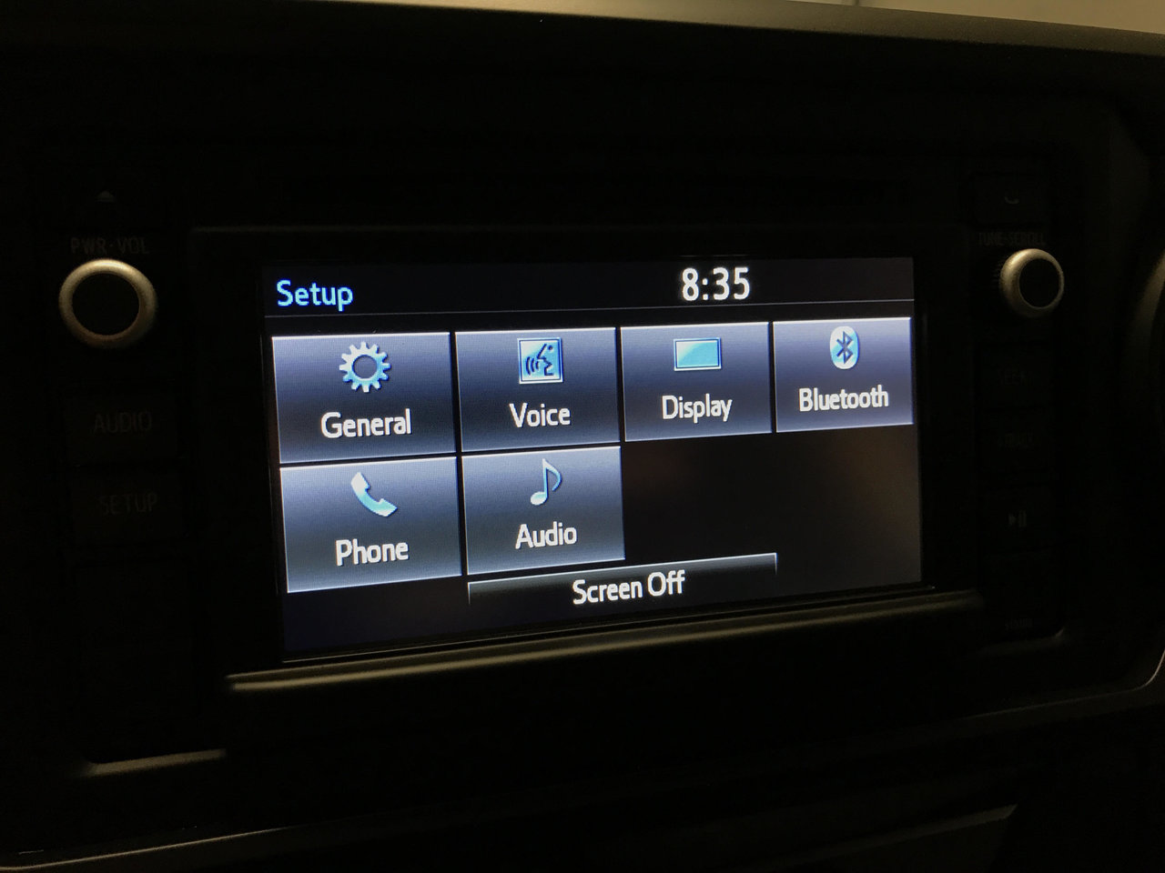

    Go into the radio menu, go to setup, vehicle, light settings, and disable DRLs.
    They will now illuminate white with the parking lights, and headlights, then flash amber, then back to white when the turn signals cancel.
    Setting the stalk to DRL mode does nothing anymore, but switch up to parking lights and you’ll get the white running light you’re looking for.
    Forgive the snowy gas pump photos from last January when I realized this trick. Lol

    That's awesome that you found that trick! I was messing with my truck tonight and tried to find those settings but I believe with my truck being bottom of the barrel trim I don't have the right head unit. If I remember correctly the SR has the plain "entune" while the SR5 has the "entune audio plus"
