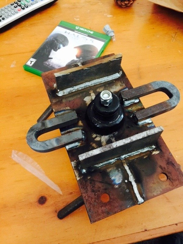

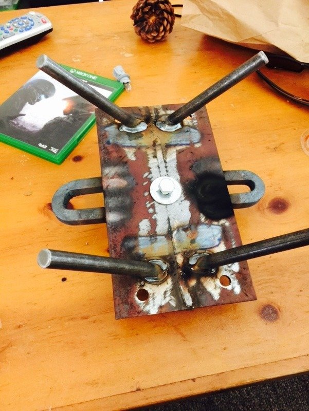

    This will be my first time doing a clutch, and Ill be doing it by myself most likely. So I threw together a transmission fixture for my little autozone jack. It looks funny but I think it will work:
    F39F497F-9096-4E49-B9A7-FA4320AD2476_zps_a4be93d3312ee87240dd5b3986edf8fc3abd0c18.jpg
    AA6817AD-0CD8-46D7-A7E1-2842468061C3_zps_ae00b73aefde564cc31b424a75a7850cdc55e015.jpg
    The hooks on the sides are so that I can run a strap around the tranny, advice from my buddy who is a mechanic

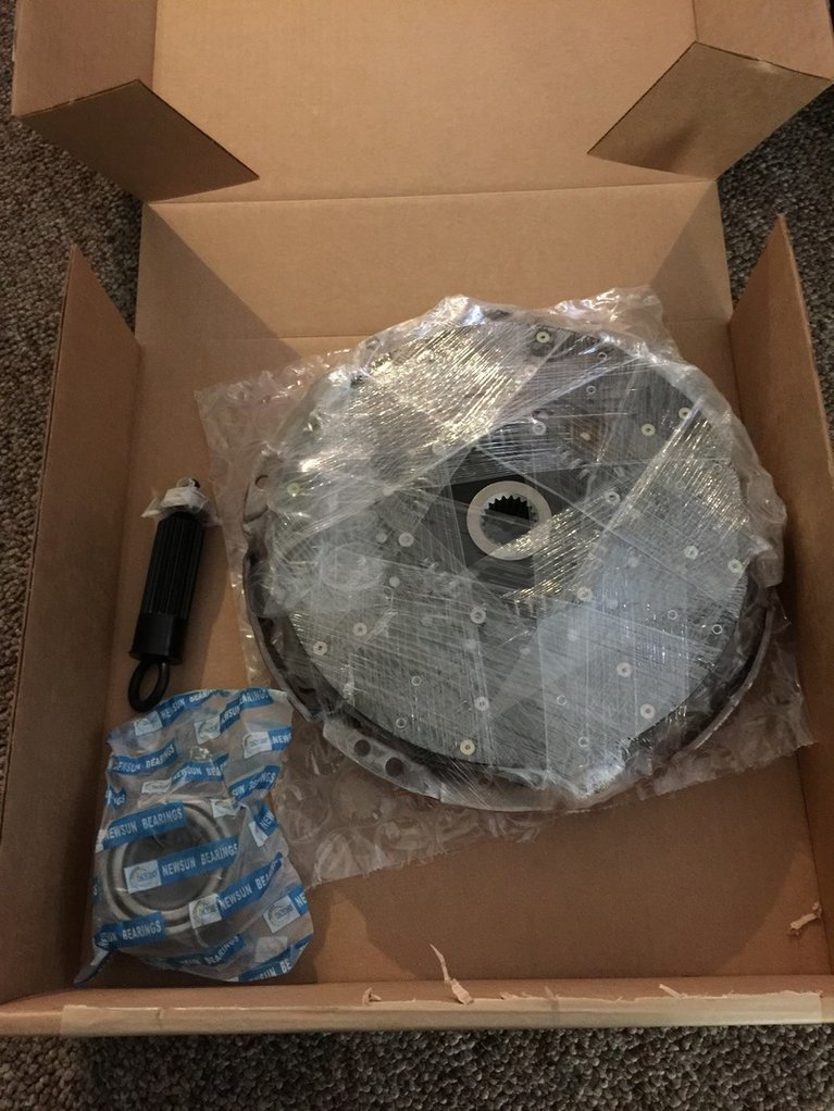

    The LCE clutch just came in! Planning on throwing it in tomorrow...
    10DA659E-2E3D-49A8-9010-11FD4003E549_zps_8c2b43295eb7dadba55d5e621a818fd323403594.jpg

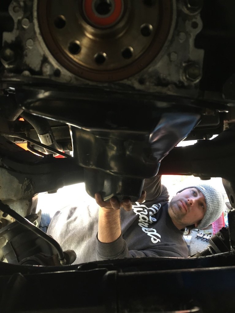

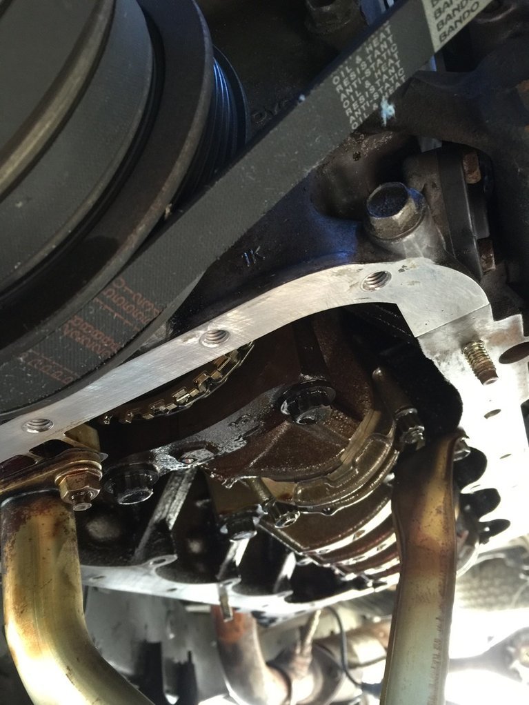

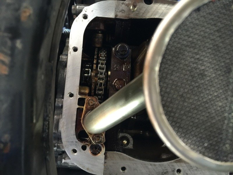

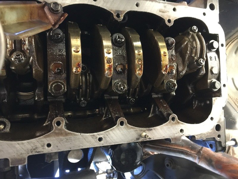

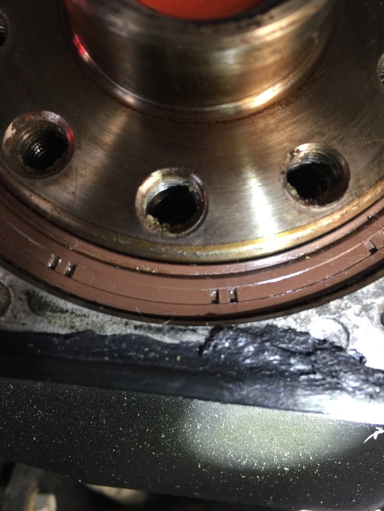

    Well the transmission jack worked really well. I did the oil pan seal and replaced the clutch. The tranny did NOT want to separate. Ended up being a slightly corroded dowel on the top of the engine. I had to take the hood off and use a chisel with a 2 food extension (duct tape), whacked it hard once and the tranny popped.
    Heres some pics of the oil pan removal and prep (romoved bolts from lower ball joint on drivers side, popped out cv axle, dropped diff and was able to get oil pan out. Mild pain in the ass)
    09B38FE6-1914-4C06-90A8-66A79D7A54AA_zps_5aa37a62c692fb7a5dbea1650128b194938e15c9.jpg
    36900539-0544-4760-BDB2-4225D4B0D19A_zps_65bc91d40289c62e6f9814ad25030ba88d099902.jpg
    166961A8-FE04-429B-BBE7-B602E071D3B6_zps_b064d70d1489db9eb63fce57d38d57a372003cd3.jpg

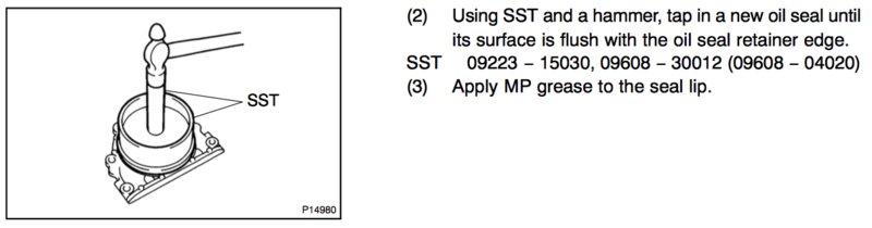

    New rear main seal, hoping it works, i pressed it in until the seal was flush withe the inside of the chamfered edge on the housing...

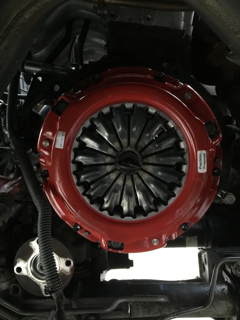

    LCE Pro Clutch
    5FE0D768-7AFC-4772-AA41-012B1CAAF259_zps_846d9873f0da142b24f4ea272e9cb175b1b7c474.jpg

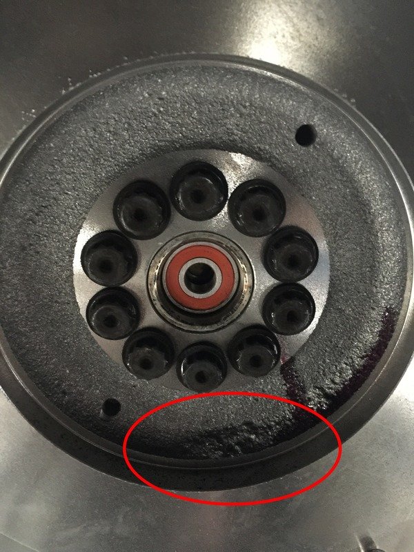

    Forgot to mention, when i went to throw in the brand new Luk flywheel, i noticed there was a considerable casting defect. I hope they balance and inspect their flywheels prior to shipping because if this thing vibrates....

    Drove the truck today. The LCE pro clutch is much tighter and definitely grabs quicker than the old clutch. the surprising thing is that the clutch pedal seems a little easier to push in than before. I found that this is common for other Pro clutch drivers.
    No vibrations or anything from the flywheel, overall success

    I have no need for a clutch in mine, but thank you for these pics. I had always wondered if it was normal to have those two studs sticking out of the crankcase for the oil pan. Looking at them on mine, i wondered if the previous owner striped the threads and that was their fix.
    Curious, what did you use to lock the crankshaft when putting the flywheel in?
    Also, love that DIY transmission stand. Ugly as hell but 100% functional.
