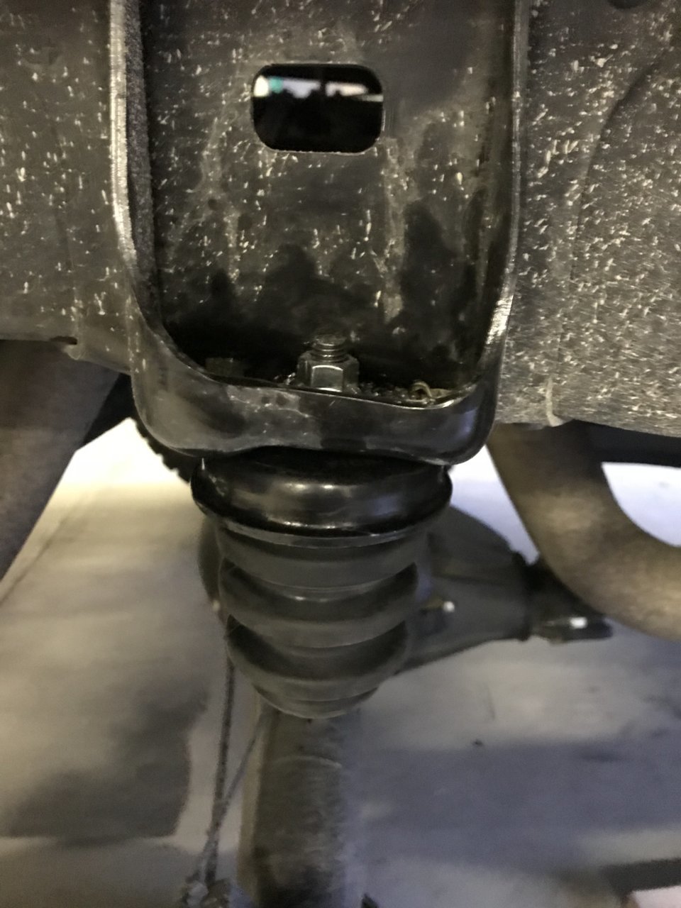

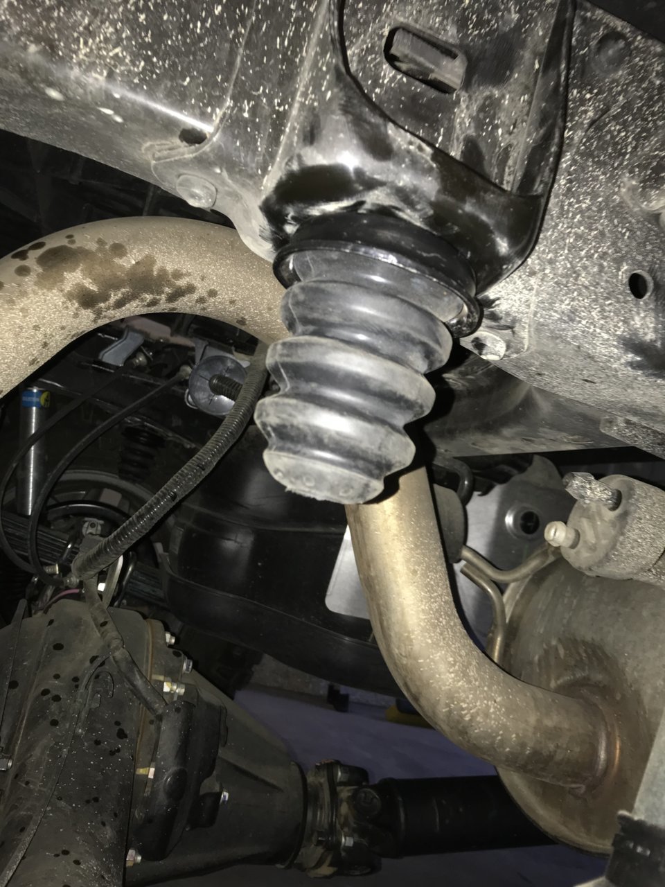

    5B1B8D98-DFB3-4563-8558-72BA087F1414.jpg 34662867-8161-474B-BF6C-3FE061D5B2ED.jpg 9CDCB1D9-C764-4911-914C-C3D035E730B3.jpg Well I got the Dormans mounted up. They are more of a firm rubber than foam but softer than the stock bumpstops. Since I got longer 5125s maybe these will keep the shocks from bottoming out. I ended up not doing the flip so I still need to come up with some sort of strike plate.
    Leafs are CS047R that I found locally never mounted for $350. I removed the top overload and got 2” of lift.

    How did these end up performing?

    I did but unfortunately my shocks are too short so I'm still bottoming out on my shock so I still can't tell you if they work good or not lol
