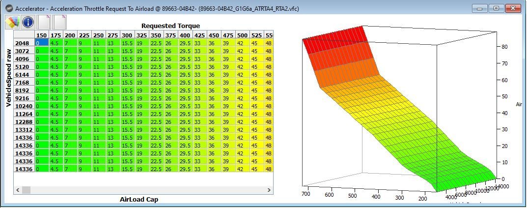

    Yeah and let's not forget I'm running all six gear maps and you are effectively running one.. so that's going to make a difference!
    Here's my latest ATRTA edit.. you can see what I'm trying to do lol:
    ...and it allows for good control in 4lo, as long as, again, your gear maps aren't retarded.

    Yep. Some days I envy that, and others, I am think that I am happy with the STMP. Still, there is always the question of all having all gears but 5th and 6th on one map and those on an separate "efficiency" map. The counterpoint is that I can accelerate well enough in 6th from 35mph on up. Having good torque in the OD gears works well.
    Yeah. That looks very reasonable, if it is a primary throttle table. It seems to feel like one, but with this ECU, it is hard to know for sure.

    Ok, so there's two parts to the on/off throttle stuff in my case:
    1. Low speed/high gear driving is good for me now, but I did have some on/off jerkiness unless I was super deliberate with the pedal. This boiled down to my PTET primary map zero column being too negative (I like more engine braking rather than less) in the 1000-1500 range. I think I've got it at about -6.25 right now, which seems perfect for me. I think stock is around -5.0?
    2. Highway driving in 6th 60-65mph. I had this pattern of over acceleration to maintain speed, let off, decelerate too fast, rinse repeat. The range of pedal travel this would happen in was very small. Turned out I had to change the ATRTA to what you see in my previous post and put PTET G6 back to a more stock looking setup. It's very smooth now, although some wouldn't like how much you need to push the skinny pedal I suppose.

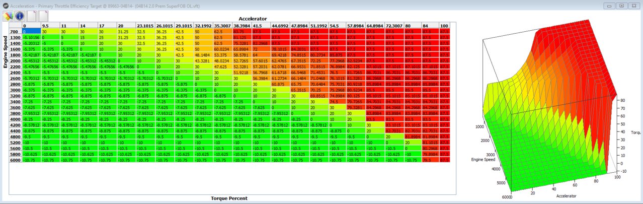

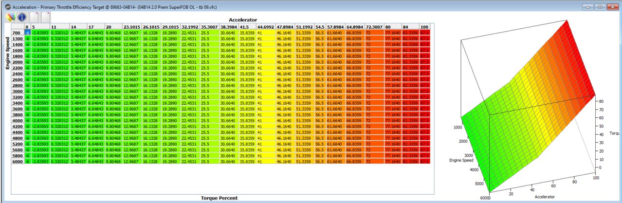

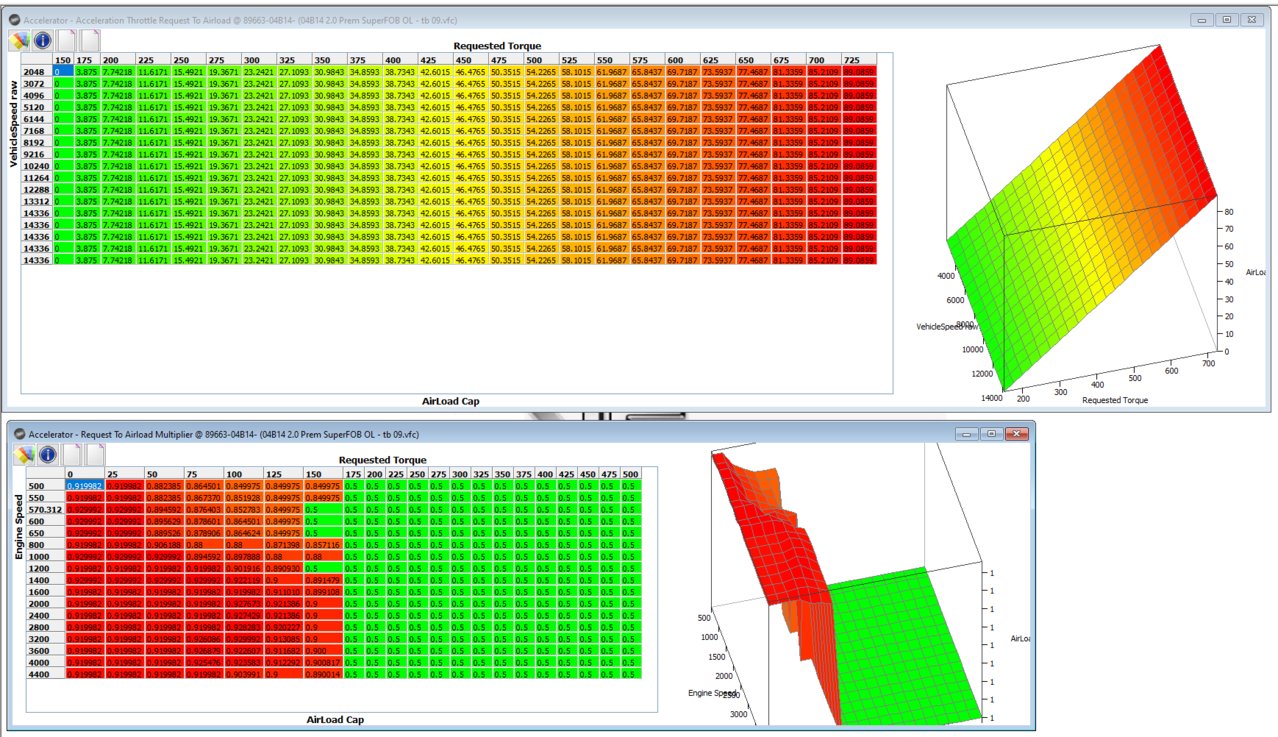

    Oh yeah. Times were different pre-2.0.
    I'm right there with you:
    Stock was all over the place:
    That was the big deal with my last tune. Using all of the pedal travel was the thing. It was more deliberate and took a while to get used to but was perfect for me.
