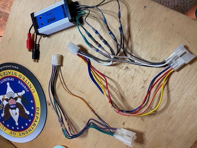

    Been working this afternoon on the harness. Can you tell by the picture if it looks correct?

    Spot on

    You can actually forget about using the purple/green harness since your not doing anything there. I recommend getting some tesa tape too, wrap the harness with that to keep the wires together and prevent snags.

    Yeah what they said lol. Never even crossed my mind. Set the purple/green piece aside and save it for later. It’s useless in this scenario

    I made that mistake just like 2 weeks ago when I had to put my OEM headunit back in with a lc2i... I wired up the rear speaker harness only to realize I didnt even need it.
