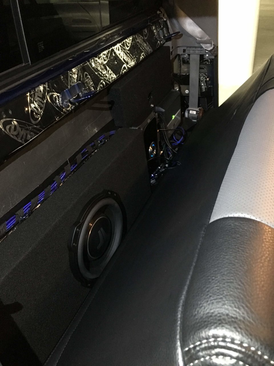

    I finally got everything installed except the shelf. I'm going to need to do a couple cuts on the shelf to prevent it from rubbing the back of the seat, but otherwise it's complete!
    I'm going to come back in a week or so and clean up the cluster of wires. I didn't have enough energy to organize them when I got everything bolted, but the system sounds great. Getting the subwoofer off the VXI allowed me to get more volume out of my system as a whole while keeping balance between highs, mid, low.
    When I was running the factory JBL sub off the VXI I had to turn down the gain on all of the door speakers and the gain up on the JBL sub in order to get a balance. Now I was able to run the VXI pre-amp out into the JL XDv2 & the VXI remote out into the XDv2. In the VXI software I routed the sub input channels to the pre-amp output channels & gave the pre-amp out a low-pass filter. I'm so happy the VXI allows you to route/EQ/crossover/time-align the pre-amp outputs.

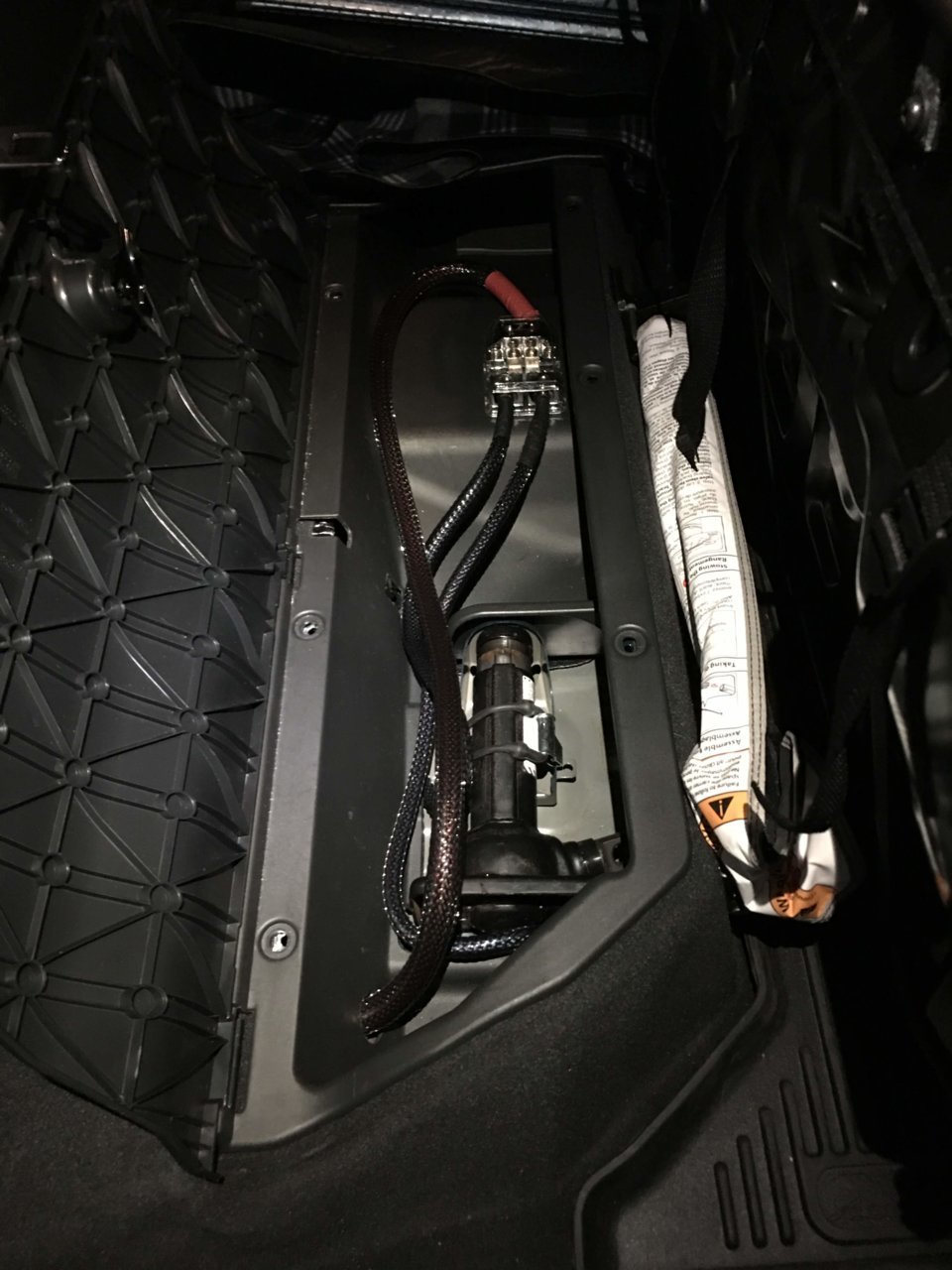

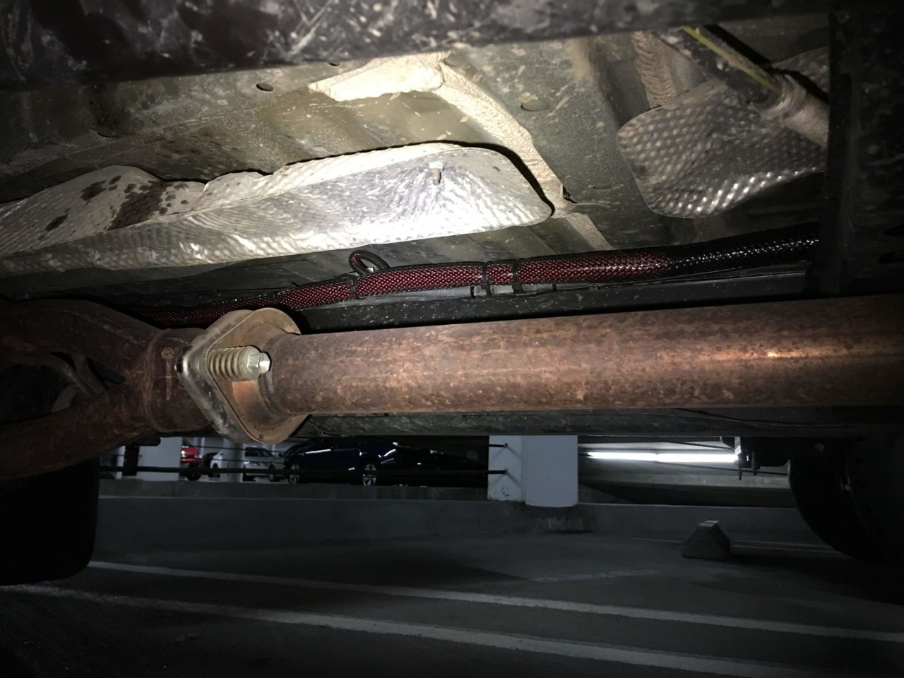

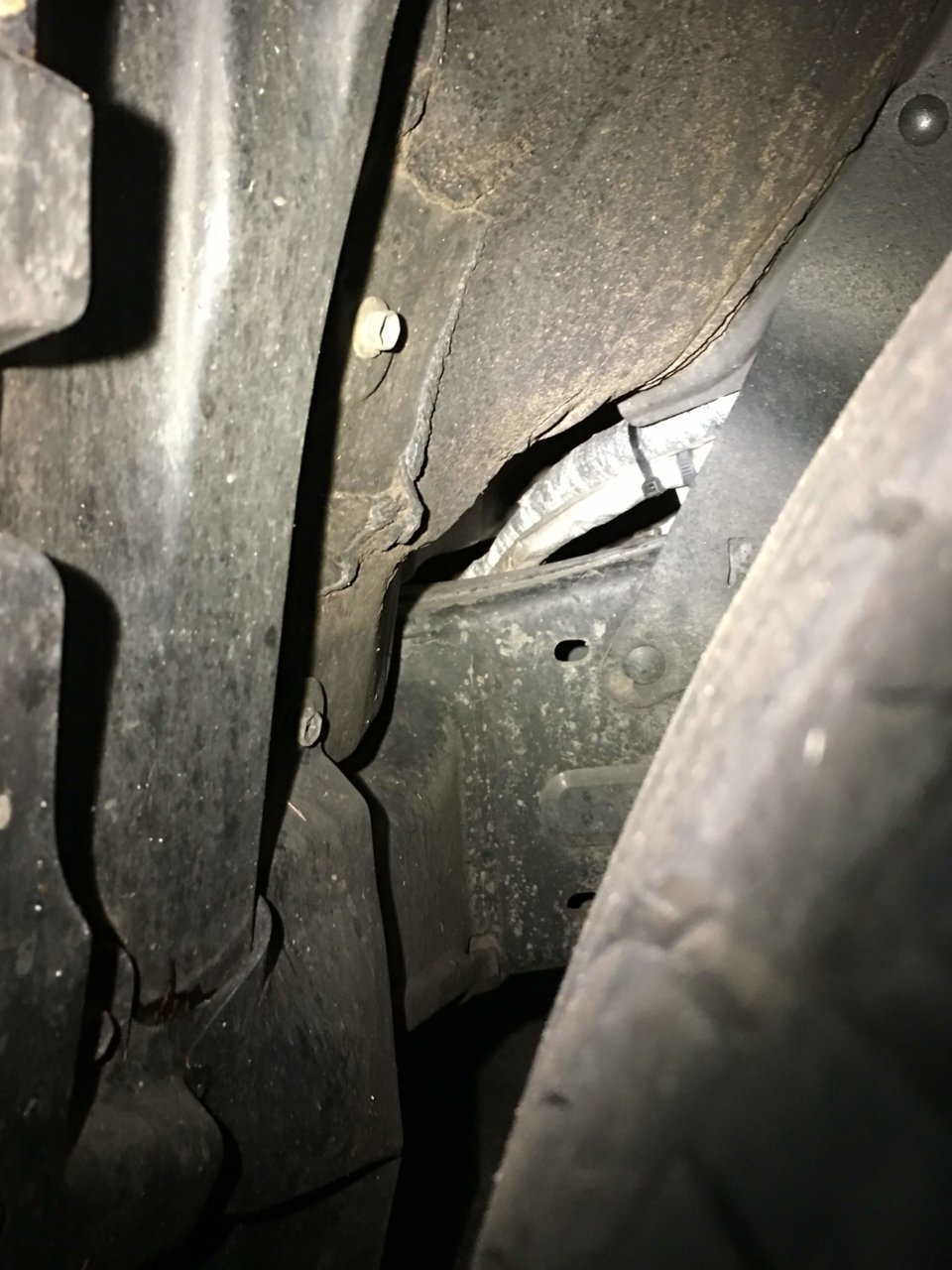

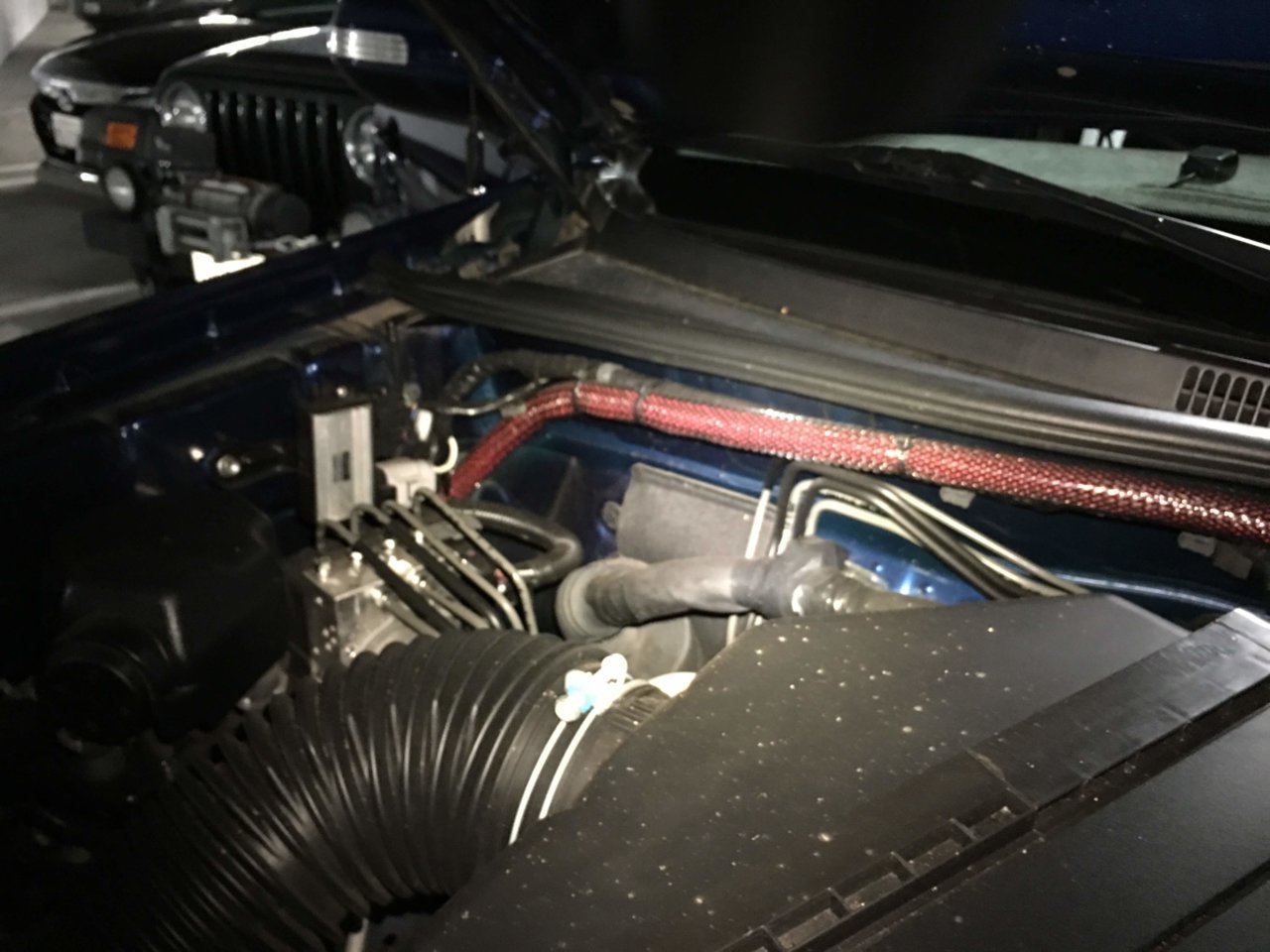

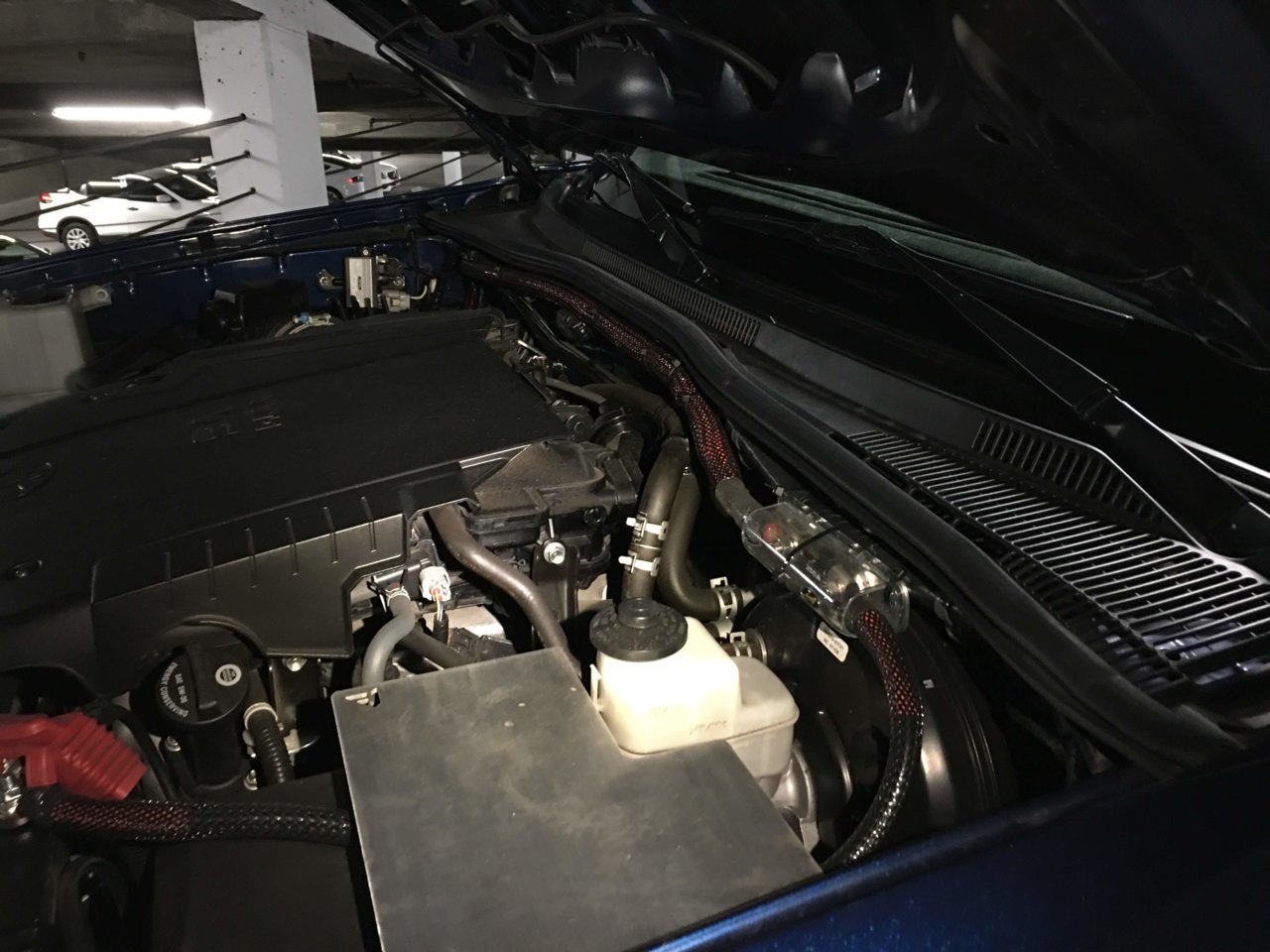

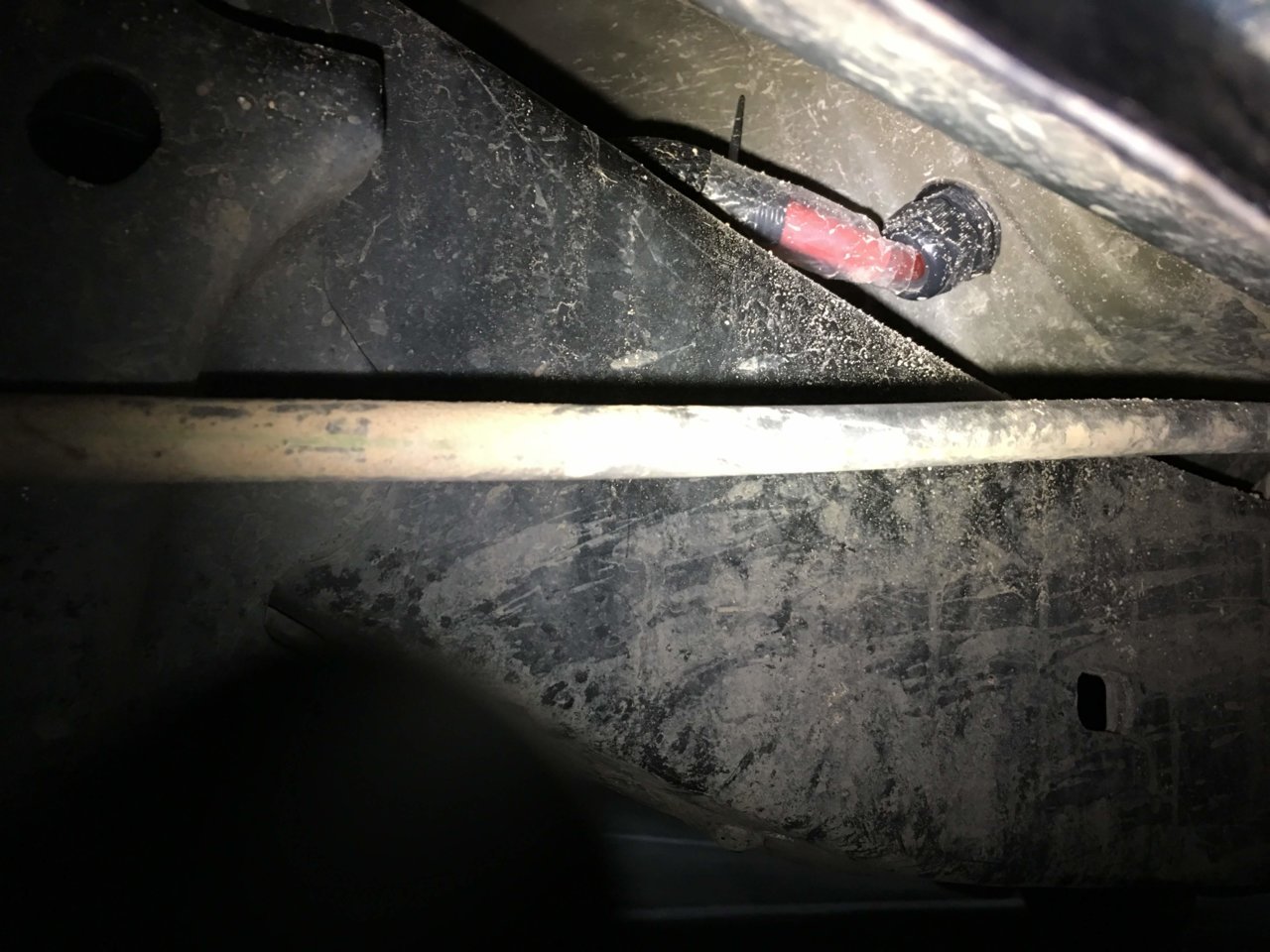

    I wanted to do an update about how I ran my power wire & grounded my amplifiers for another member so I'll do it here.
    My power wire is a 1/0. It has red loom covering it and then gorilla sleeve covering the red loom for extra protection. Fuse for 250A.
    I ran the wire down by a factory wire that passes over the frame between the passenger tire (behind mud gaurds) and the exhaust.
    This is inside the engine bay on the passenger side of the firewall. The wire runs down by the engine, but the heat shrink over the loom/sleeve marks the beginning of a heat shield.
    The heat shield is fiberglass covered in aluminum foil, you can find this stuff at most auto stores & jeggs in the performance engine area.
    You can see my big wire (covered in heat protection) running just next to a factory wire (also covered in heat protection). This is behind the front passenger wheel in the wheel well.
    I only used the heat sleeve for a little longer than the factory wire uses the heat shield, a little before/after. The wire goes back to loom & sleeve all the way to the rear storage bin. You can also see the loom I ran for my 12v reverse camera popping up above the 1/0 wire about half way. This is just under the passenger seat on the frame.

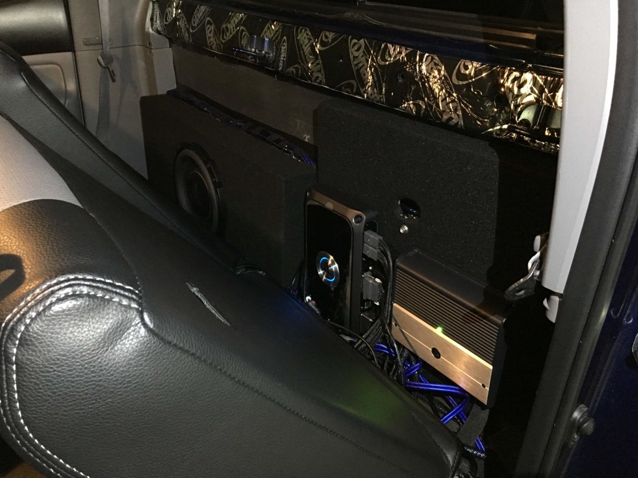

    Here's where I pass the wire through a waterproof grommet into the storage bin. This picture was taken just in front of the rear wheels on the passenger side, outside of the frame. You can see the parking brake cable running through the image for reference.
    Here's my distribution block. The 1/0 wire comes from under the truck & the two 4 AWG wires go to my amps. I have an 80 amp fuse on the VXi and a 50 amp fuse on the XD.

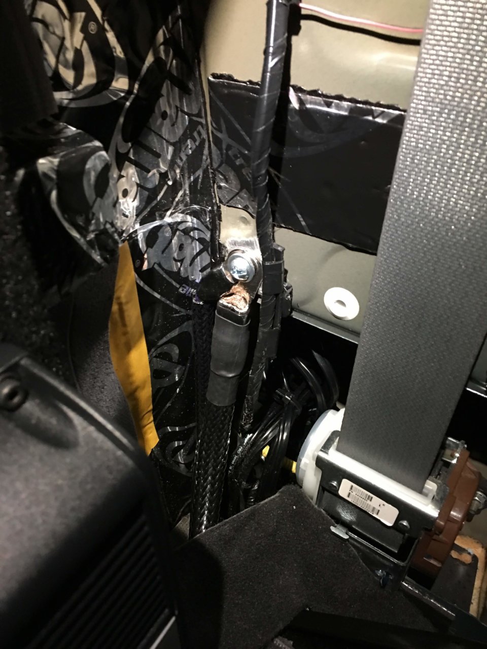

    I grounded both amps to the back left pillar. You want to make sure to ground to something that is structurally critical to the truck & I'm pretty sure all of the pillars fall under that category. I'm going to clean up all the wires near the amps in the next week or so.

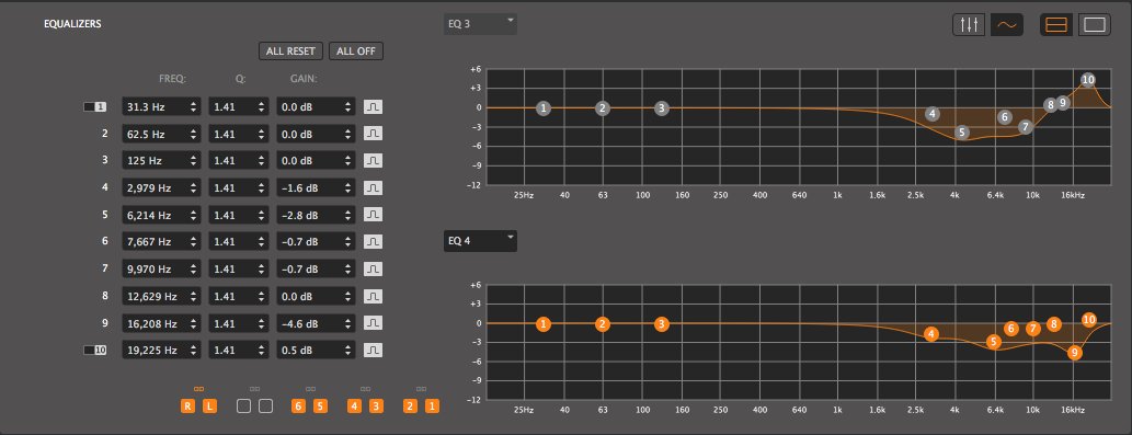

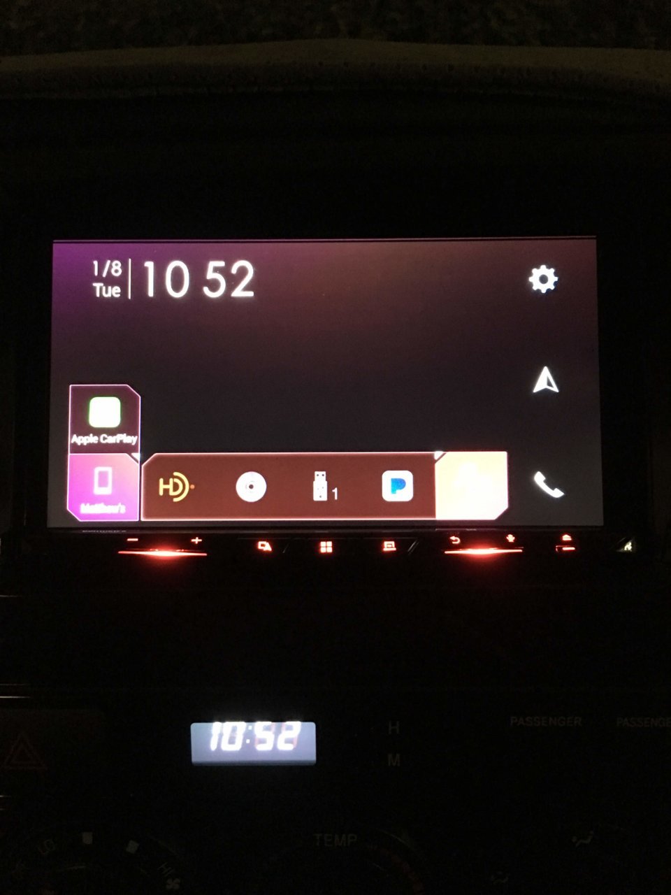

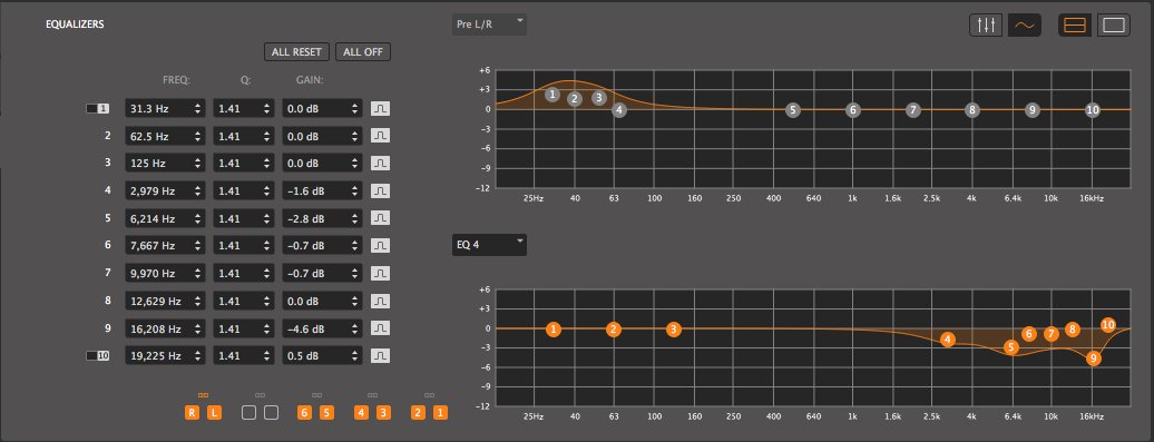

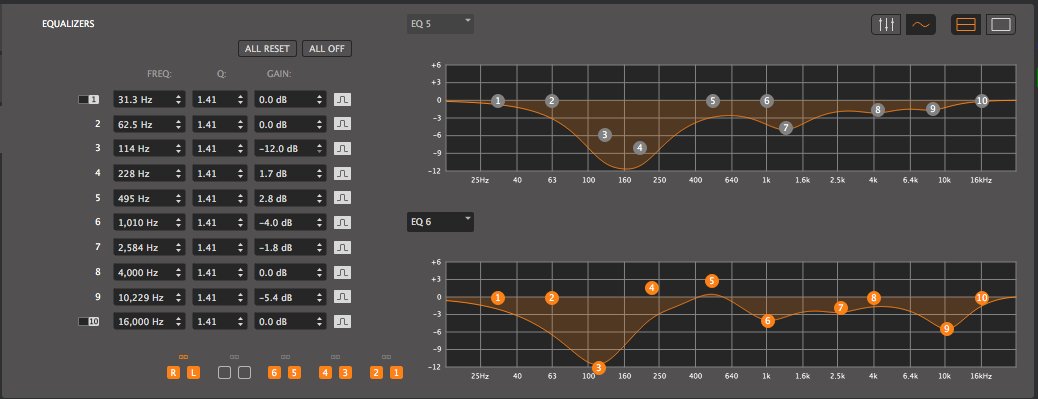

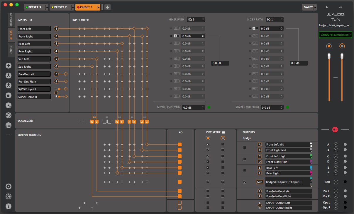

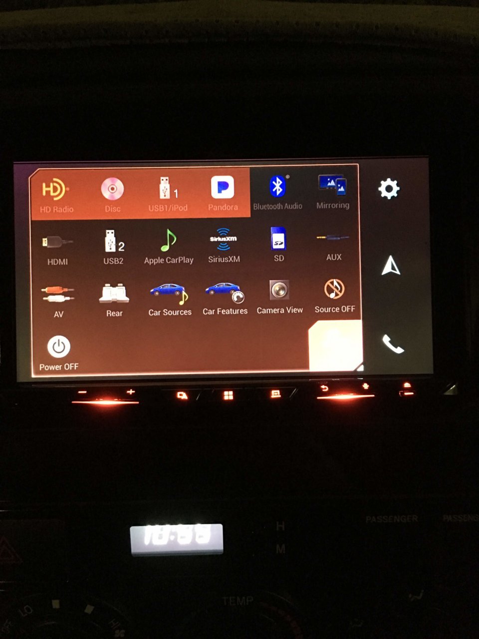

    Here's where I'm at today. As part of a warranty service for my defective 8200-NEX the installer I bought my equipment from helped me out by upgrading me to the 8400-NEX instead of leaving me without a radio for weeks while Pioneer tries to repair the hardware.
    I bought my gear here. They gave me a good price & they've been willing to work with me even though I did my own install. I think they have good customer service.
    The Car Stereo Company (Mountain View CA)
    Here's the 8400-NEX installed. It's faster than the 8200-NEX in most ways (boot time, response time, reverse-camera). The image looks higher quality as well plus I love the wireless CarPlay & Android Auto.
    I still need to test the Mirroring & my girlfriends Pixel 3, but everything else appears to work good! Had a little trouble getting my phone to connect to the wireless CarPlay. I had to set up the bluetooth twice in order for the CarPlay to set up, but it works good now.

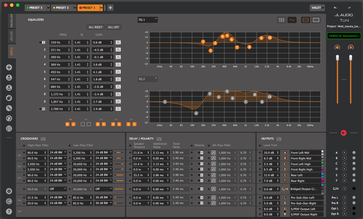

    I had the shop help me do some tuning. Hai at The Car Stereo Company left me with a much higher quality tuning & a much less harsh/sharp output. Here's the routing table.
    Here's the EQ's, crossovers, delay/polarity, & level trim. EQ 1,2 are the front left,right mid, EQ3,4 are the front left,right tweeters, EQ 5,6 are the left,right rear doors, and EQ L/R go to the Subwoofer amp.
    Front mid woofers left/right.
    Front left/right tweeters.
    Rear doors. left/right.
    Sub pre-amp out, front right tweeter.
    rob1208, DocME, rkilgore76 and 2 others like this.
