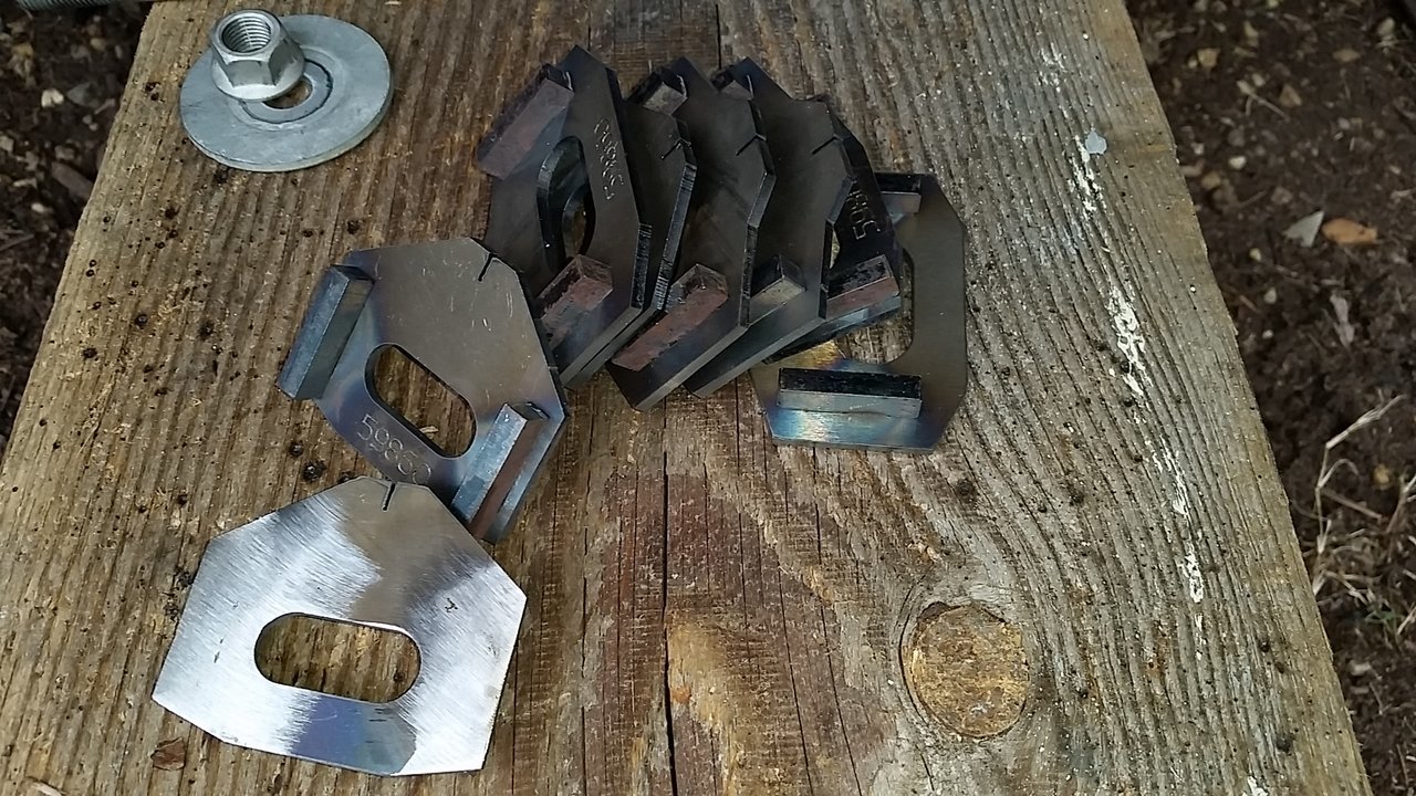

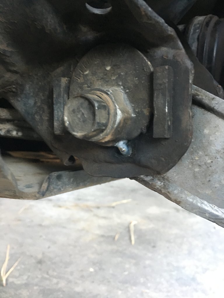

    Let's see if that keeps these bastards from rotating.

    Uhhhhh.....Are those TC cam tab gussets?.....If so, why aren't there beads on the outside of those tabs?

    I dunno. Ask Aaron.
    It's really not gonna make a difference considering the valley weld on the back side.

    You're in the middle of adjustment range anyways, might as well cut some solid mount tabs and be done with it. I haven't needed to touch my alignment in over a year. Only kicker is the needing a hiemed upper arm...

    beat me to it

    Guy who did the welding said this was all that was needed and some technical shit about heat and metal and not doing anything for strength. He welds on submarine reactor shit for a living and much smarter then me when it comes to gluing metal together :rofl:

    Yeah if someone manages to break the plug welds they've probably got bigger problems than damaged cam tabs.
    It looks weird since I don't think I've ever seen a photo without the bead on the outside.

    Because you done need them, there's a very substantial weld on the back.

    If you measure and cut your solid tabs right you don't really need the hiemed upper, as long as you don't change anything else.on your setup.

    I don't know if I would describe a plug weld that is 1/16" or less deep and ground flush a "very substantial weld".
    As I already stated several a couple posts ago, I agree that there is little chance of there being an issue without the outside bead.
    Regardless, Total Chaos specifically calls for them to be welded on the outside in the instructions and shows several photos of them welded on the outside, but hey, what do they know. :rolleyes:

    Mine are only welded on the back. Don't expect to have any issues at all
