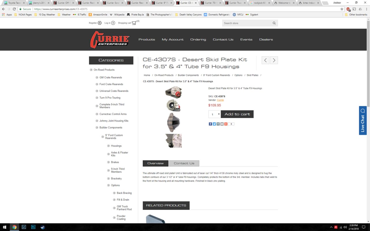

    tetten Cynical Twat Waffle
    Nov 2, 2014
    #141581
    2,513
    Andy
    Socal
    The_Black_Pearl likes this.
  11. Feb 14, 2018 at 2:40 PM
    #2371
    jberry813
    jberry813 [OP] Professional Fluffer Moderator
    Jan 21, 2011
    #49636
    28,488
    Jason
    Lake Tahoe
    2012 DCSB Sport
    ...too much shit to list.
    LOL. Yeah after you said something I went and looked and emailed my sales guy.
    tetten[QUOTED] likes this.

    tetten
    Nov 2, 2014
    #141581
    2,513
    Andy
    Socal
    Looks kinda janky, but would still add some protection on the front side for when you're crawling
    Jan 21, 2011
    #49636
    28,488
    Jason
    Lake Tahoe
    2012 DCSB Sport
    Yeah I'm not sold on the front part. I'm just gonna have the add the weld on skid to the main housing. Once I get the axle installed and everything set I'll see how things line up and decide if I'm going to do a pinion guard or not.
    I also asked them to leave one of the bottom studs out. I'm going to use a bolt instead and use that as my drain plug and that front part of the skid would be annoying.

    nDub
    nDub Kan kun være malet af en gal mand
    Feb 6, 2017
    #209802
    10,774
    Central Sierras - NorCal
    ‘17 TRD OR DCLB and a dǝǝſ
    Lead Free Gasoline
    I do the same thing on my older pickup. A quick tack weld on the drain plug will keep it from falling out too. I've seen that happen a few times.
