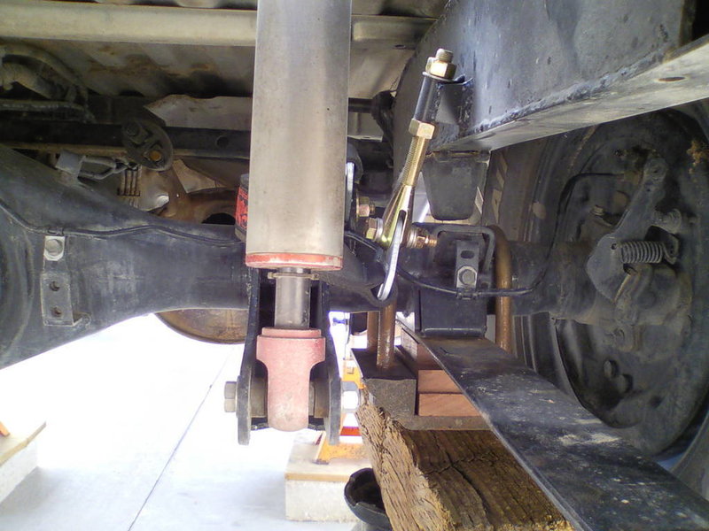

    Question I have always wondered, does the main leaf even bump exactly the same as a complete leaf pack? I doubt it does, not enough to matter but doubt its exact

    I know that part but I mean the shape of the leaf. When you compress a single leaf its not uniform and bends more in the center. The complete leaf pack makes it more of a uniform bend if that makes sense. Hard to see from my photo but it bends a little more right at the wood blocks. When the whole leaf pack is assembled its going to bend less dramatic in the center. Also axle rotation is not going to be exactly the same

    Mine didn't, and since I squeezed 2.5 hydro bumps in for fucks-n-giggles space is a premium and the Teflon pad was contacting the nuts for the ubolts. Good thing I made my bump mounts bolt on, made it easier to just removed them, chop them off and re-angle them.

    This is what I mean, very slight but if you are tight on space then I bet it can make a difference

    It appeared to me that having the whole pack in changed the angle of the shackles and put me off a little causing the interference. I would imagine 99% of people it wouldn't matter, just in niche goofball scenarios like mine

    It does not. You will get a bit of a wave in the shape of the main leaf with the full pack. I use a zip tie on the end of the shock shaft when setting bump to add a bit of tolerance.

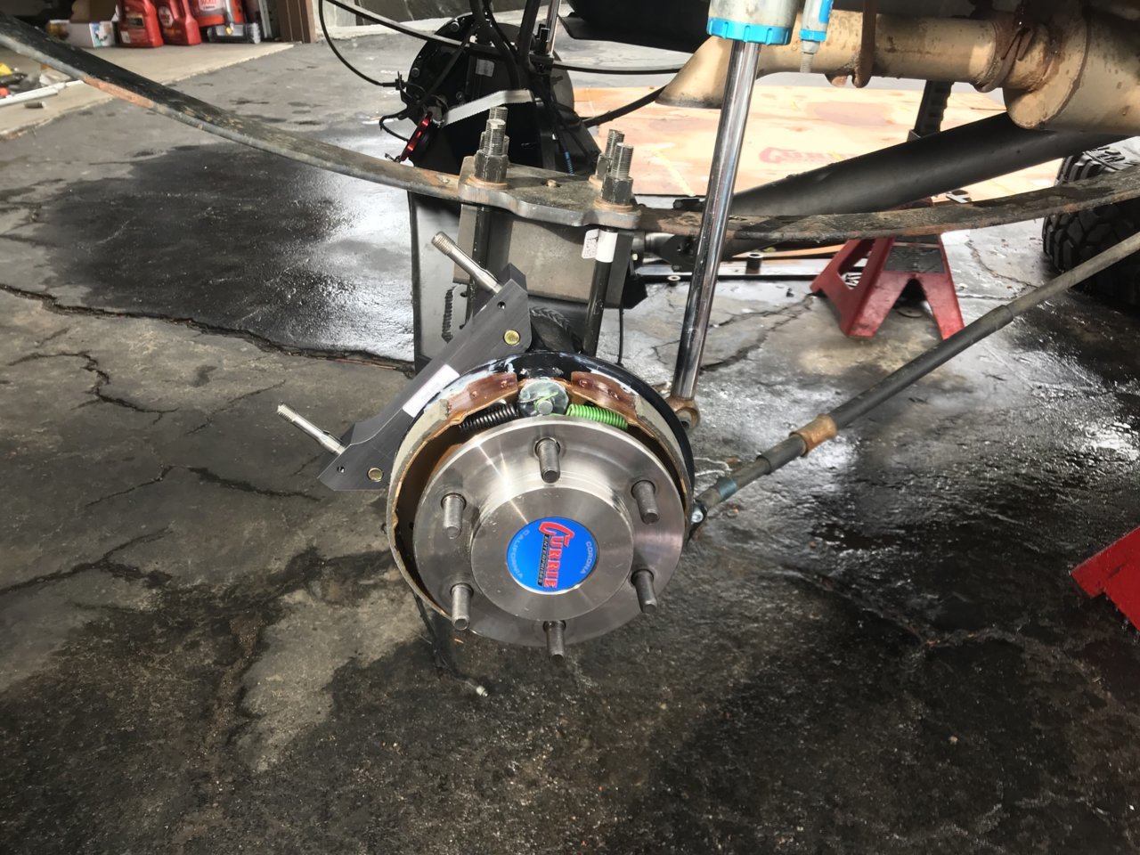

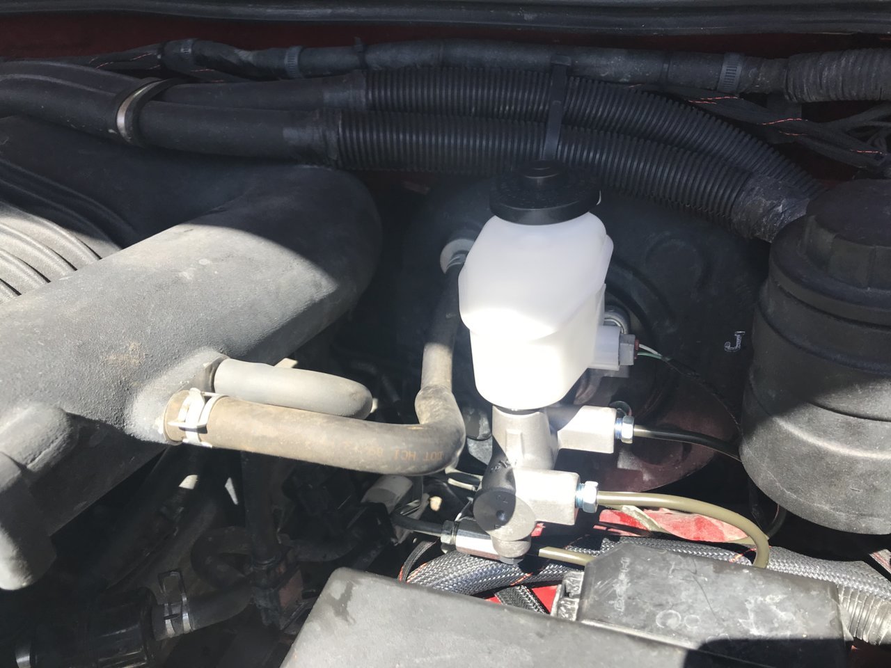

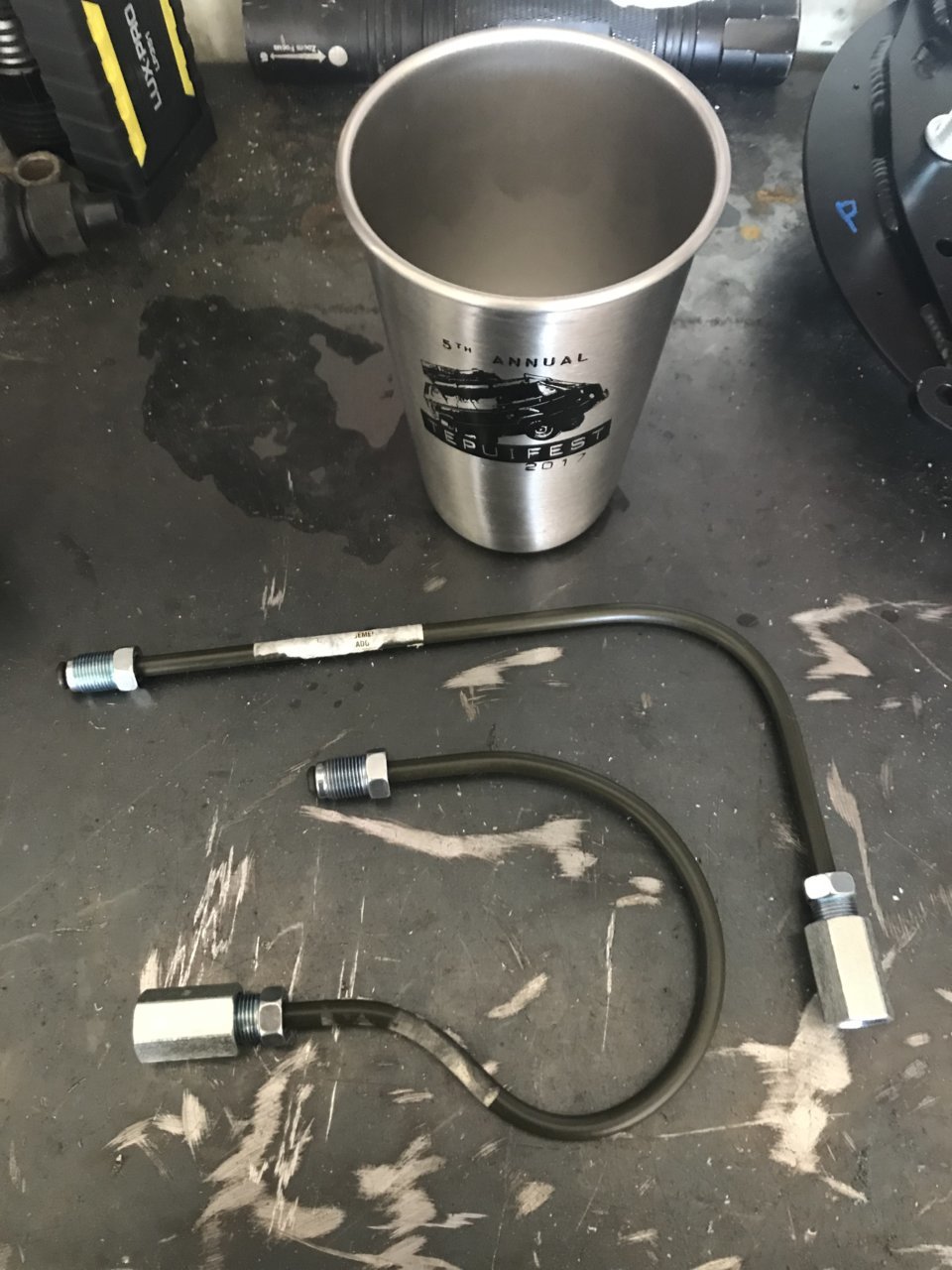

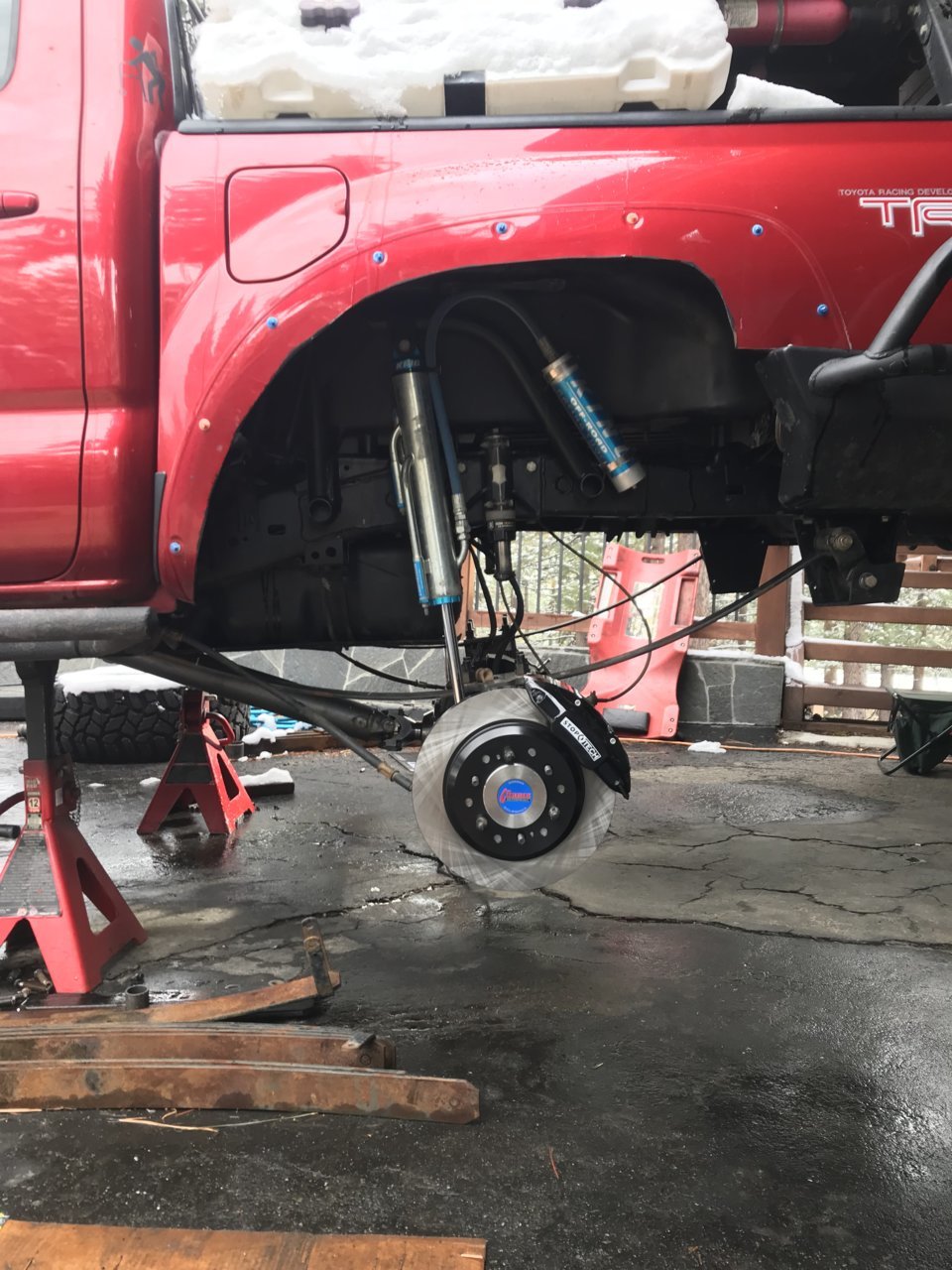

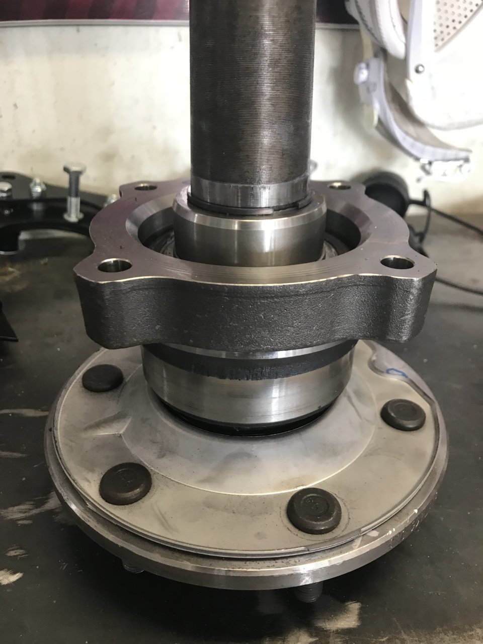

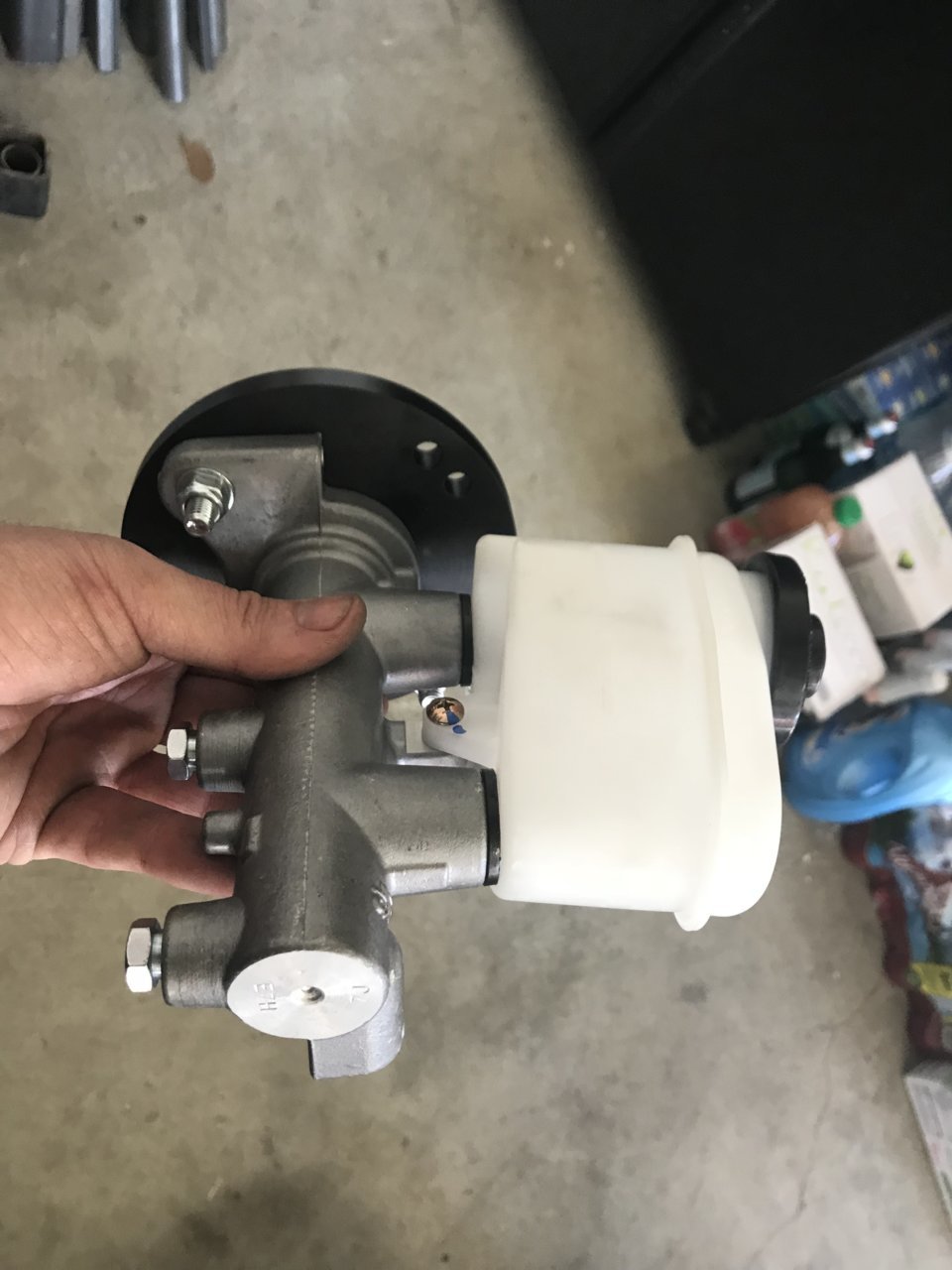

    Sequoia master cylinder installed. Didn’t have a brake line bending tool but it turns out the upper and lower edges of last years cup at Tepui Fest is the perfect size to make bends.
    I also pressed in the bearings and fully assembled the axles. E-brake shoes assembled. Calipers and rotors. Blah blah blah. Some shit crossed off the list. Far from done.

    https://www.tacomaworld.com/threads/airdogs-2012-prerunner-access-cab-slow-build.264263/
    Is that a custom adapter plate for the MC? Got a link for it if so. Also did you change out the booster ?
    Edit....looks like you used the SOS kit. Google is amazing!
