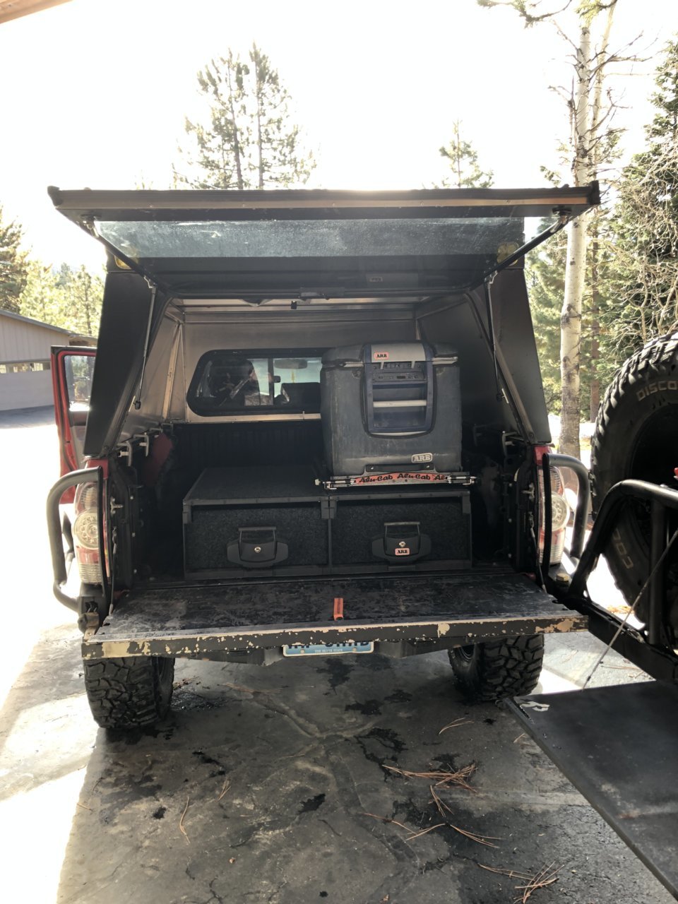

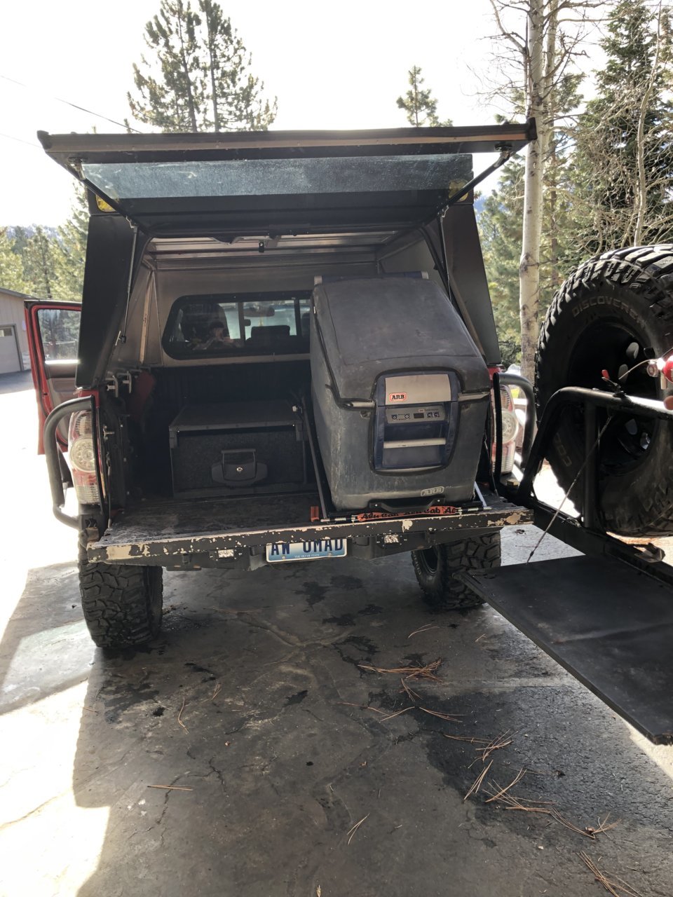

    Moved the ARB drawers from the trailer into the truck. And new Alu-Cab fridge slide.

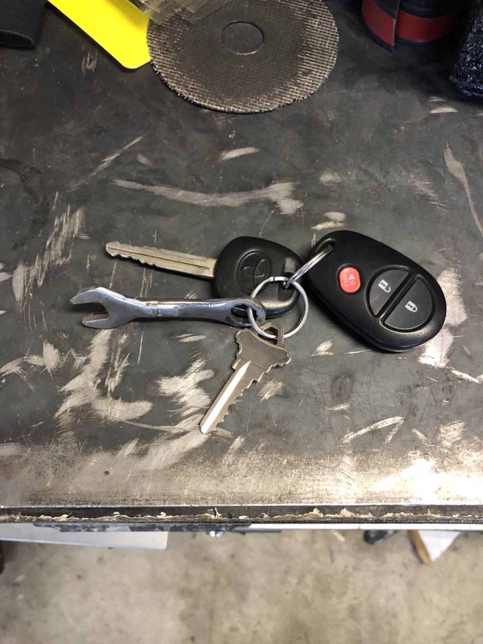

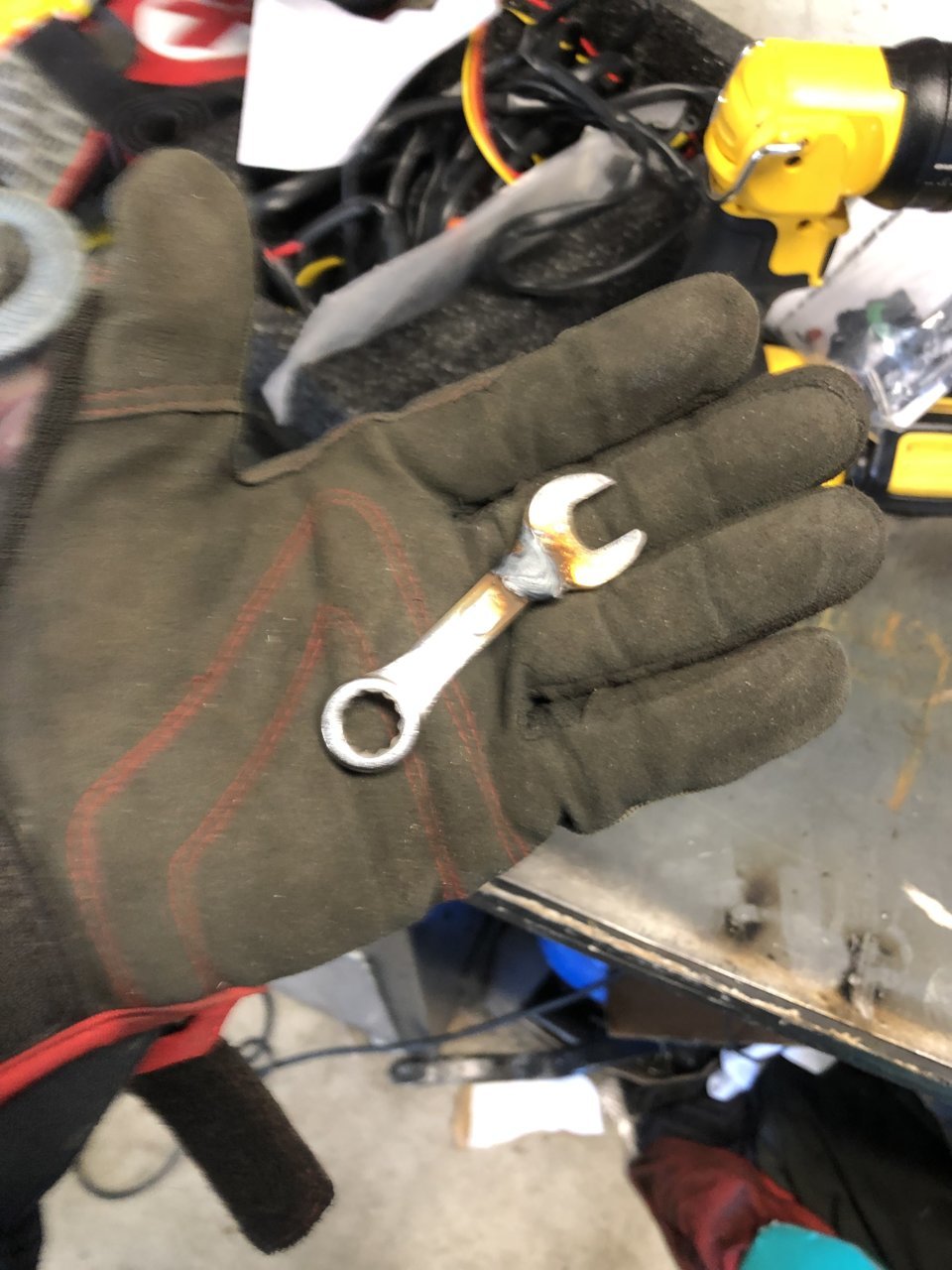

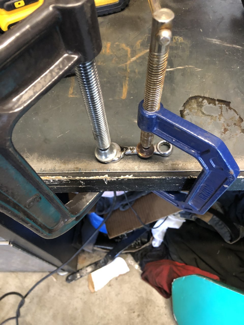

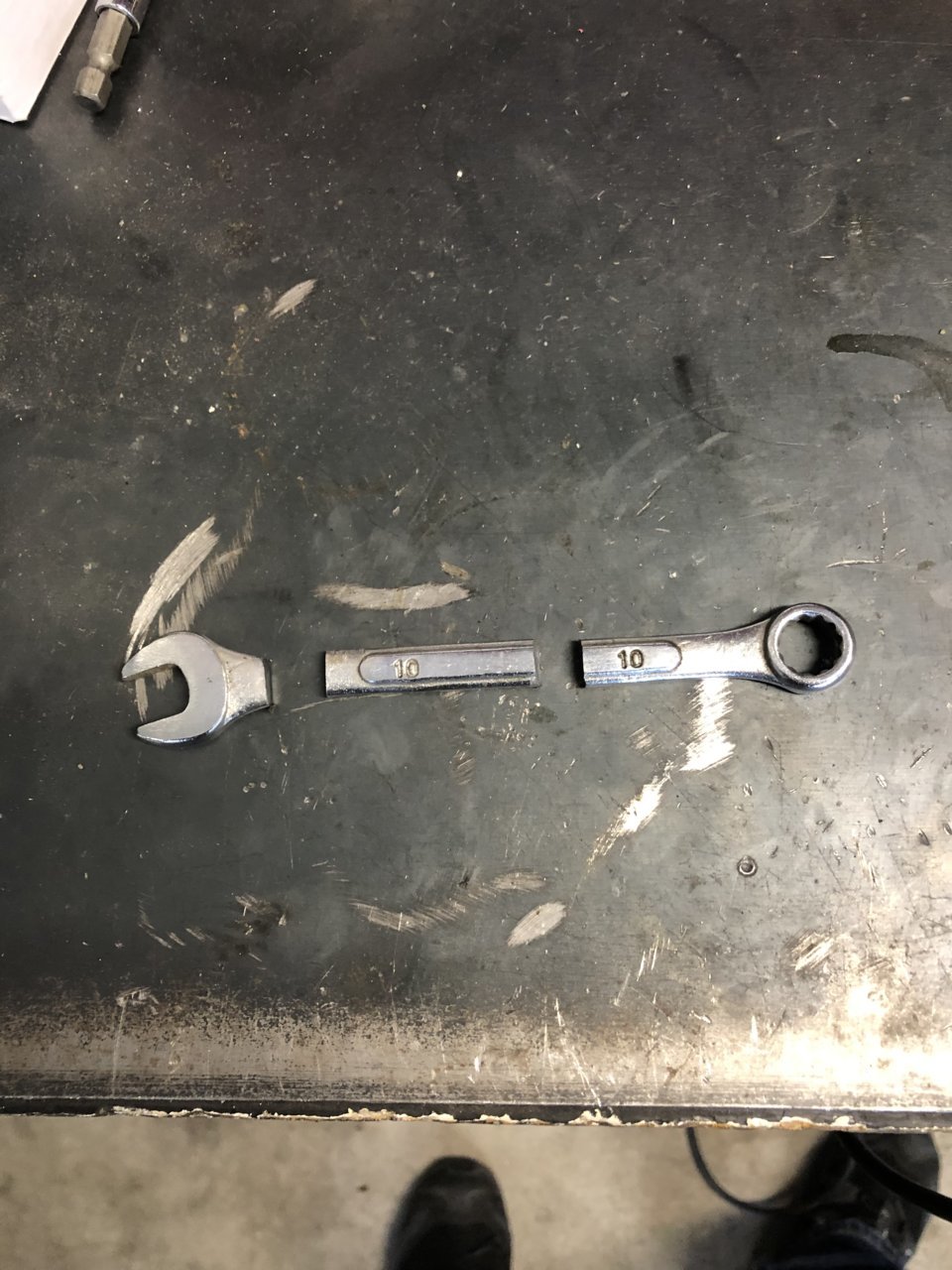

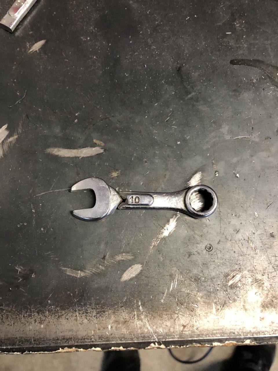

    Need a 10mm? No problem!
    Watch now I will lose my damn keys....

    Fuck me, that's a good idea.
