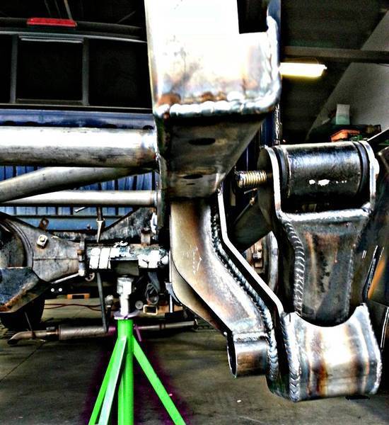

    I thought I had read somewhere in here about your plans for rear shackle hangers but can't seem to find it now. Are you going to keep a shackle flip type setup? Or remove those and go back to the stock inverted arrangement?

    I remember him saying stock inverted setup, plus a little reinforcing.
    Been waiting for him to take the plunge because I might copy

    I have similar plans thats why I was curious. I want to build a beefy hanger that matches stock dimensions but that I can tie into a new cross member when I cut out the stock one and box the frame in.

    He's going back to inverted, but ditching the crappy loaded bushing stock shackles and replacing them with some Poly bushed ones that we cut some pieces on my CNC table for. Stock length, but bye bye crappy bushings and a lot beefier plate/sleeve

    Yeah, I saw the shackles he was working on, they are nice! Are you helping him come up with a new rear hanger as well?

    I'm not positive what he's doing for hangers. I saw one he got from another member that was taken off a truck, but kinda beat/mangled. So he'll likely want to do some beefier plate ones that match factory measurements since the stock ones were not really usable.
    Next thing he's doing is the new rear shock hoops to stuff his new Kings in there

    Maybe we can do some collaboration. I want to get rid of my stock hangers with some beefy ones that keep the stock geometry.
    Basically create a set of hangers that are as beefy as the DMZ SUA setup and tie them into a crossmember like the pictures below, but keep them stock geometry.

    Hold out for a bit. New hangers will be in the works shortly :spy:
