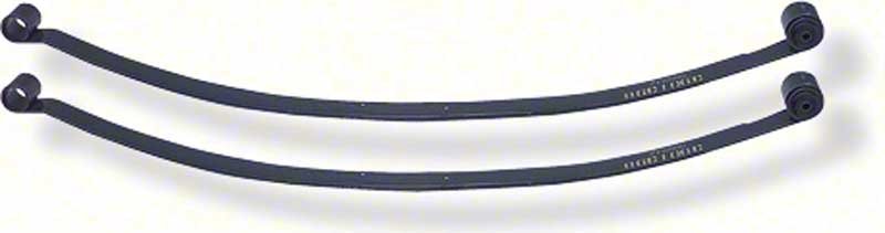

    I heard chebby 63" mono leaf packs offer the best of both worlds. Load capacity yet great in the whoops. Something to the effect of different spring rate metallurgy composition throughout all 63" of spring. Highly recommended! KIT_RL11.jpg

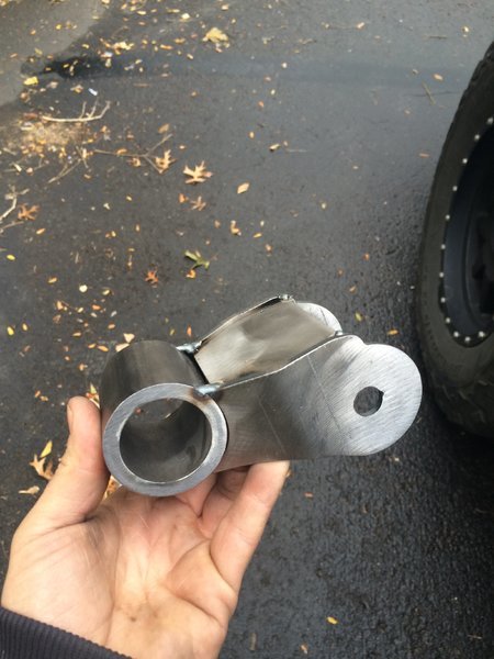

    What are the benefits of this over stock shackles? Looks pretty similar
  20. Jan 15, 2017 at 11:34 PM
    #800
    tetten
    tetten Cynical Twat Waffle
    Nov 2, 2014
    #141581
    2,513
    Andy
    Socal
    It's beefier, hangers are supposed to be 1/4" plate.
