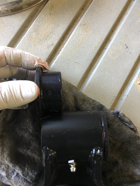

    Jerry, thanks for the details on the 4x shackles. I recently became aware of them a few weeks
    I had to unsubscribe this thing thing with all the people bashing, intentional or accidental. And let's not talk about the black dildos, and blowup dolls in the products discussed in this thread. Just post some manly random links to Amazon and that should get flushed out. Well at least it's worth a try.
    And I think perhaps your build threads should come with some kind of warning label. The So called Penguin build, you linked to, I'm reading your old post from 2012, where you were cycling the suspension, and I'm like okay, looks good... Continue scrolling down and then half naked women show up, as my wife is like 2' away! Haha close one!
    All that aside, I'm glad to speak suspension with you for a few if you'll be serious.
    Thanks for reviewing the 4x shackles. Too bad build quality isn't better. I don't think I'd have run them with the bushing that short. I don't suppose you measued ID of bushing before install? I have reviewed a few different vendors offerings and could possibly recommend an alternative. Anyways, I'm very close to installing my modified stock greasable shackles.
