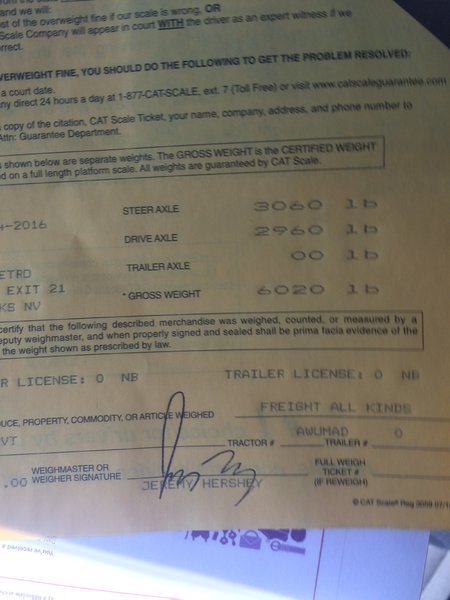

    Have you weighed the truck recently? sorry if I missed it, but was just wondering from the standpoint of GVW. I've seen how much of a "suspension snob" you are and so obviously weight plays a big part in that. but since the payload on the 2nd gen is pretty limited, to begin with, then add armor, the tent, etc, just wondered if you were above GVW or if you even cared about it. I read your stance on aftermarket brakes, and also have read that many people consider the 2nd gen to be underrated by Toyota, though not sure I agree, not that it can't handle it, just that it's a # for the lawyers, and not necessarily underrated.
    I'll be "building" a 2nd gen this summer and really wanna keep it as light as possible while still having proper trail protection.

    Yes:
    Brakes suck on this truck. Bad. That's the whole reason why I have the BBK now

    damn you're right your truck is a pig! I'm starting to think it's impossible to not be over GVW if it's built (especially with trail spares and camping gear)
