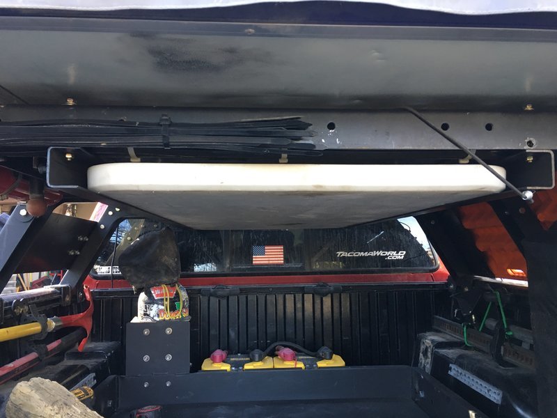

    Needed the room on the passenger side of the bed for other things. So whipped up a mount for the camp table on the @RelentlessFab bed rack. Cut some 2x3 rectangle tube in half to make c-channel. Worked perfectly!

    Pretty slick! How you gonna keep it secured in there?

    Didn't you see the bungee in the right corner?
