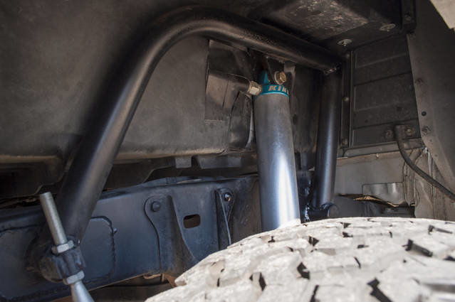

    Could you post a pic of your strap locations?

    I haven't done it yet. But here's a pretty picture of a similar setup with the clevis off the rear shock hoop.

    Just soo light seems like. With all the wieght back there and friction from the leaf bushings seems like a waste, never seen flutters in bypasses is all( all desert trucks and race cars tho). I know you know what your doin, just curious observation, mounts look sweet!!
