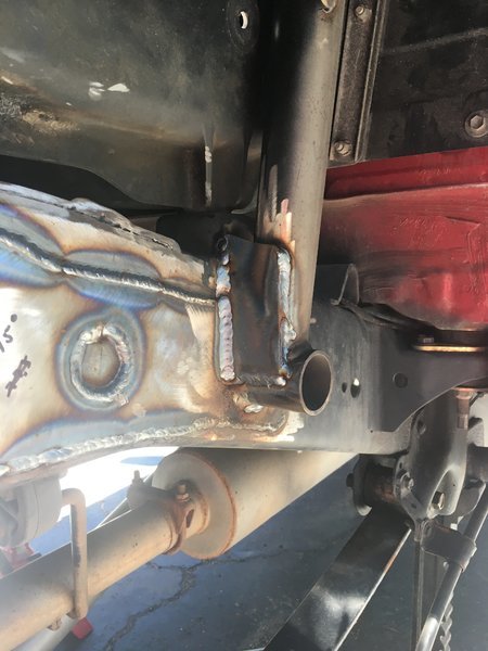

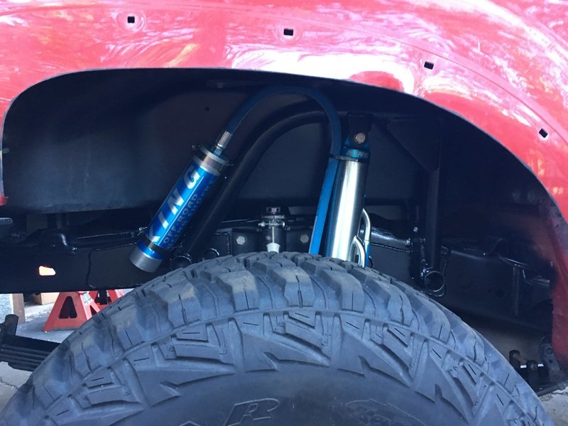

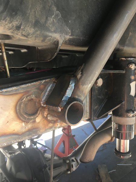

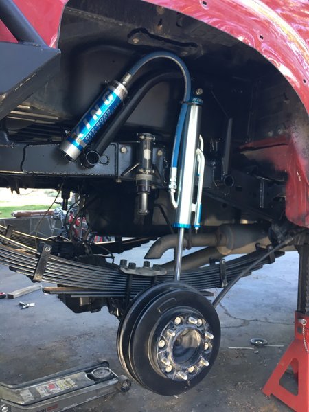

    Shock relocation done right.
    Had some time to finish it all up. Fully welded, gussets done, and all the little shit.
    Back on all four but ran out of time for a test drive. Should be able to tomorrow.

    Custom bypass zones?

    Bypass zones are standard. But I have a welded rod end (instead of threaded) so the lower shock mounts don't hang down past the axle. Also had the resi tubes clocked to tuck the tubes away from the tire when flexing. I've got just shy of 7/16" between the tire and one of the bypass tubes at full flex.

    @jberry813 do you remember how you valved the front kings? I will be running an almost identical setup

    10/10 in the coilover
    20/10 in the bypass

    10 comp, 10 rebound what about flutteR?

    No flutter. Bypasses for zone sensitive damping.
