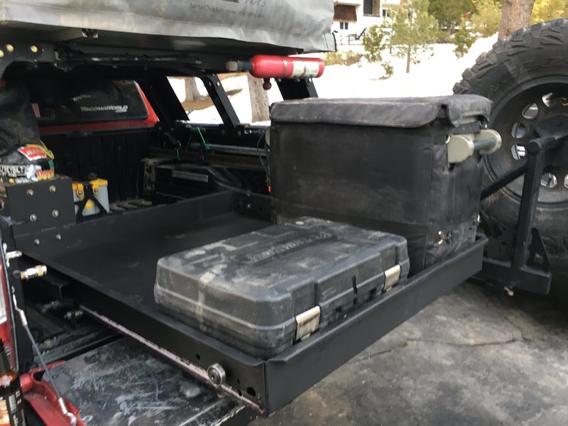

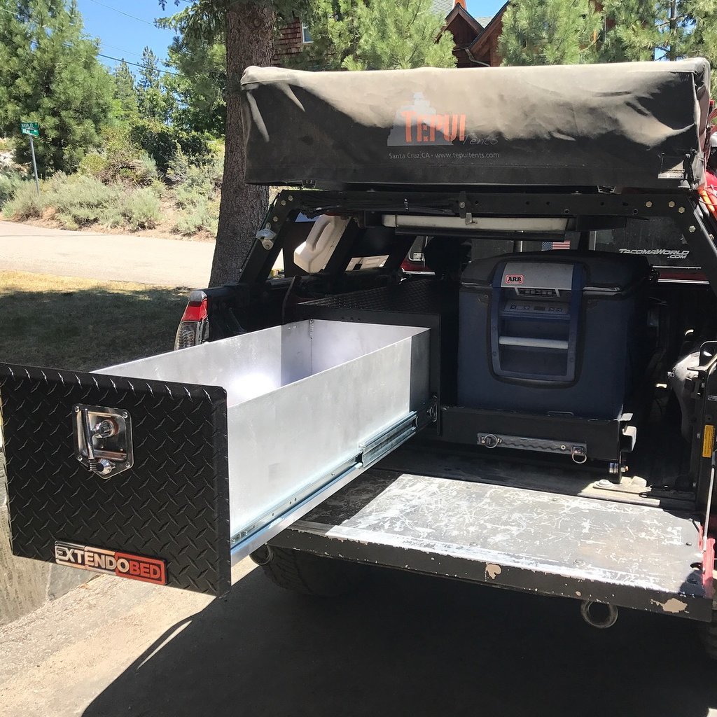

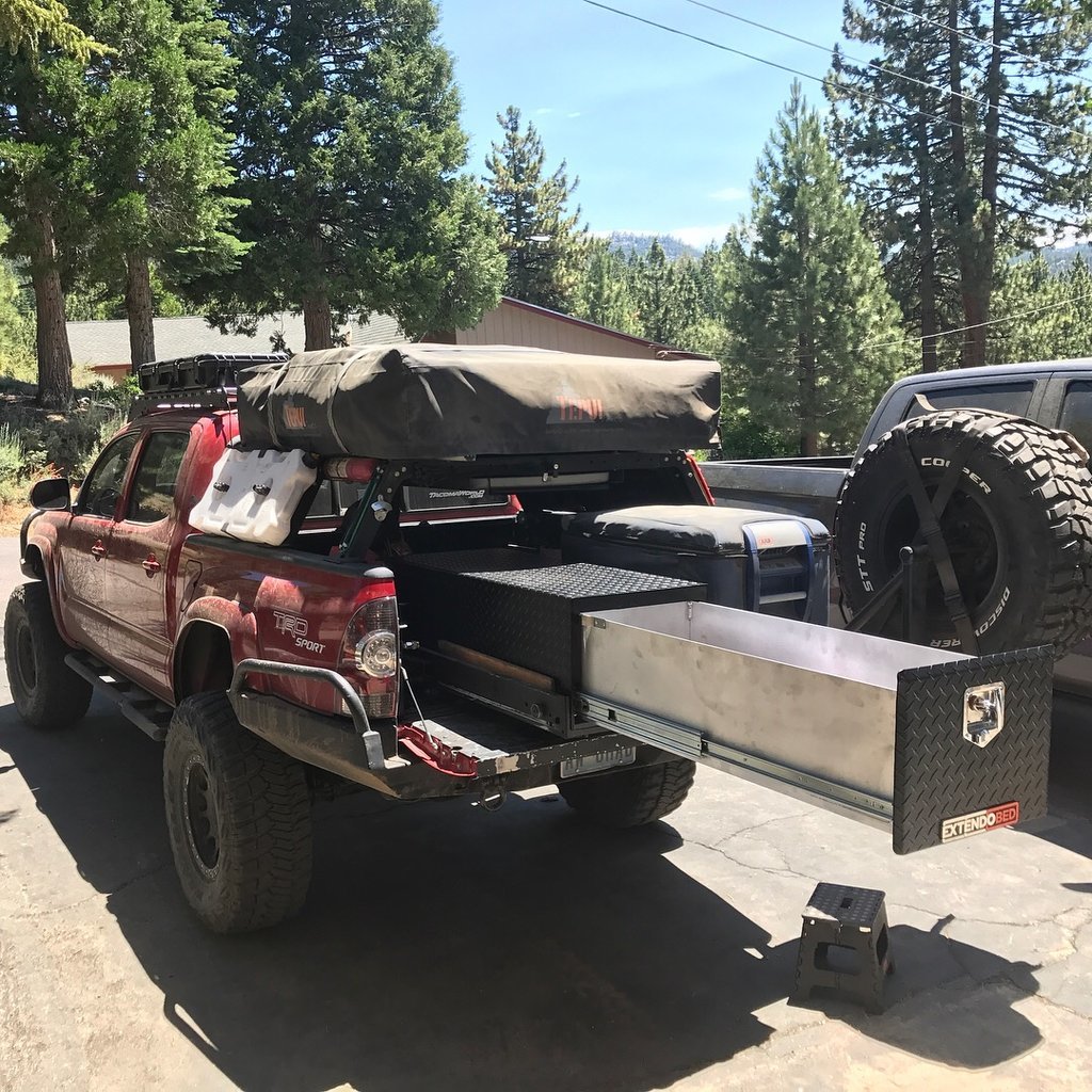

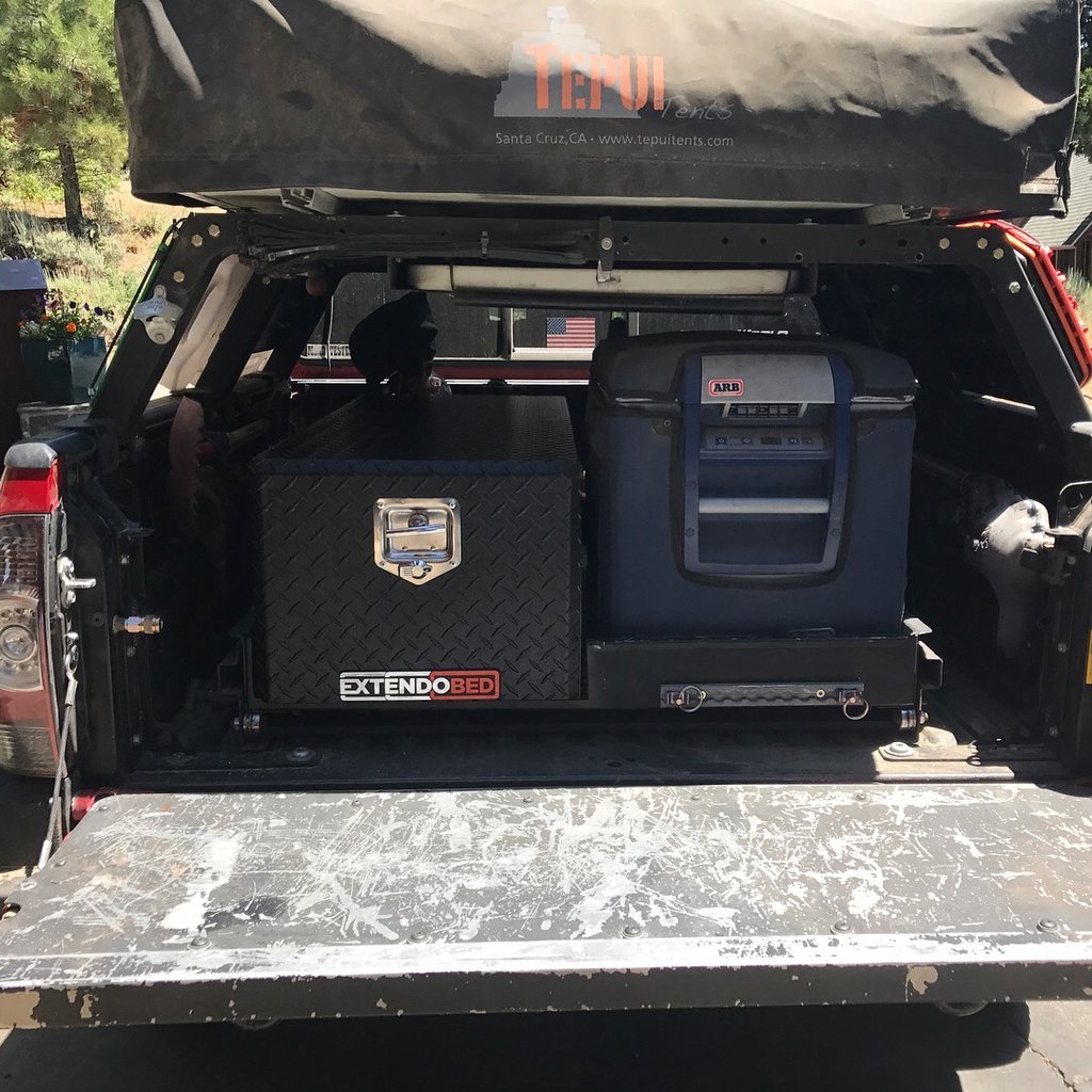

    Back to build stuff.
    I'm soooooooooo over the homedepot expo-warrior bins. Even organized, they are disorganized. No matter how I packed it, something was always in the wrong sport or I had to remove a bunch of things to get to what I needed. So I reached out to Extendobed to build me something that matched my dimensions and my requirements. I won't lie, it was a bit of a rocky start. But the guys over there really do pride themselves on customer service and made it right...and then some. It's a sealed aluminum drawer, the full depth of my bed slide, wide enough so that it still fits my fridge, and tall enough to fit all my shit and for camp chairs and firewood to fit on top with a pair of tie down tracks.

    The one benefit of those yellow tops is that it's easy to strap stuff to the top. Hard to do with Action Packers. Fit a buddy heater, camp stove, and Zodi shower in a yellow top this past weekend. Not bad for $8.
    Also have 4 Frontrunner Wolfpacks and 4 Cubpacks tho... :anonymous:

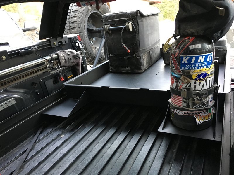

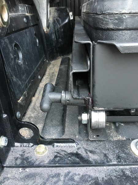

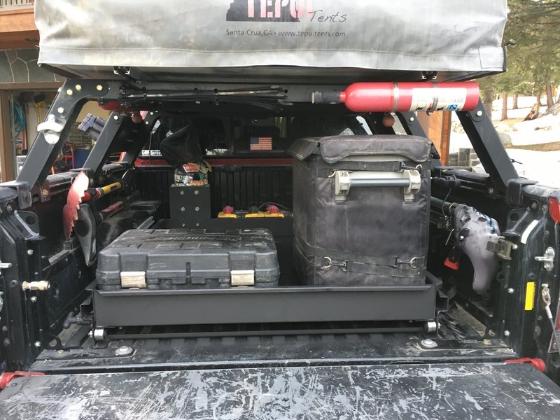

    Took me forever to find this post...lol. Really digging this setup, and wanting to do it but for a 6ft bed. Question, what did you use to secure the slide to the bed? Rivet nuts?

    Rivnuts will break in a plastic bed. I have 6 bolts. Three go though the frame. The other three have sammich plates on the bottom of the bed.

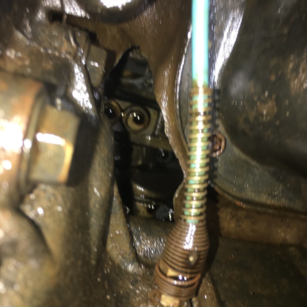

    Busy fixing broken shit. After this weekend I need a patch that says "stupid hurts" instead.

    What broke now?

    Nothing to see here. Move along.

    Motherfucker is staring out of the motor at you!
