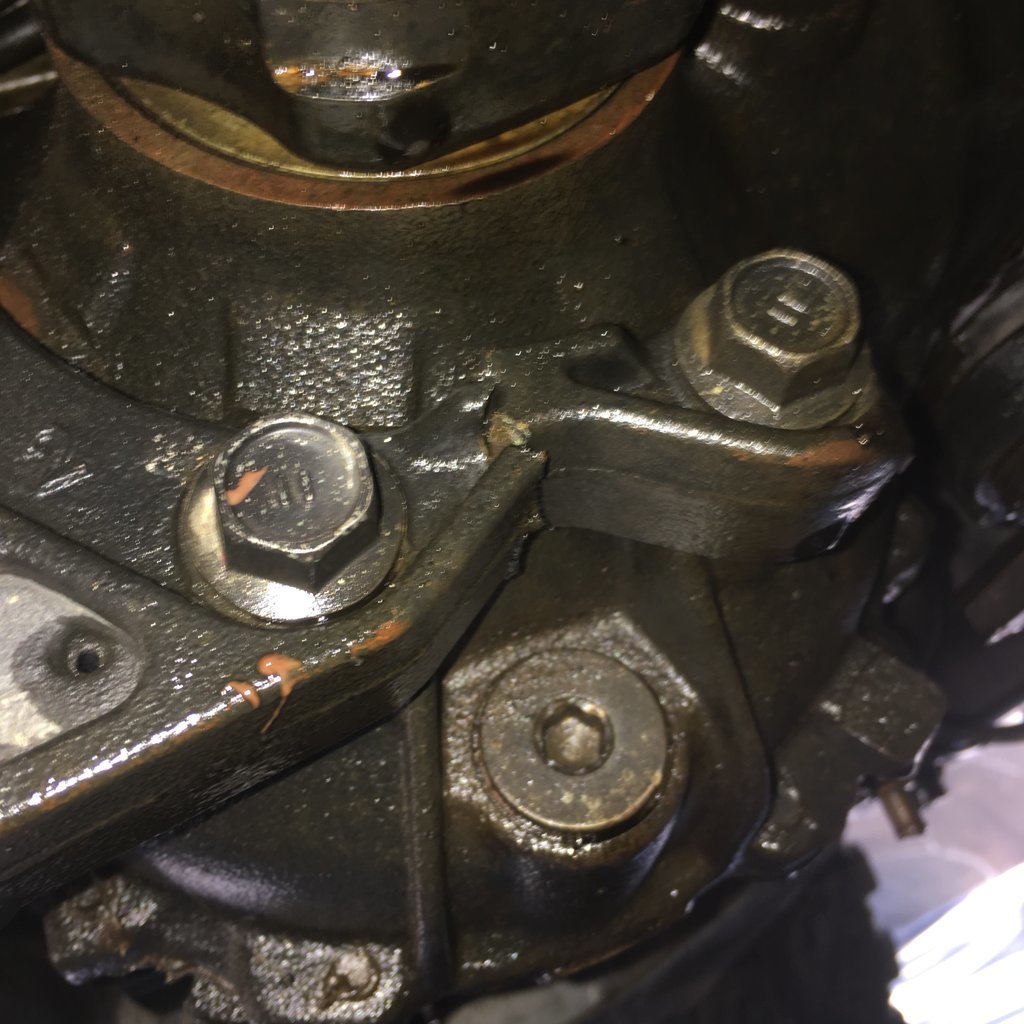

  10. Jul 18, 2017 at 8:33 PM
    #1870
    jberry813
    jberry813 [OP] Professional Fluffer Moderator
    Jan 21, 2011
    #49636
    28,478
    Jason
    Lake Tahoe
    2012 DCSB Sport
    ...too much shit to list.
    Good times!

  11. Jul 18, 2017 at 8:35 PM
    #1871
    Gramps
    Gramps My walker is faster than your Prius!
    Feb 7, 2011
    #50695
    14,327
    Gramps
    Colorado! Where else?
    07 TRD DC 4x4
    A small handful of select mods.
    What the actual FUCK caused this?
    ChandlerDOOM likes this.
  12. Jul 18, 2017 at 8:35 PM
    #1872
    ChandlerDOOM
    ChandlerDOOM International tent trafficker
    Nov 4, 2013
    #115943
    3,838
    Chandler
    STL
    Truck
    37s yo
    Wait, did you smack your skid plate so hard that it cracked the diff mount bracket?

  15. Jul 18, 2017 at 8:37 PM
    #1875
    jberry813
    Jan 21, 2011
    #49636
    28,478
    Jason
    Lake Tahoe
    2012 DCSB Sport
    Nope. For once I actually wasn't driving like an asshole. The Upper left bolt worked its way out. Rotational torque under load broke the bracket with just the two bolts left and the diff hit the pan. The rest was history.
  16. Jul 18, 2017 at 8:38 PM
    #1876
    jberry813
    Jan 21, 2011
    #49636
    28,478
    Jason
    Lake Tahoe
    2012 DCSB Sport
    That was a separate incident...30 minutes prior. Swapped that out and shit went downhill fast.

  18. Jul 18, 2017 at 8:45 PM
    #1878
    ChandlerDOOM
    Nov 4, 2013
    #115943
    3,838
    Chandler
    STL
    Truck
    37s yo
    I think it was the road up to racetrack in death valley that did it for me, fuck that road. I never would have thought those bolts would back out but I guess they see a lot of abuse
  19. Jul 18, 2017 at 8:47 PM
    #1879
    scocar
    scocar hypotenoper
    Nov 11, 2009
    #25814
    40,027
    That does not look like an engineered hole.
    LTDSC, Overlanerd and Bentrodder like this.
