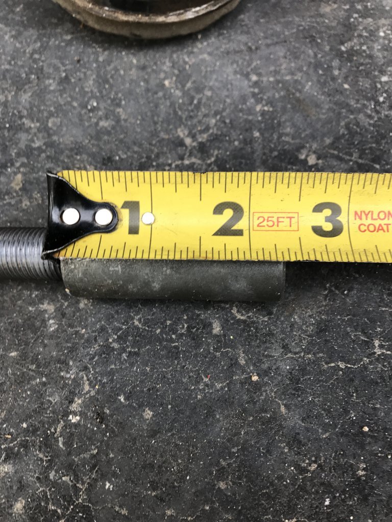

    Just pulled the Tierod end and extension... Unfortunately not going to be able to just cut the extension down like I had hoped because the threads don't go all the way through.... You guys happen to know of any shops around here that would have the right equipment to tap these threads deeper? Or better yet anywhere that would carry some tie rod extensions?

    I think Sam at Samco Fab has a lathe.

    Will look into them thank you... Im thinking im probably going to have to call total chaos tomorrow and just order them but if there are local options I would definitely like to get it on the road ASAP

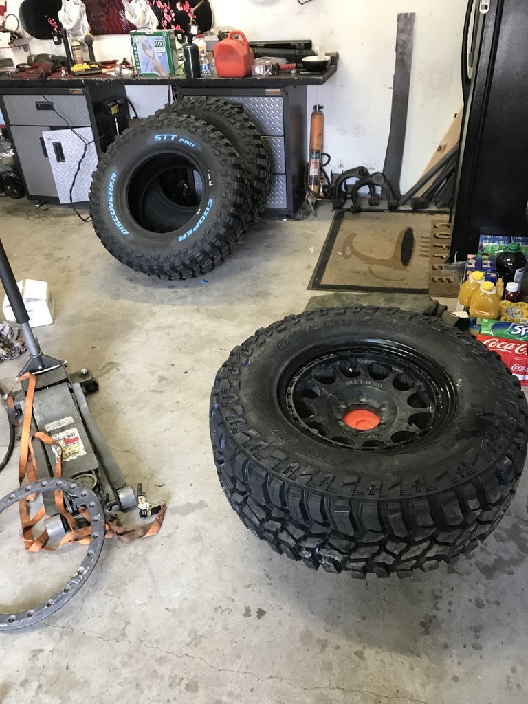

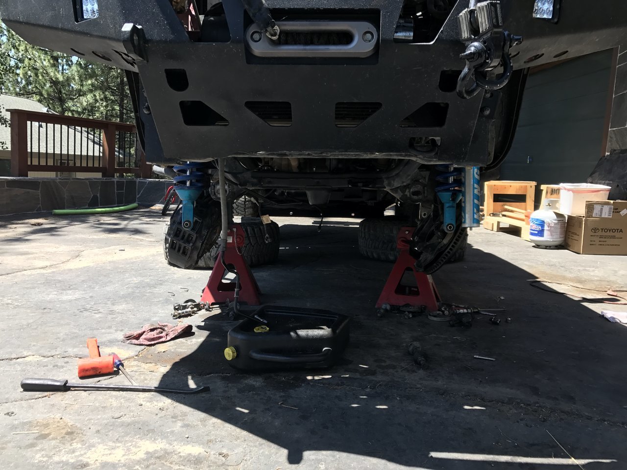

    Pressed in 4 brand new uniballs all the way around. Uppers had very minimal play but the lowers were spent. At least 2 mil of movement in them. Pulled the old rack and prepped the new one. New outer TRE's as well. Upper and lower oil pans removed and everything prepped. Removed the MTRs and mounted 4 new Cooper STT Pros on the beadlocks. Front diff is ready to go again with new mounts (thanks again for the rear mount @glorifiedwelder)!!! Might have a mixture of metric and SAE bolts now on the driver side arm, but those fuckers are not coming loose again. Also got a gently used factory CV from @Overlanerd with an absolutely prestine inner. Haven't done the work yet, but it looks like it will be all I need to rebuild the CV I popped. All in all a good days work and glad to be home.

    How were the coopers to mount to the beadlock wheels? Frick I would love a set of beadlocks. Great thread btw, lots of useful info!

    They weren't bad at all. There's one part I needed my wife's help with, and that's getting the back bead over the beadlock. I don't weight enough to do it by myself. :anonymous:
    Other than that it's just being meticulous with the torquing pattern.
