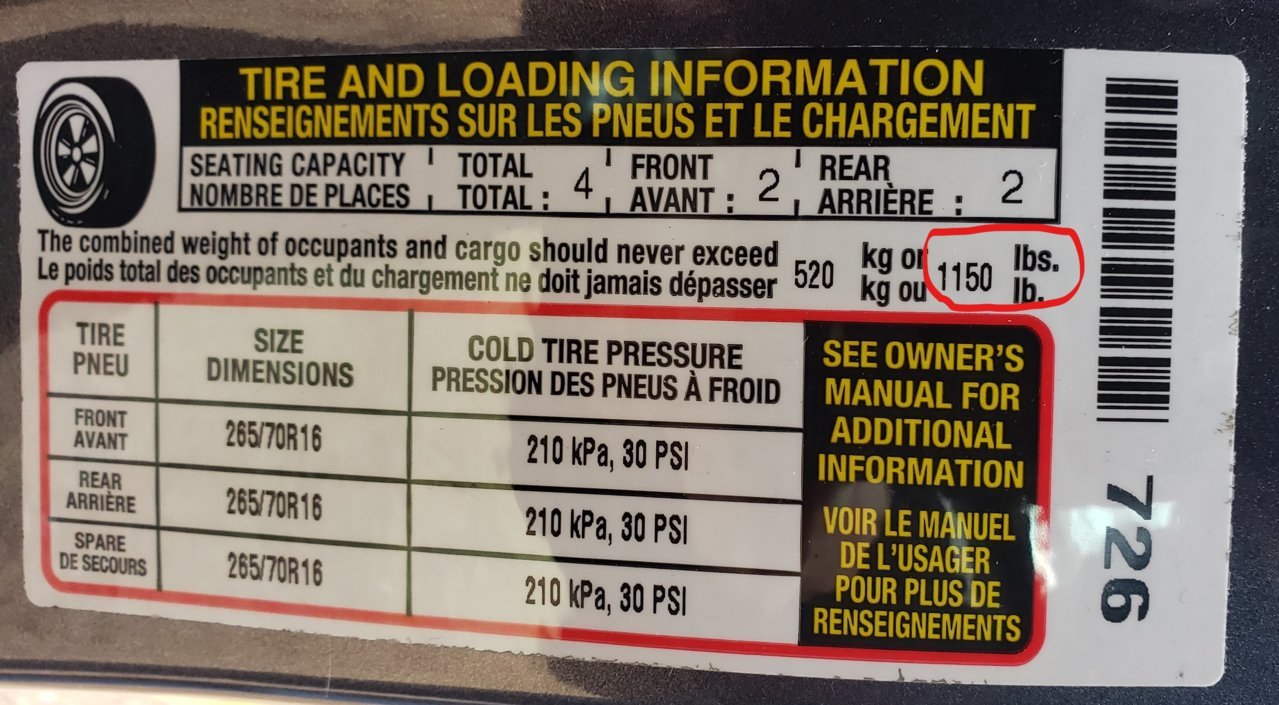

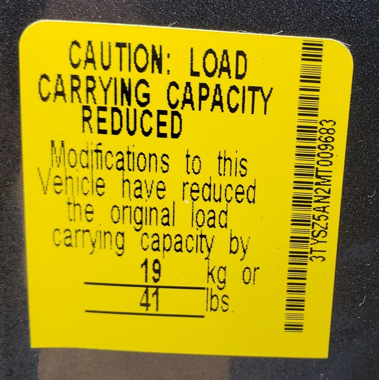

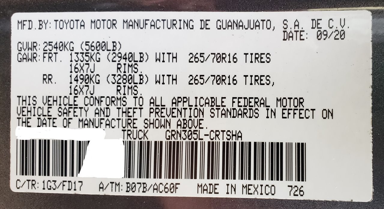

    These are the 3 jamb stickers on my '21 TRD OR AC (net payload is a bit over 1100 lbs):

    Thanks for posting the info! It's quite a bit less than the quoted number. Do you have a lot of options? My SR5 DCLB's payload number is only 960 I think which is also quite a bit less than Toyota's number on their chart and it doesn't really have much in the way of optional equipment.

    As @shakerhood says, the DCLB has the least capacity 'cuz it's got more built-in weight.
    My '21 TRD OR AC has a slightly reduced capacity because it's a 4x4. Minimal options of any significant weight. I think the 41 lb reduction is from the bed mat + TRD Performance Exhaust. Don't much care about the minor reduction - more concerned about towing capacity and GCVW.

    It does and it doesn't. The total trailer weight counts against the total GCVWR. The tongue weight counts against your payload rating which is part of the GVWR of 5600lbs. In theory you could run out of payload/GVWR before reaching maximum trailer weight and GCVWR. For example, a 5500lb trailer with 15% tongue weight would max out the trucks payload (825lb on the tongue plus a 170lb driver) but not max out the trailer weight or GCVWR.
