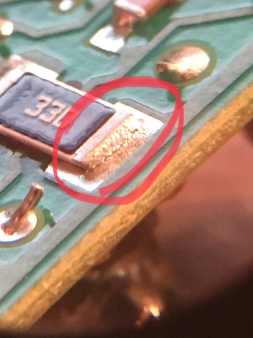

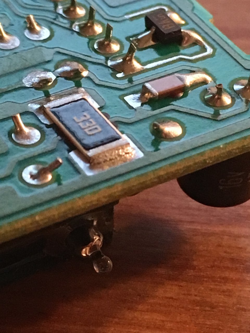

    Thought I'd post an FYI on fixing the OEM clock that doesn't involve a sketchy oven solder reflow. After tons of research, I found someone in a camery forum talking about a cracked solder connection on a resistor. It was super difficult to spot, even with a magnifying glass, but I noticed a hairline crack as seen in the attached photo. Added a little extra solder and after 6 years, the OEM clock was back in business. Hope it helps someone else on here.

    Good find, a small crack, .001, is as good as a mile crack.

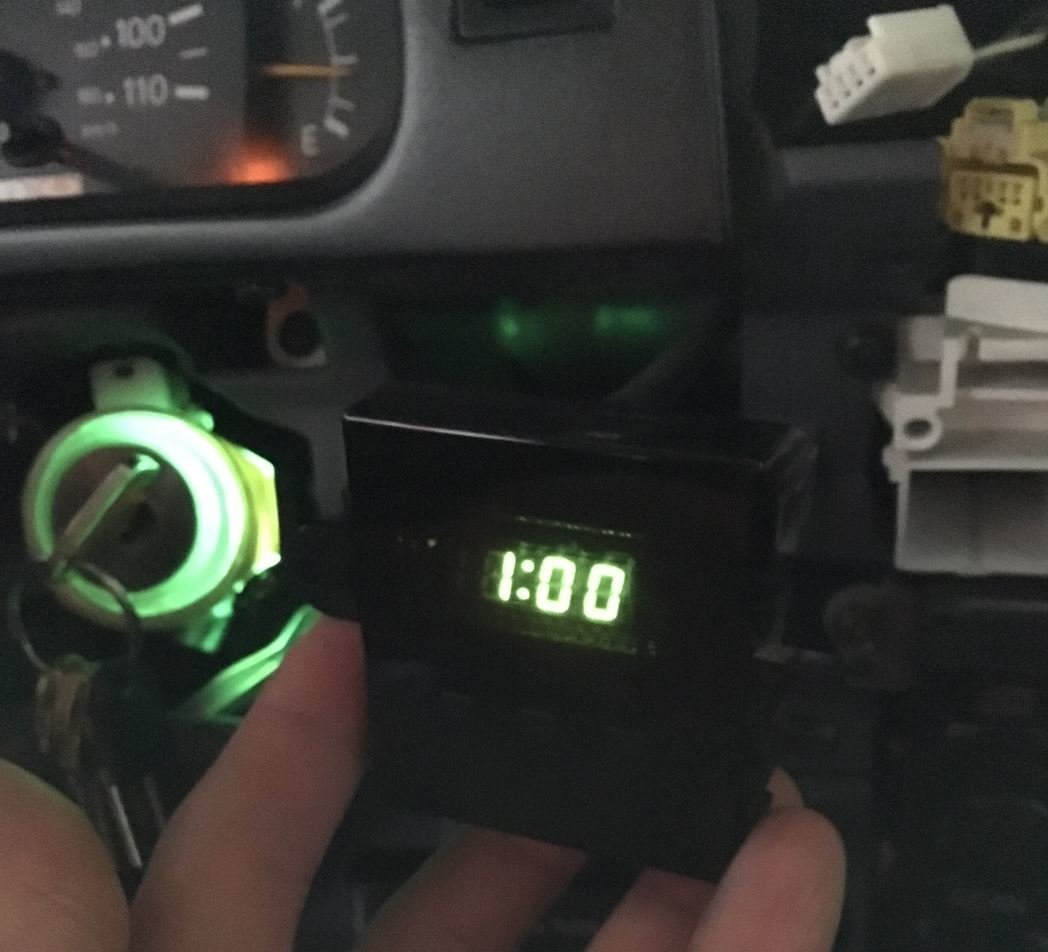

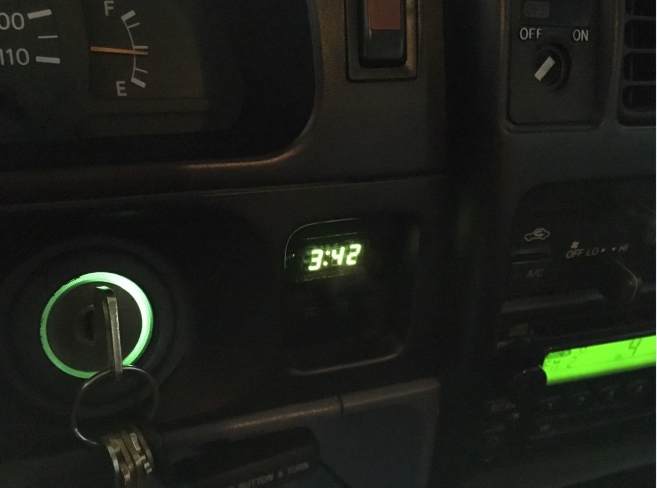

    I just wanted to contribute to this thread, and also to say thanks to the OP for sharing this information. After reading this thread, I was motivated to take my clock apart (has never worked since I bought the truck) and re-melt the solder joints on those big resistors. It took only a second or two on each connection with my soldering iron.
    I couldn't see any cracks in the solder, even with the aid of a magnifying glass, but I felt it was worth the shot to "re-wet" the connections just to see what happens.
    It works! Awesome! :taco:
