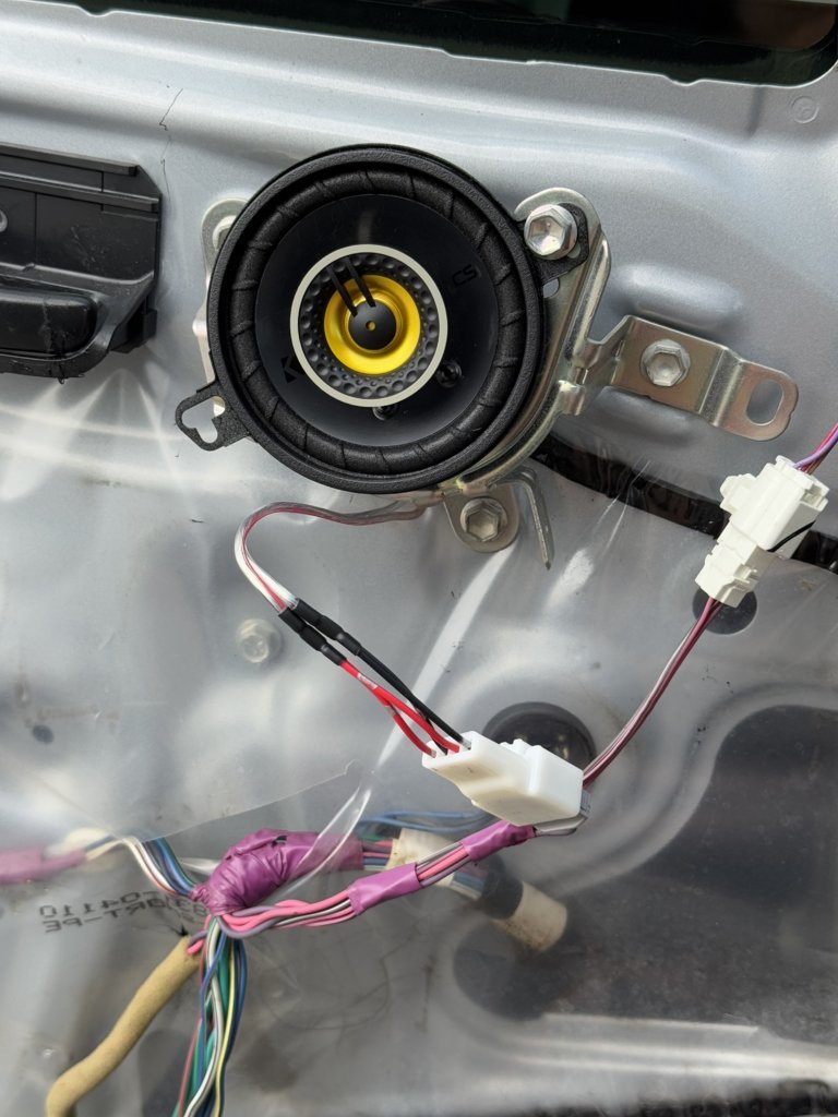

    So, naturally, being the forward-thinking person I am I just bought a 4 pin to the audio (pictured to the appropriate connector besides the 6 pin adapter). See below:

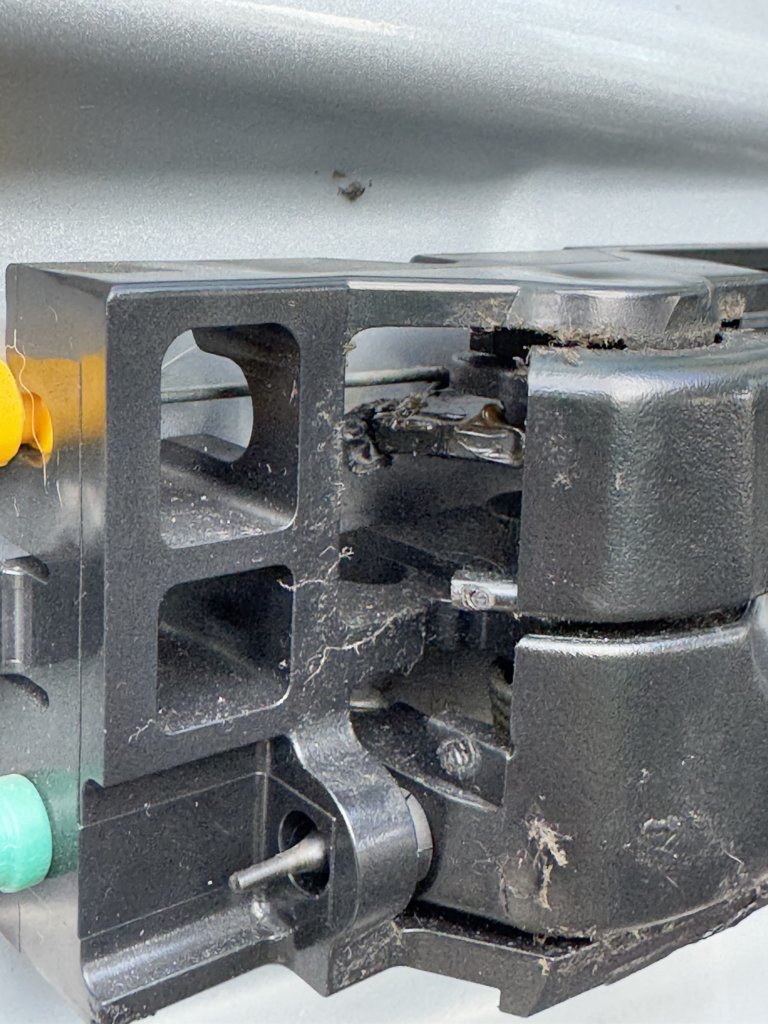

    Apologies—whether changing the pin and pin adapter from the original tweeter connection that connects other parts of the door would result in the key not opening the door.
    Also, whether that broken door handle part would cause that if you’ve got any knowledge there

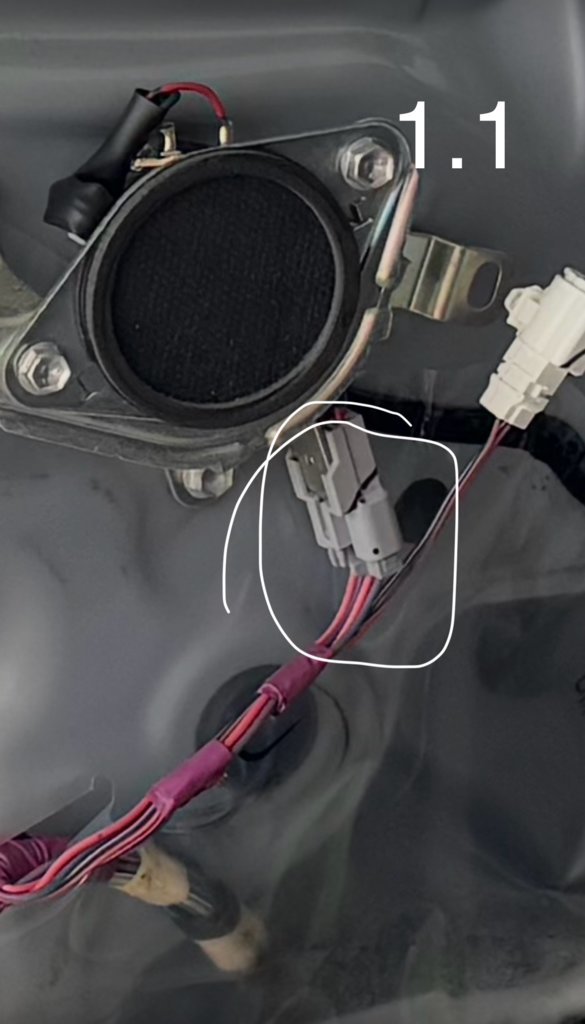

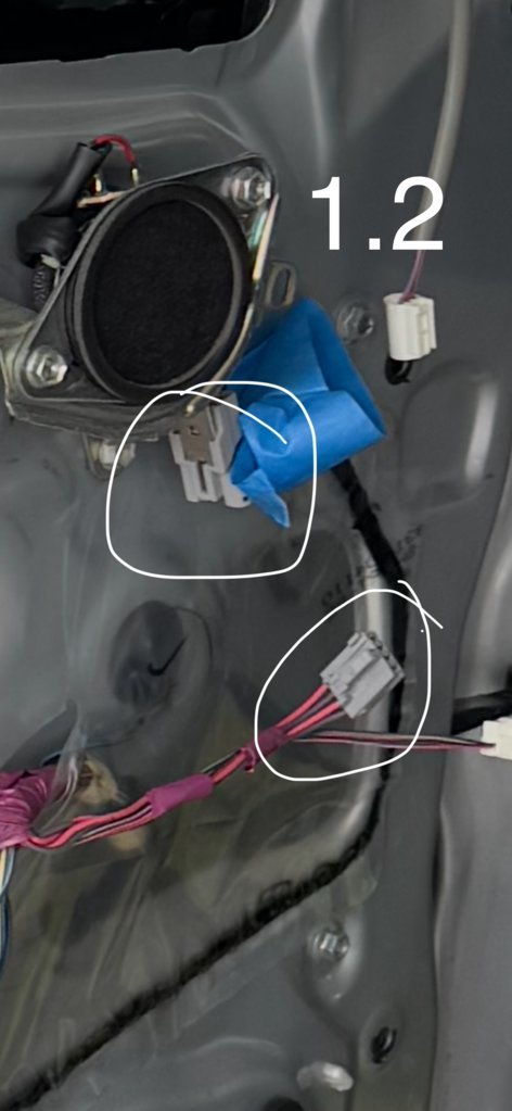

    Here’s something more illustrative.. So 1.1/1.2 were previous state and you can see the 4 pin goes into this 6 pin at the tweeter (sounds like a lot more than a tweeter needs?). 2 is where I just nuked the 6 pin adapter and tweeter and new tweeter direct the the 4 pin.

    So you can't open the door with the physical key?

    Correct but handles work fine and the fob does as well for all doors.

    I mean that has nothing to do with the speaker wiring, need to check the linkage that goes from the key cylinder to the door latch.

    I would’ve assumed as much too.
    I have overlooked the other lock rod clip location in each door it seems.
    Thanks for the input!
